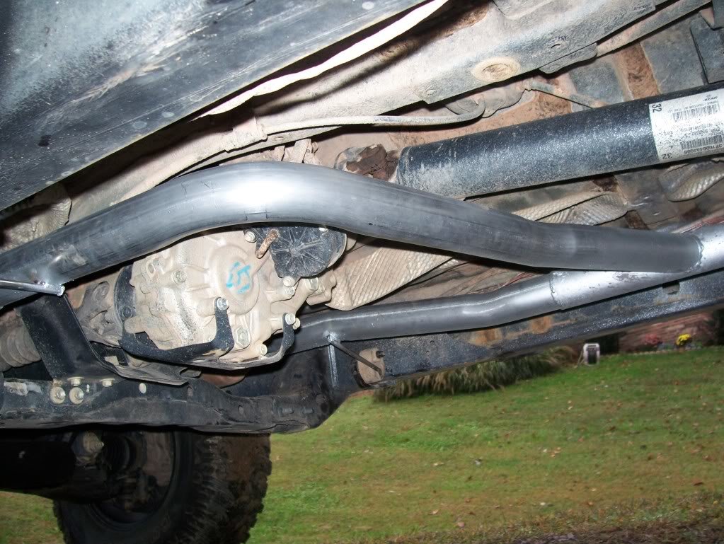

    Like this?

    thats what i need to do even with the spacer the skid still touches the pipe

    It ran me about 160 it would have been less but it took the welder a little longer to get everything tight.

    Your guy did a really good job on that.:thumbsup: Thanks for the pic.

    Might want to lookin into doin the exhaust crossover if it keeps up with it
    I got it done at a local shop were I get all my exhaust work done

    It wasnt solid it looped into the rubber mount there, Just looks like its solid in the pic.
