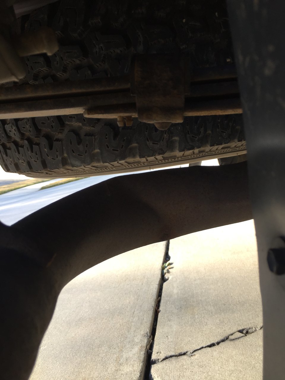

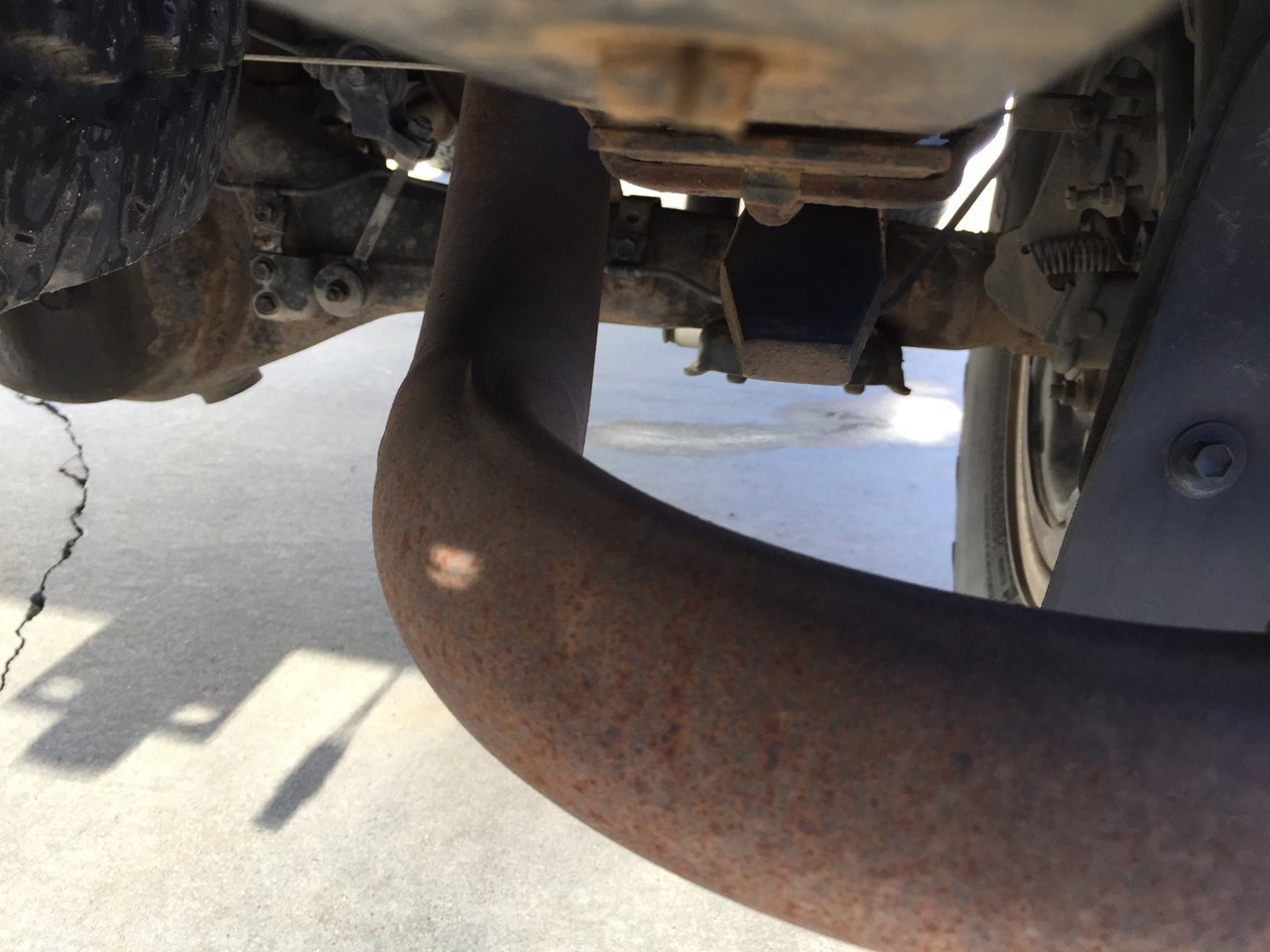

    I've run into two problems on my 98 Tacoma, I've had it for 3 months and just noticed these things.
    1. The exhaust at the end is bent and to my non-mechanic eyes it looks like it could restrict the exhaust flow a moderate amount. I'm pretty sure that's something that needs to be fixed. Does it need to be fixed? If so could I do it at home?

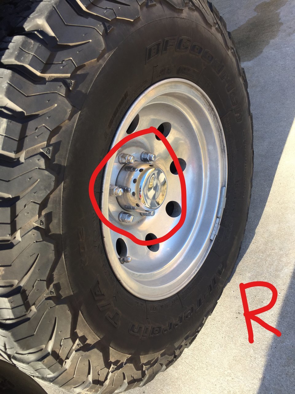

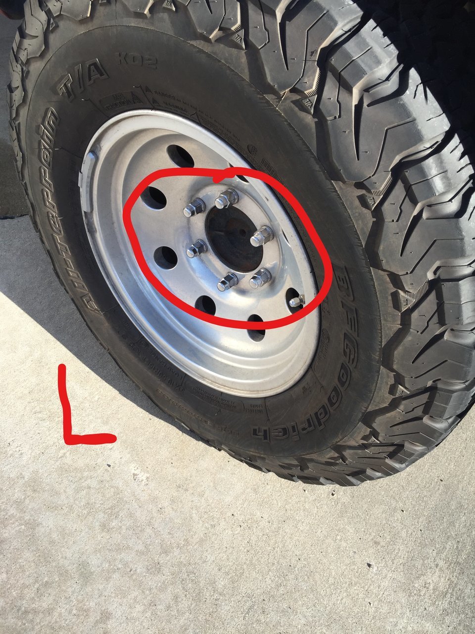

    2. The right rear wheel looks like it has a hub seal thing while the right left doesn't. I've noticed the right side tire sticks out just under and inch further than the left side tire. What should I do about it?

    How big is your spare tire?
    If 31inches and over, the exhaust has to be bent to make it fit under there. Or else the tire touches it and it is no good
    the thing on your wheel, it's just a decorative chromed steel cap.

    Thanks for the info. The spare is 31'

    That bend wont restrict flow enough to worry about. Like less than 1/2hp at high rpms. So if its an eye sore, go for it, but it wont affect power or mileage.
    The wheel is missing the center cap. Buy another cap, or remove the one you have.
