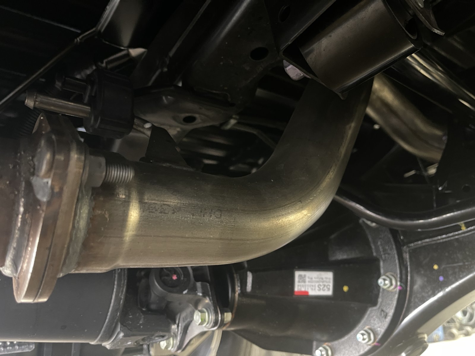

    Once we make-up our minds that we want that mod, muffler shop can cut the pipe off the existing flange that youre going to "remove" & weld & mandrel bend exhaust pipe to it & throw an exhaust hanger on it, $75 & done....
    I believe theres all sorts of premade mandrel bent pipes.
    This mod isnt to gain any real performance, its just to ditch the pipe out the back....
    If we gain .5 hp by doing so, ooougggghhhhh booooyyyyy!
    wont be as pretty but soooooo what....
    Im not saying this pipe as I havent measured but, something similar, just pointing out the $250, theyre on crack.....
    & you are too if youre think you have to have that NYTOP pipe!
    Legit custom fab muffler / exhaust shops probably already have something on the shelf...
    Been working on exhaust & engines for 35 years...

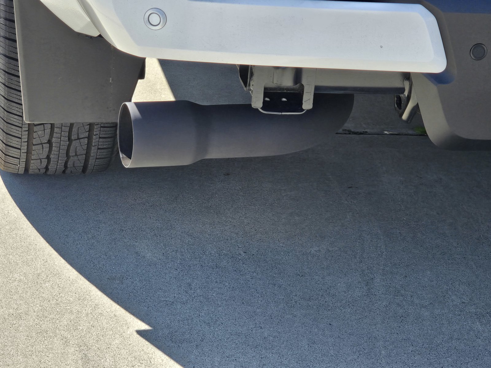

    Just measured the tip on my SR5 because its really ugly and it's 3 3/4" for 4" in and none of the aftermarket tips are that big... aaargh! Toyota wants $112. for the black chrome tip, which is on B/O of course. I guess everything we want is going to be stupid expensive until the aftermarket people get producing for us. I may paint it like Tacowrench did. Its better than seeing that naked pipe.

    Thanks for the idea. High temp paint is the only mod available for the gen 4.

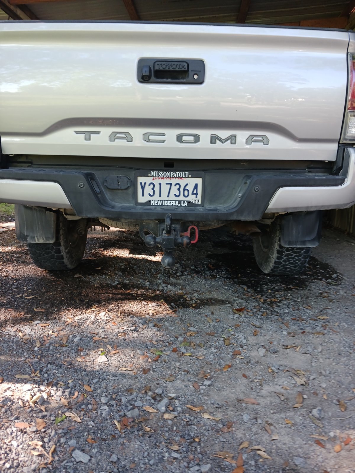

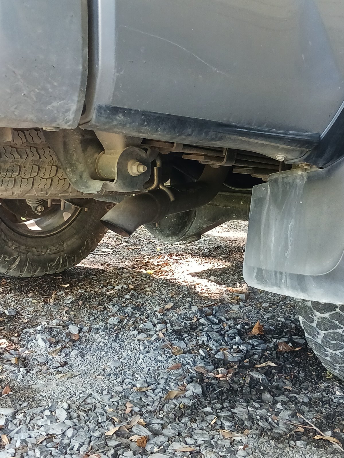

    17137371849014526828699547151181.jpg 17137372505862760105139954365828.jpg Cut it, get a slip on turn down and stick it on. I do it to every truck I buy. Here's my current 3rd gen. It's barely noticeable. First mod to the truck.

    Those that want to do this mod which I’ll probably do mine tomorrow. Look at your pipe, where it curves upward over the rear diff, all we have to do is cut the pipe and flip the pipe over by unbolting at the flange so it’s pointing down. Have the exhaust hanger re-welded on the top. Done…IMG_3700.jpg
