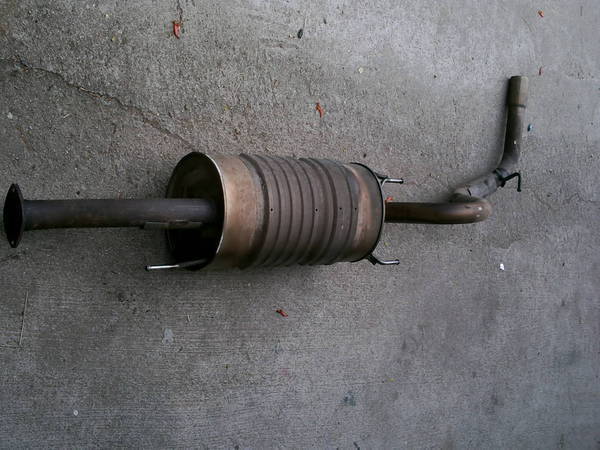

    wow, that muffler looks like a can of apple juice
