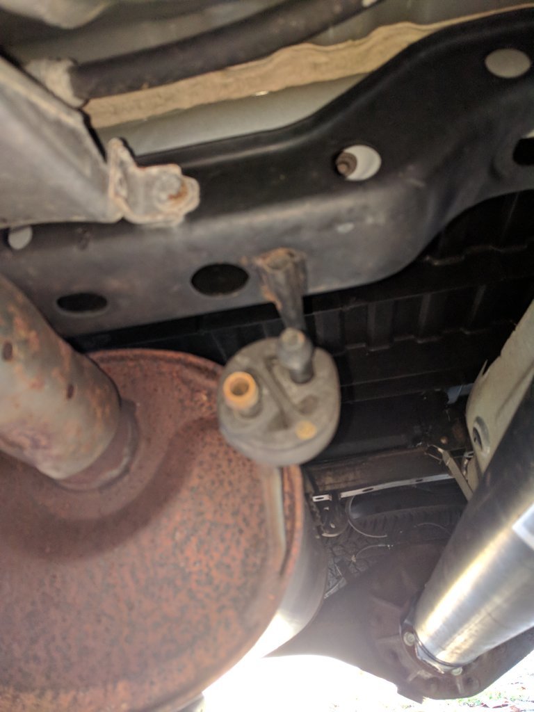

    I have a horrible exhaust rattle. The inlet pipe is hitting a crossmember. It looks to be higher than is should be, the hangers are horizontal. Anyone know how to fix it?

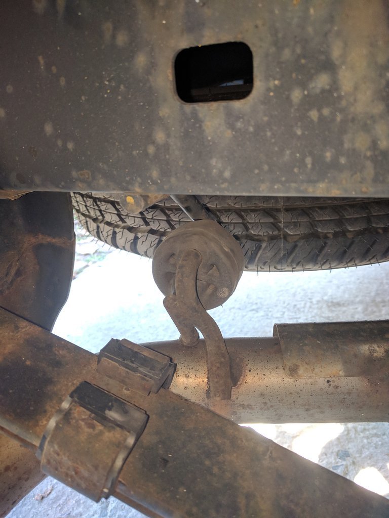

    There no movement on this hanger when I pull on the pipe. It's soild:
    This is where it's hitting:

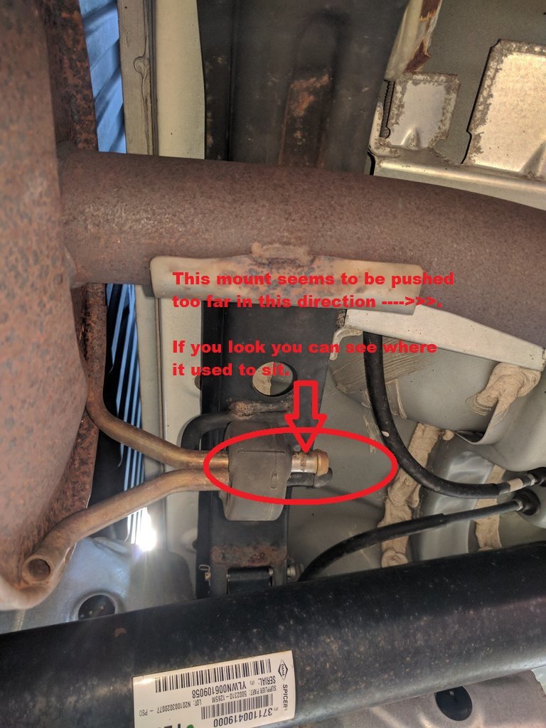

    Looking at the picture it seems the mounting is pushed too far into the rubber mount. Indicating something has moved.
    See Below:

    Looks like just the isolator moved. You can see the same wear point lining up on the upper hanger.
    OP, did you check the shields that are around the catalytic converter(s)?
