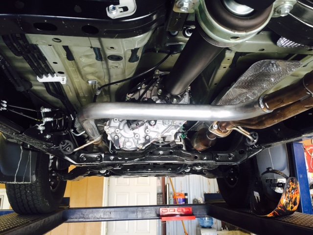

    Pros: Clearance, flat skids
    Cons: None that I can think of?
    I had it done a couple months back to fit my pelfreybilt skids and had it done for I think $120? I brought it to a muffler shop and he chopped the old piping off and rolled a new bend and welded where the old exhaust was chopped off. Easy as that.
    Edit: For the turn down exhaust, most people just hack off the remaining exhaust above the axle as well. Dont need a muffler shop to do that.

    Any pics of before and after the re-route? For that cheap it seems very worth it before ordering skids.

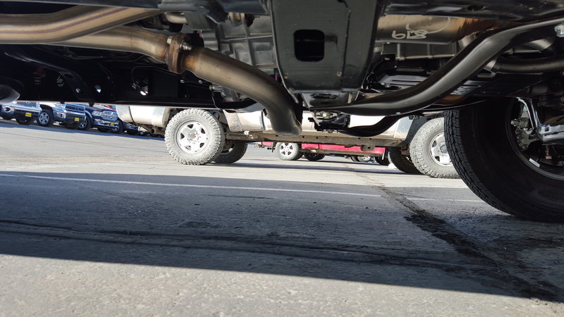

    Contact @Gadget@URD for a top quality bolt on y-pipe. Yes better clearance and exhaust flow. The URD one is made from larger diameter pipe and is also stainless steel !

    After reading a little more on the thread i couldn't find named "exhaust reroute". I typed that in 4 different ways and nothing. Anyhow, I think a custom piece is more for me. I will take everyone's advice and get stainless though. It just seems like URD doesn't get above the crossmember completely. It could have been the angle the picture was taken. Either way it seems like it can be done locally for about the same price.

    The URD one does. I have a friend with it, and it allows him to run a reroute skid. He also has their muffler and with the two combined, it sounds GOOD. Would definitely recommend if you can afford it.
    The custom reroute is a much cheaper option though.
