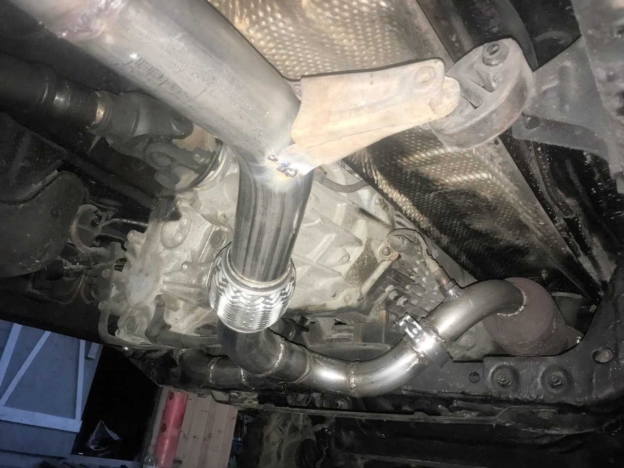

    Y-pipe replacement VS Y-pipe modifying... I need some input. My exhaust is pretty rusty. I mean it doesn't leak or anything, but it doesn't look like any of the bolts will undo without a fight. My driver side CAT heat shield band actually snapped today lol. I don't really care about performance or sound factors, I just want the clearance obviously without breaking the bank. Seems like you state side guys have pretty good shop rates down there compared to here in Canada. A DT y-pipe would cost me $450 CAD if I went that route.

    Y-pipe modifying. Just done one in my FJ, actually it's still a little under construction. Tried to do it as equal length, all stainless steel:
    I have a skid plate below the Y-pipe, so the location below the transfer is not a problem, there is space enough.

    Very nice!

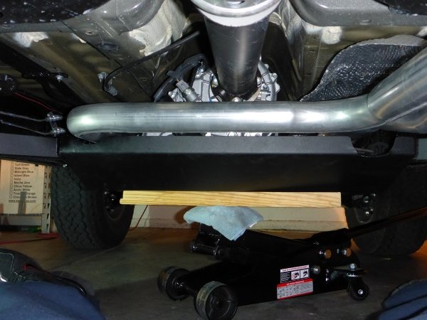

    Another bump
    Out with the old
    In with the new
    Kasbien likes this.

    Looks great @greeneggsnspam !
    After reading about a bunch of horrible exhaust shop experiences locally, I think I've finally come across the right place. I'll show them your pictures and see what they think.

    Had this done a while back. Just got around to posting them. :oops:

    SOme of these systems look nicely put together. THe big Fail i see though is that there arent any flanges or slip fit sections. When i use to have an exhaust shop I use to put sections in it that way you could take the system off incase you had to remove it to work on something else etc. Only on the caprice with spinners i wouldnt bother because they would want to pay for a good job.
