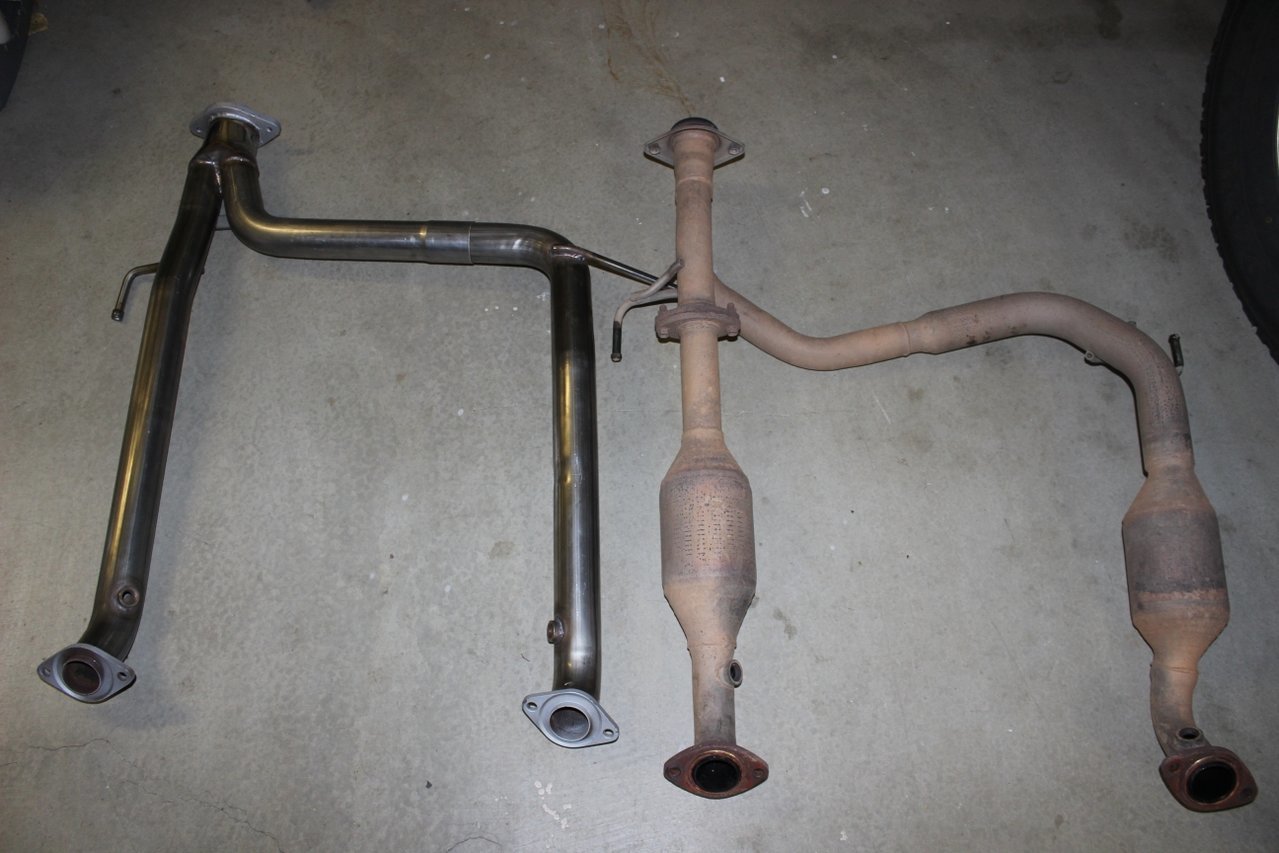

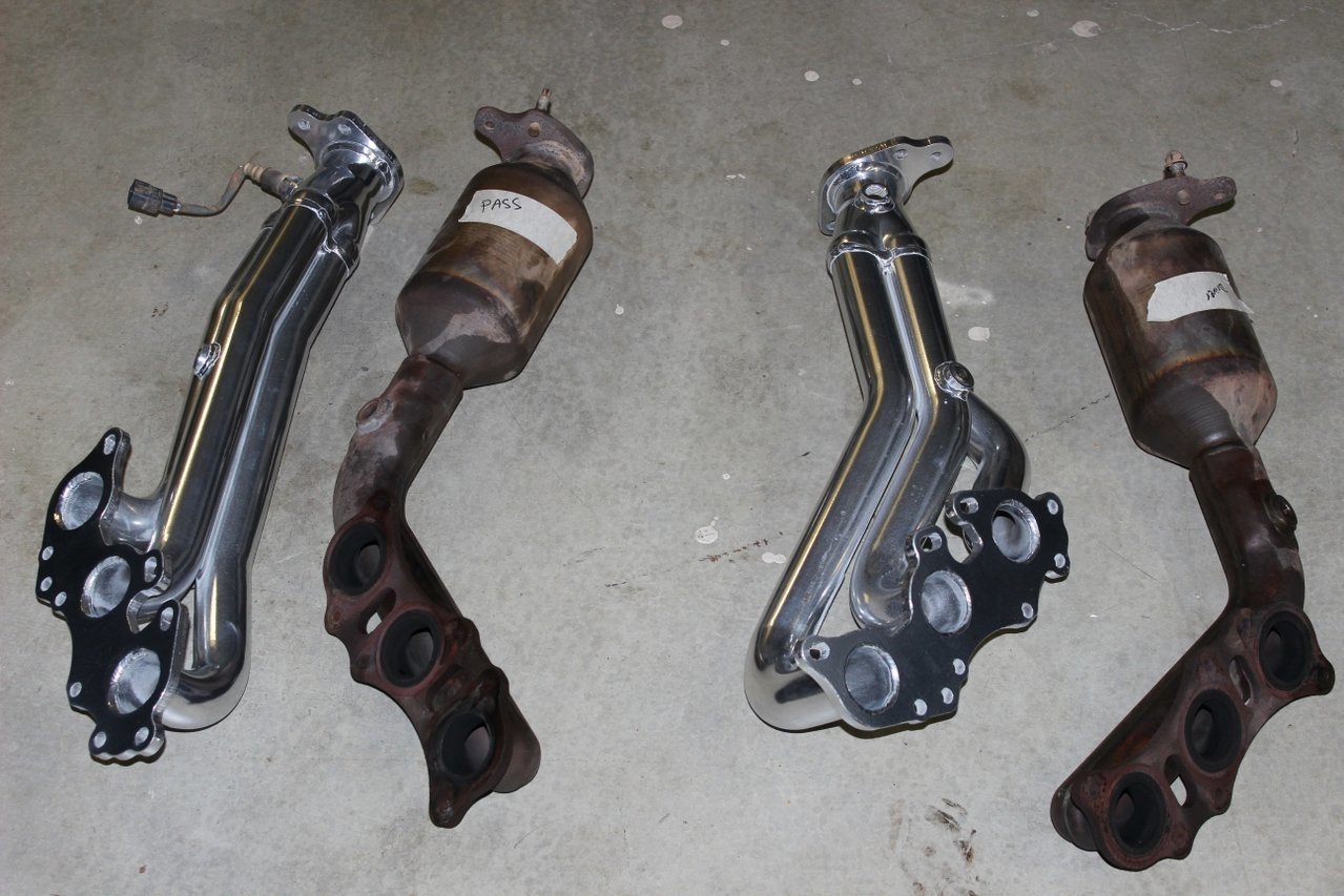

    Thorley pipe bomb is 1...... Urd is another.....Apr is another.
    u should have 2 sensors at the manifolds themselves... Then 2 more downstream on the y pipe. This design is normal for 2005-2014.
    I'll hop on my PC and get some pics in a second for ya

    stock manifolds next to doug thorley long tubes......Yes, the headers have 2 bungs on each bank for 02 sensor locations and optional wideband setups
    and stock y pipe next to URD y pipe
    see the buldge in the stock y pipe on each side? You should also see the bung (threaded hole) right by it, thats where the secondary 02 sensor screws in

    well your pics aren't showing (might be my smart phone). So you're saying there should be 8 O2 sensors total? because I just crawled under my truck and all I see is one bung on the manifolds before the first set of cats, then the flange to the y-pipe, then another sensor on each side before the second set of cats but nothing after that.. so 4 O2 sensors total, two on each bank, one upstream, one downstream from the first set of cats.
    EDIT: your pics are working now. Yeah, I misunderstood you, my bad. Looks exactly like what I've got.. so the y-pipe actually has cats, they're not just resonators right? Does anyone know if all 4 cats are the platinum ones? Cause you can get $100+ for each one if that's the case..
