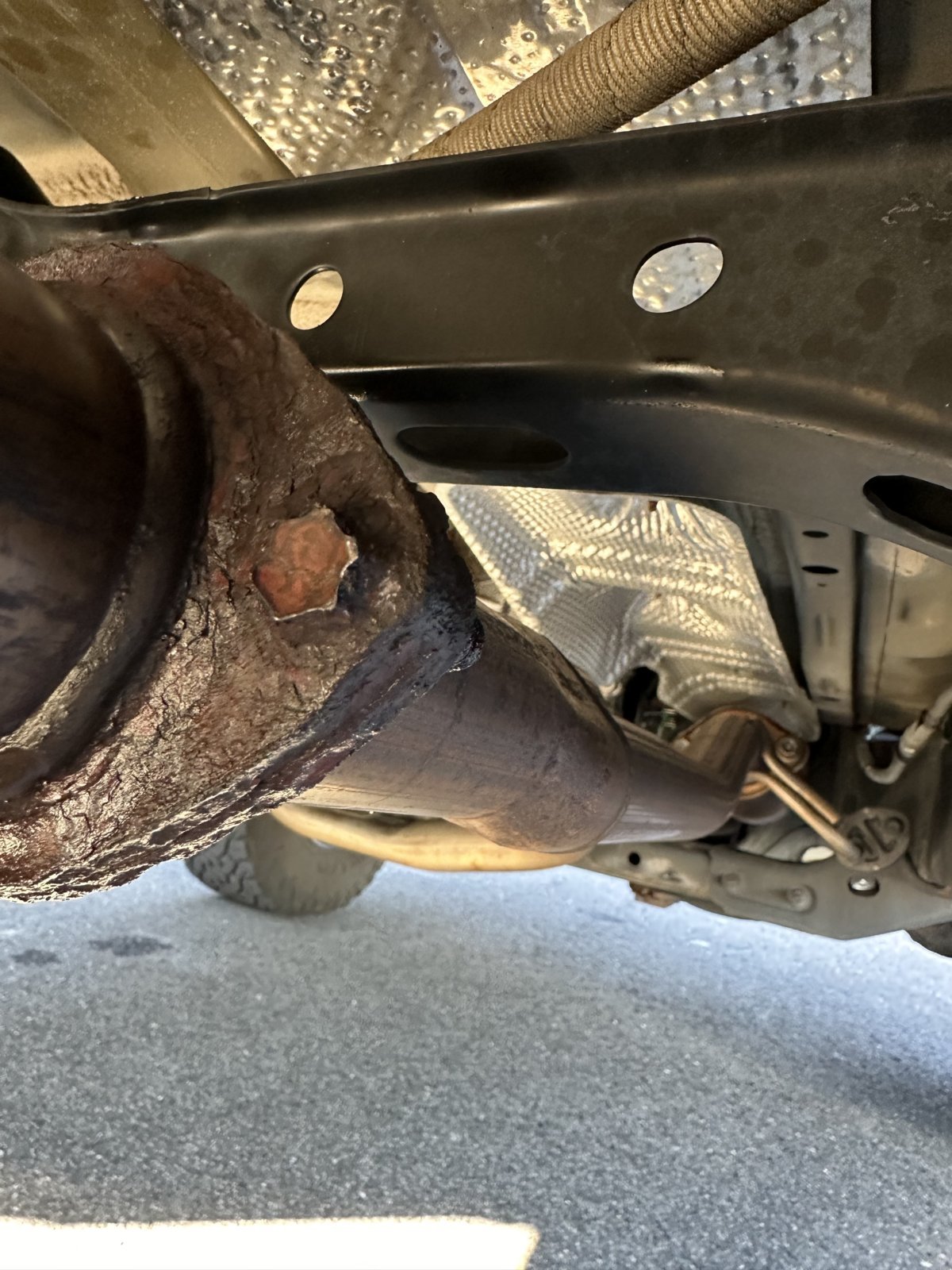

    Ok, I’m having the same issue. I’m installing a Carven exhaust and everyone says it’s a 14mm bolt. Unless I’m stupid somehow, a 14mm socket is way too big for mine. A 12 fits best but way too much rust to get it flush. Here’s mine.

    How people make the removal of two rusty bolts into this big of an ordeal is perplexing.

    Looks like mine. Always drops something in my eye when im shimmying around under there.. annoying as hell.

    It is perplexing. I’m guilty at times, of overthinking simple repairs myself.
