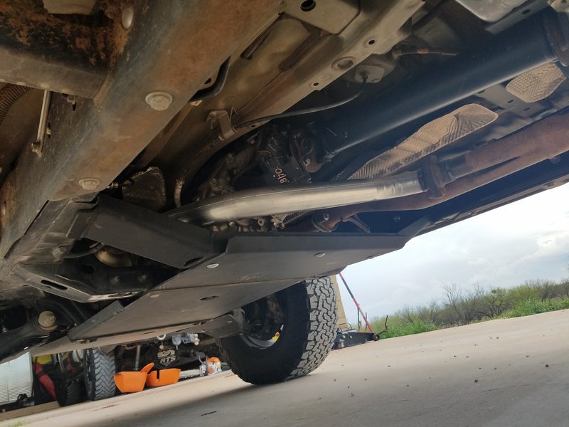

    Just had mine re routed after coming down on my skid causing a rattle against my exhaust. Toyota does a lot of amazing things. Why, however, it did not come from the factory the way the re route was done is beyond me. Tip to all of you buying skid plates, re route first. It cost me $100 at a muffler shop. Wayyyy worth the money

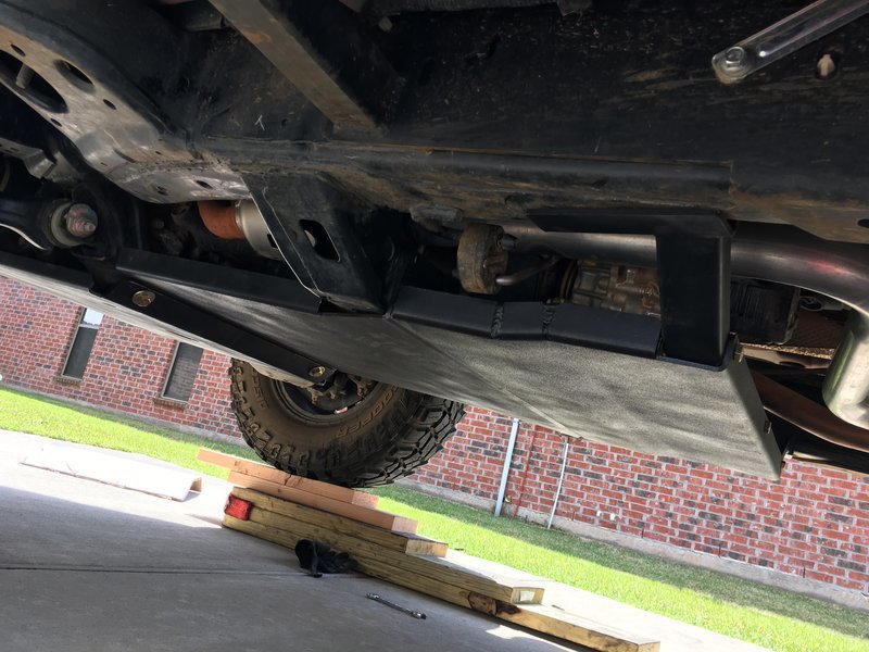

    I've got my Pelfreybilt transfer case skid that requires the re-route in the garage (2017 TRD Off Road). Have had it for a few months. Been too busy to get exhaust rerouted. But, at least, they made the skid a few months ago. There are quite a few threads on here about rerouting the exhaust---some with good pictures---one shows the exhaust rerouted and then with the Pelfreybilt skid installed.
