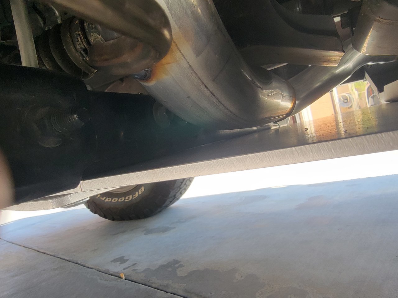

    I ended up going to Speedway Muffler in Norco. I chose to have them tuck it up in the stock location, rather than do the behind the actuator route. $185 and it clears the RCI skid with room to spare. Exhaust.jpg

    Thanks for all the advice, I think I’ll go tucked up above the frame in the stock location……appreciate everyone’s help on locations!
