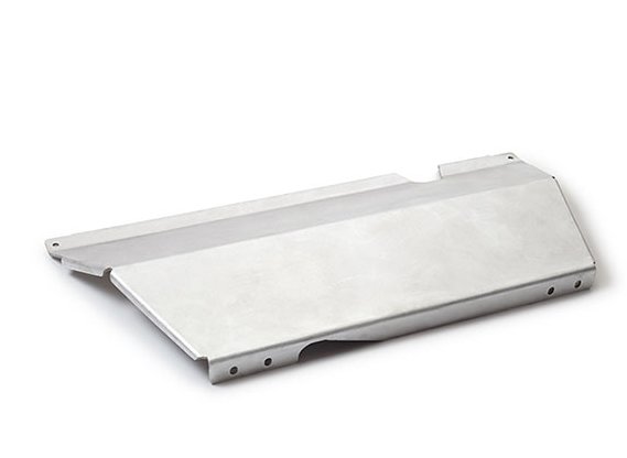

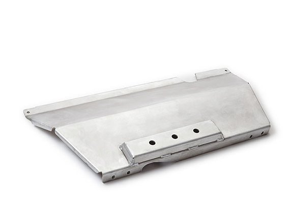

    Here's an example of a skid plate designed for a stock tacoma. With the reroute, that drop down is not there.

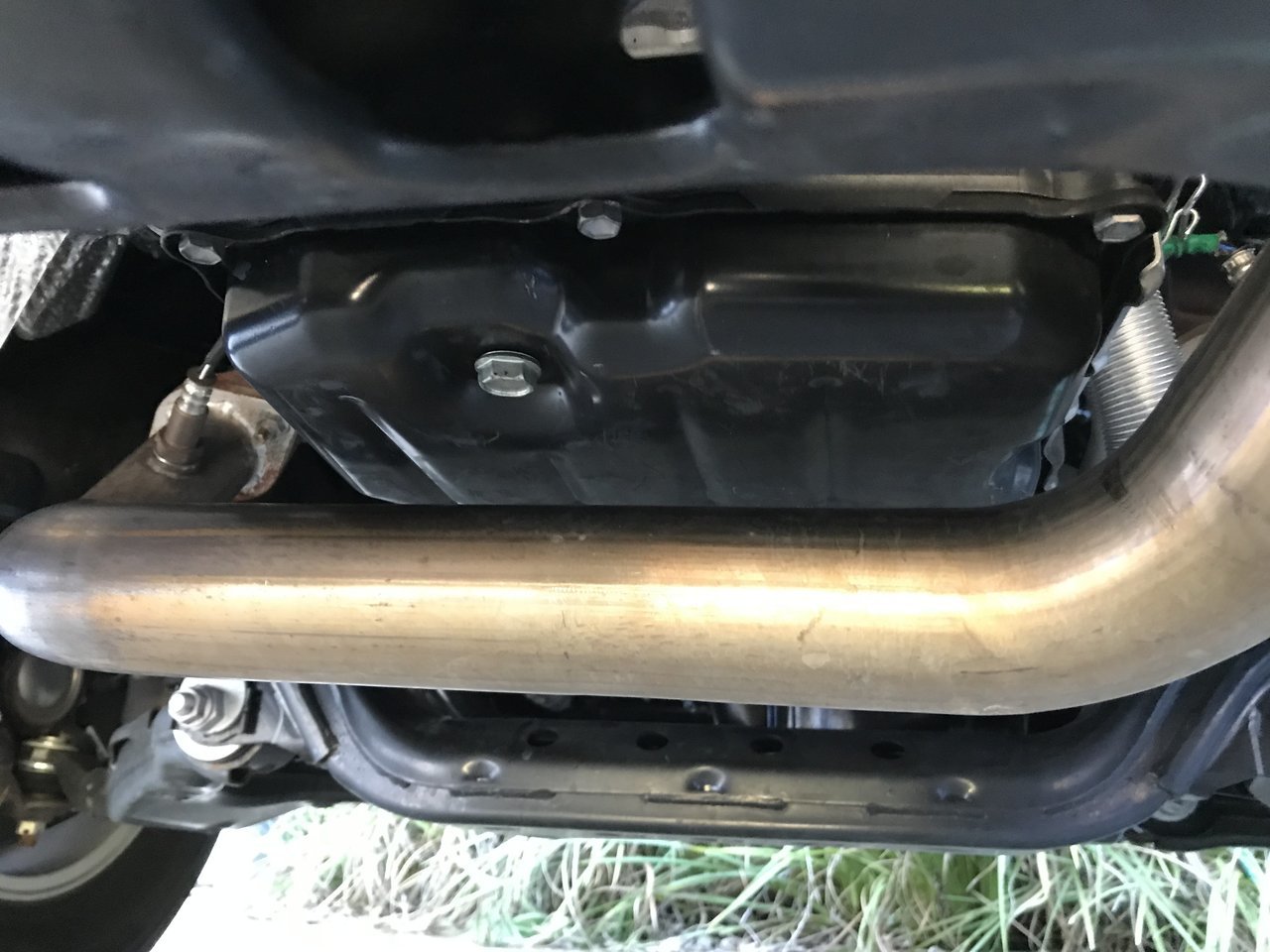

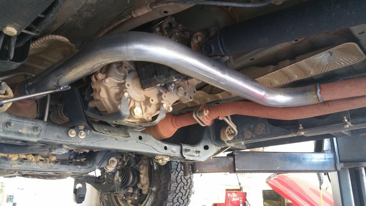

    Had mine raised up a bit.

    Kinda an odd route, why didn’t you just go around the transfer case?
  10. Nov 14, 2017 at 6:38 PM
    #190
    Cory07TRD
    Cory07TRD Well-Known Member
    Dec 22, 2016
    #205505
    197
    Cory
    Sacramento, CA
    07 Tacoma TRD
    Body Armor Rock Slider/Step, 5100's, Falken Wildpeak AT3W's
    Well I brought in a pic of the transfer case reroute but the guys at the muffler shop said it would be too hard, more expensive, and they'd have to move the y pipe. Or something like that, I don't remember exactly. It's a good shop with good reviews on yelp so I took their word for it. They got the pipe up an inch or so and I think it's fine my off road needs.

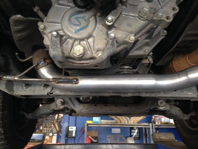

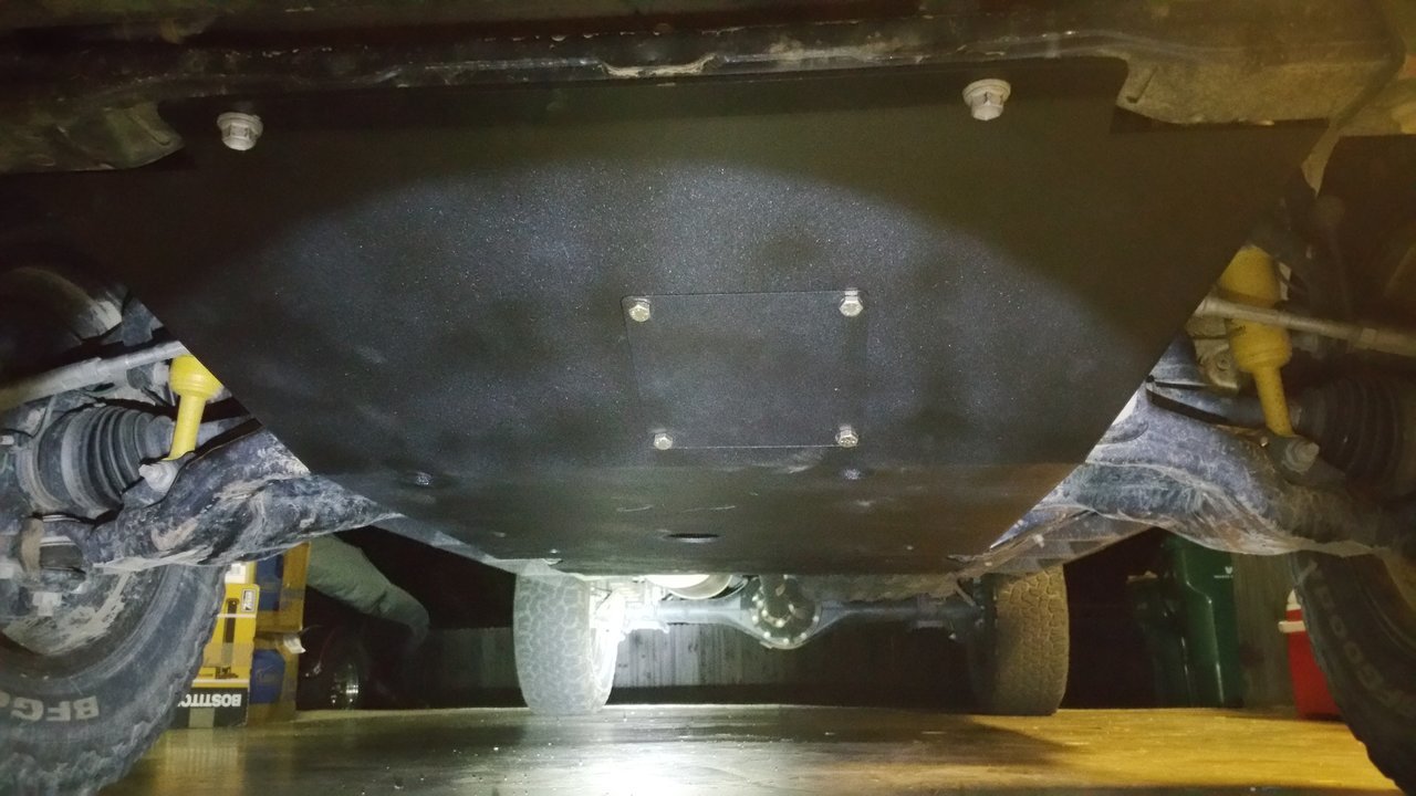

    I had mine done a few months ago like many other going around the t-case. $100 at Muffler king in Dallas off 78.
    Clears my Mobtown skids giving me a nice smooth belly!

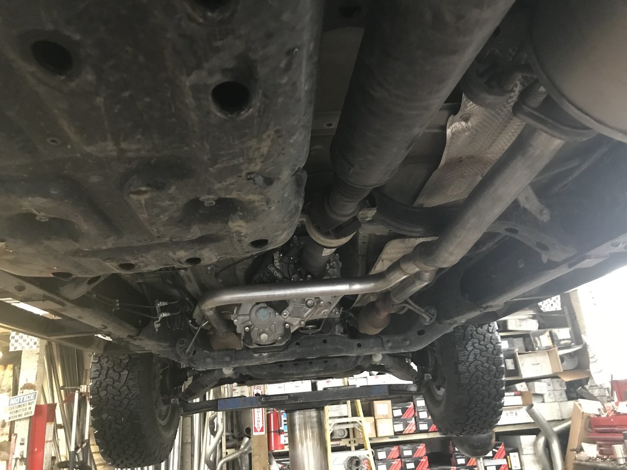

    Just got mine done at Quality muffler in Olympia. I had him do a little more work than most. Great job with good clearance. He did new y-pipe and moved the connection back to the front of the muffler.FABB5413-B09A-46B1-802F-A34988B431B2.jpg
