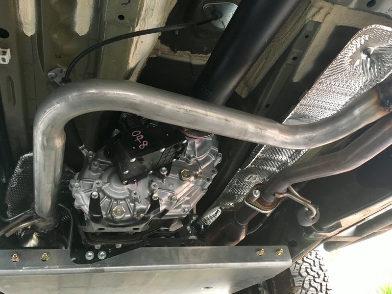

    I have the mark 2 URD y-pipe sitting in my garage. From what i can see the second set of cats is removed to instal, leaving the front cats still. But the sensor is in front of the second set of cats, so i belive the 2nd set of cats only clean the exhaust more. Removing the second set of cats wouldn’t effect the system as far as DEQ goes. But i could be wrong, not a mechanic.

    That looks like a very clean mod, but I live in So CA. After surviving through the smog caused by 70’s era vehicles and the old Kaiser Steel Mill as a kid growing up in So Cal, I couldn’t consciously do something like removing a Cat from my truck. You guys in more open states are lucky to have the air you have! :)

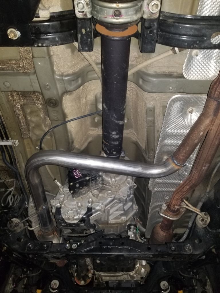

    Ohhh, it says “More Horsepower!”, can’t go wrong with that!:bananadance:
    Looks like it’ll be fine. I once clamped on part of a coffee can, worked just great too!
    How much did the reroute cost you, it looks good.

    Yupp, I did it for mooooar horsepower... lol! $140. Not too bad.

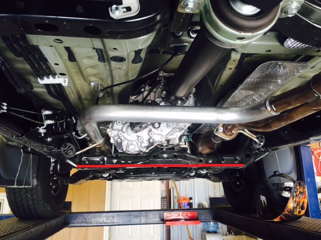

    Yep, that's the gist of it! The only goal is to get the exhaust above the crossmember (red line) so it's not the lowest hanging thing.
