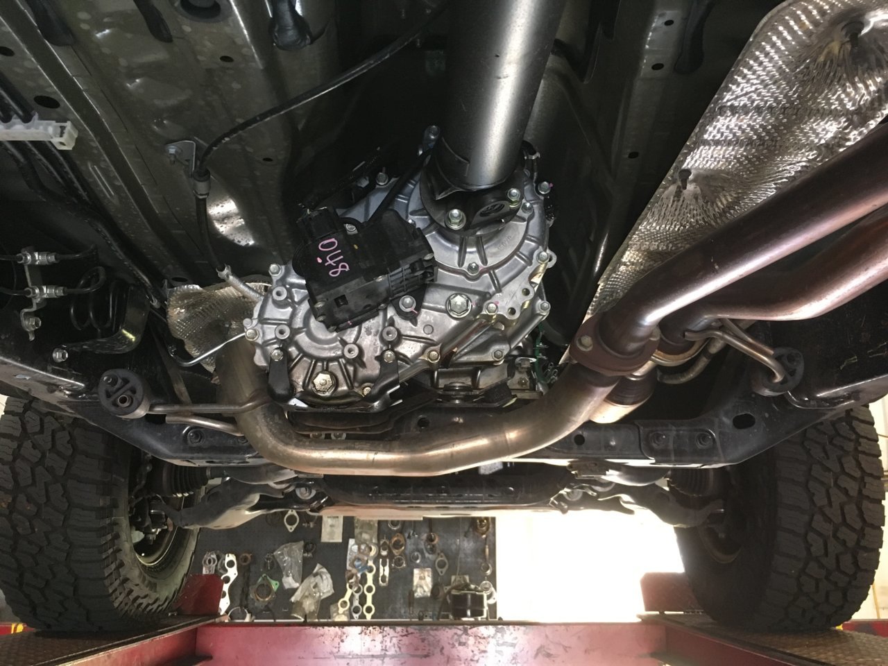

    I went to an exhaust shop that I knew had done a couple other members in my area. Told them what I wanted and showed them a pic of how it needed to end up from this thread. I let them do their thing and get it done. I think they used stainless to keep the material the same but really have no clue. Heres a pic that shows my reroute and how close they got to the second CAT. Looks like they matched the larger dia by the CAT and made the smaller DIA where it rejoined the stock again work.
    I agree. Go to an different place like an exhaust shop that is used to doing jobs like this rather than an offroad shop that doesnt have the right materials/tools to do it right.

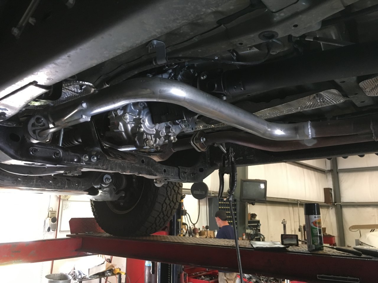

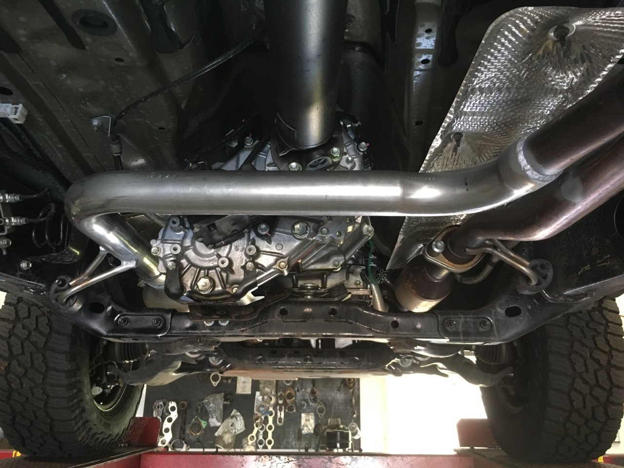

    truck
    Mine before
    and after
