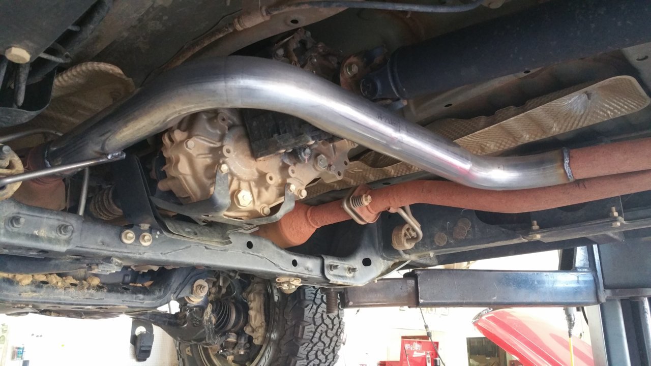

    Its not stainless- its “aluminized” steel. You can also tell by the color of the rest of your pipes, stainless doesnt get oxidized like that in the photo. Looks like a good reroute job though.

    The color on the stock exhaust is red dirt not metal, that crap is baked on and doesnt want to come off. Even if I move away from Tx, I'm pretty sure i will find red dirt falling off my truck for the rest of its life. :rofl:

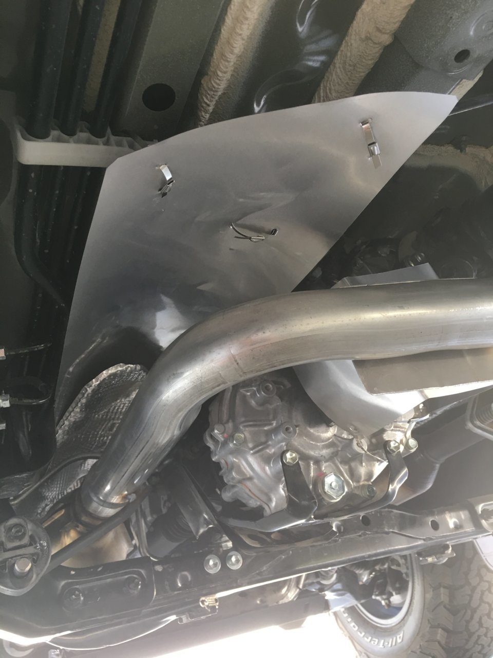

    I had 2 nuts spot welded onto the pipe to mount a heat shield onto it with short bolts, I also used aluminum flashing to make a heat shield “box” that surrounds the actuator and extended the stock “baking tin” heat shield directly over the pipe with it under the floor. Used stainless zip ties to attach it. If you do this, curve the sides of the aluminum heat shield downward so it does not hold dirt or gravel on it:D7863E03-EF6B-4906-8AC2-A17EBB92EDB9.jpg
