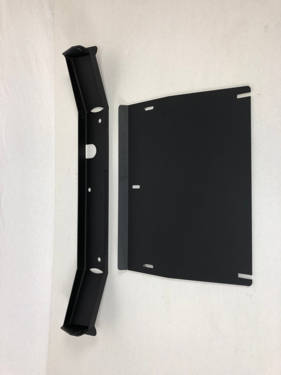

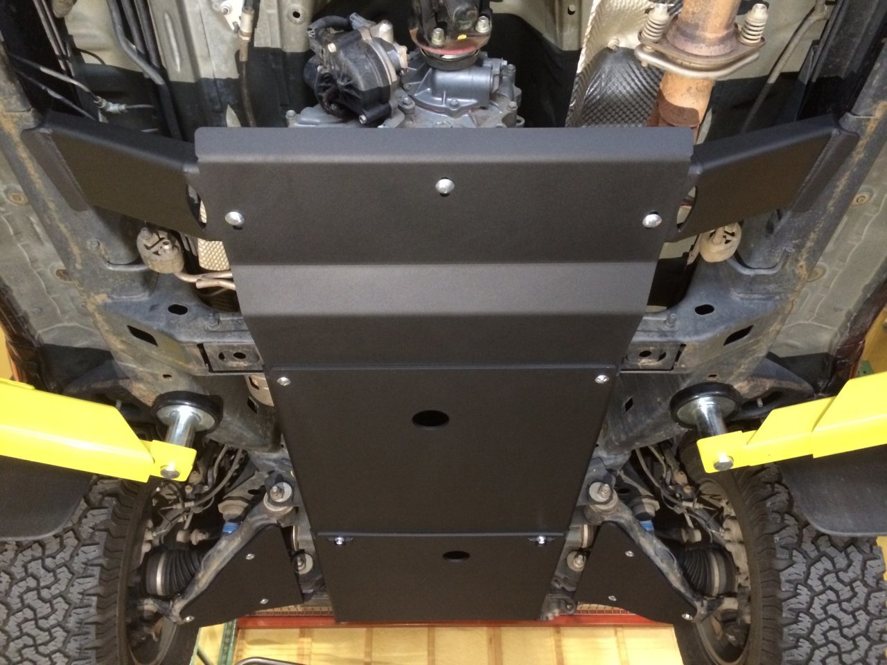

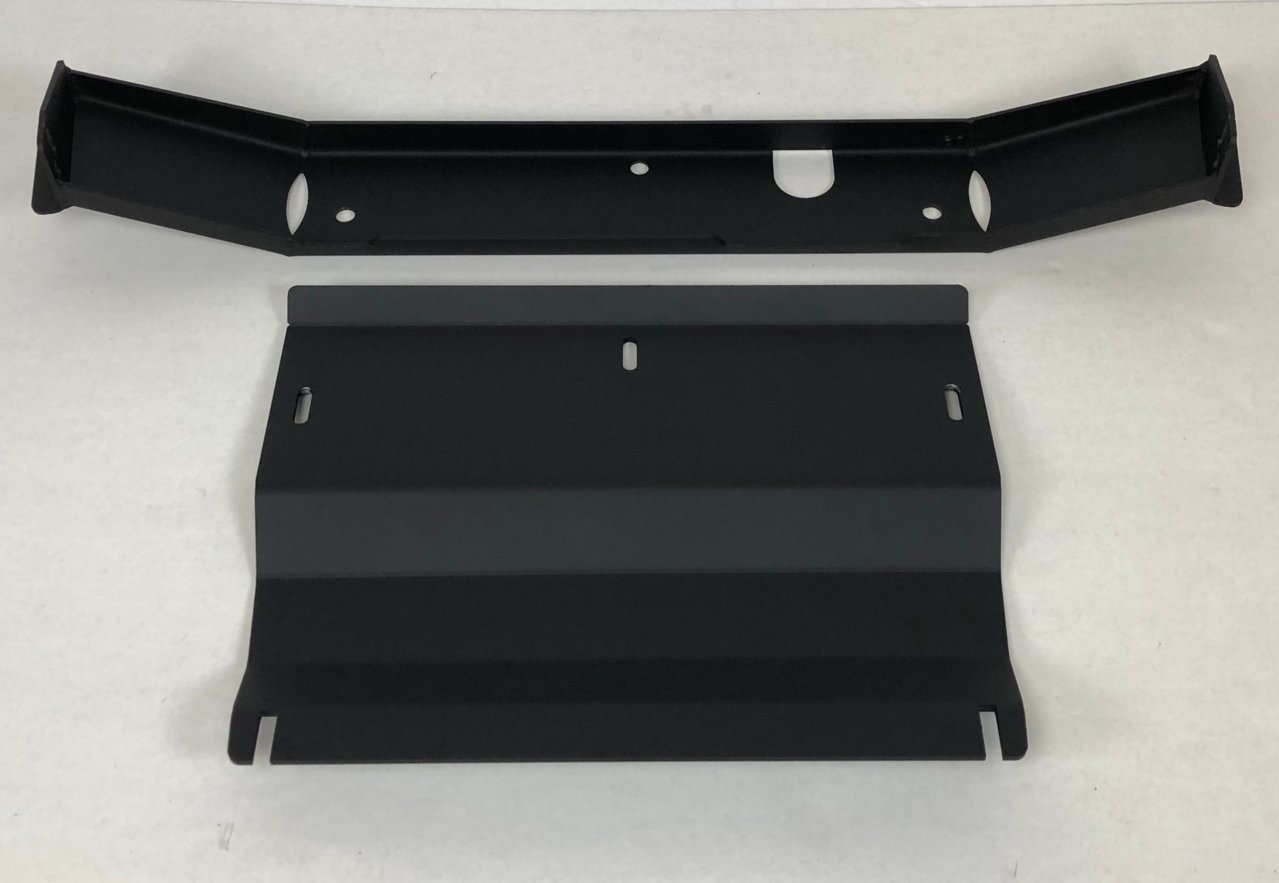

    Interesting, I just realized that now RCI offers a stock exhaust and re-routed exhaust t-case part of the skid, where if you have stock it tucks the last part higher up and if you have re-routed exhaust it leaves it at the same level. Mine is the one where it tucks it up, so I wonder if I even have enough room to do the standard re-route, or will I have to find a way to tuck it up a bit higher.
    https://www.rcimetalworks.com/2016-Tacoma-Transfer-Case-Skid-Plate-TACO-16-03.htm
    Stock exhaust, tucked up higher at the end:
    For anyone with a rerouted exhaust:
    SilverII and mcharfauros like this.

    I’m confused what you’re saying.
    Usually vendors offer two separate skids for whether you’re rerouted or not.
  7. Jun 20, 2018 at 2:55 PM

    Oh my bad, I got my skids way back in 2016 when only about 2 companies made them. They did not have the re-route option back then. As far as I remember.

    Ahhh I’m tracking. If you do the reroute, you’ll want the new skid. Otherwise the reroute is pointless as the skid will still be a low hanging point

    I ran normal skids and specifically did the reroute so I could get the reroute skids to gain back about 1-1.5" of clearance.

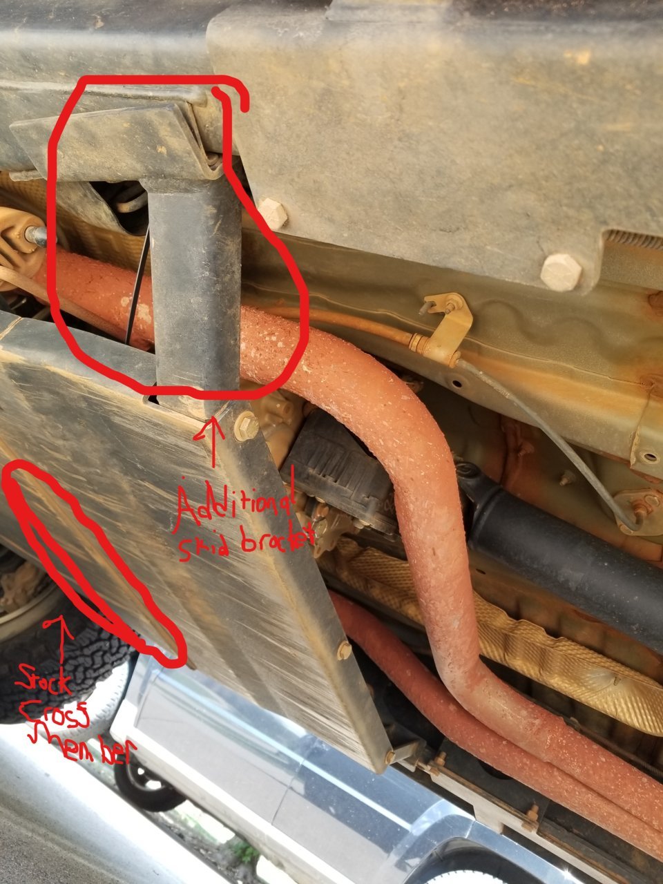

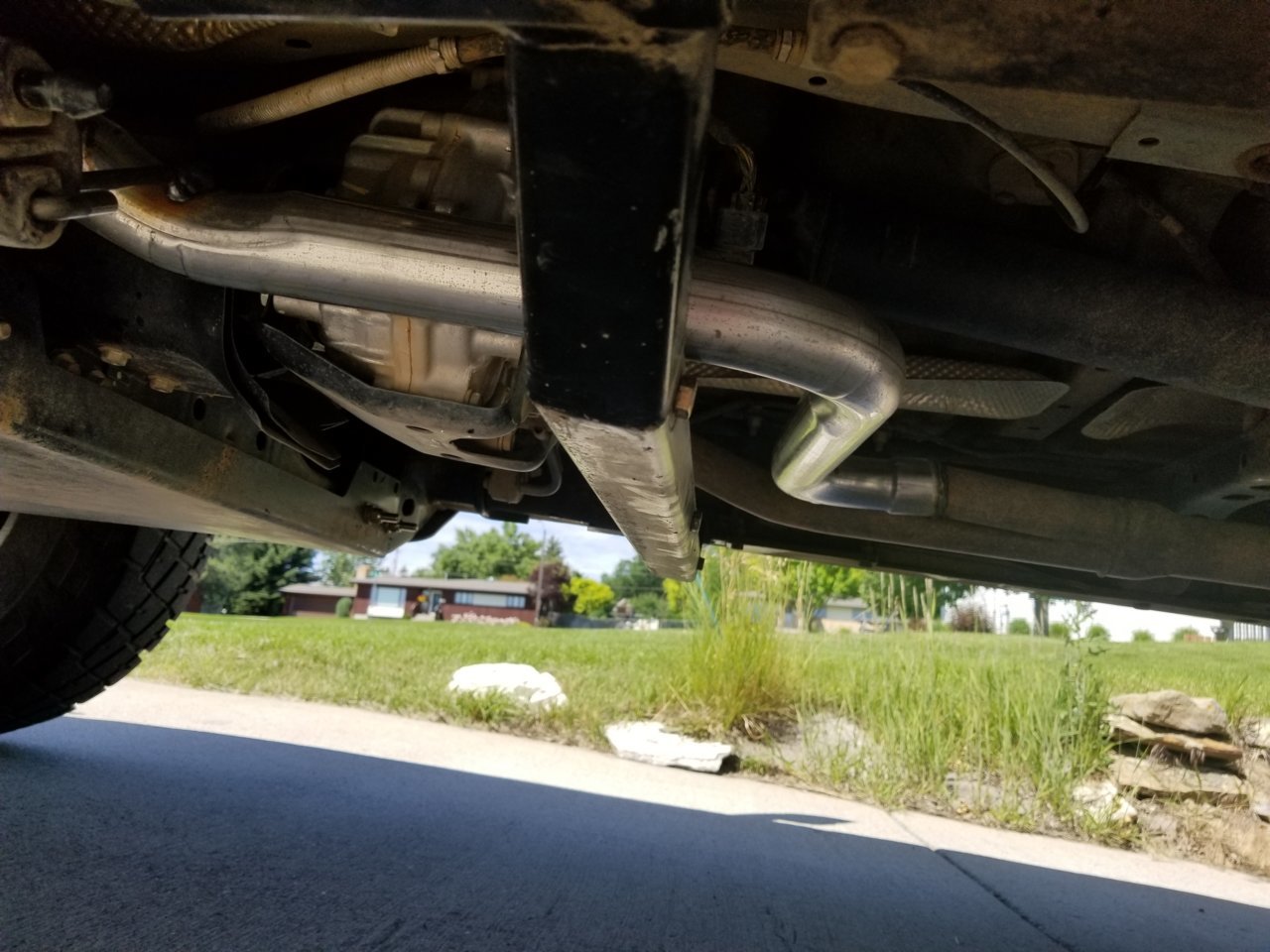

    And the skid plate does not fit. The exhaust lines up exactly with the support bracket in the Mobtown transfer case skid and keeps it from lining up by about 1/2”.
    Back to the exhaust guy.

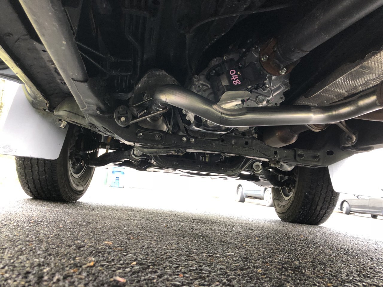

    Exhaust re-route is finally complete. Took the truck to a shop that does exhaust and fab work but normally works on Jeeps. I briefly explained what I wanted and he decided on the rest. Couldn’t have been happier!

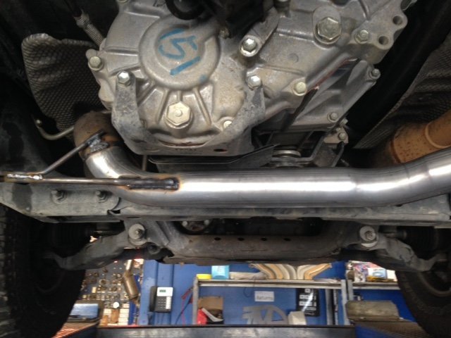

    Totally overpaid a local shop for this reroute. Looks legit though. 20180720_134133.jpg
