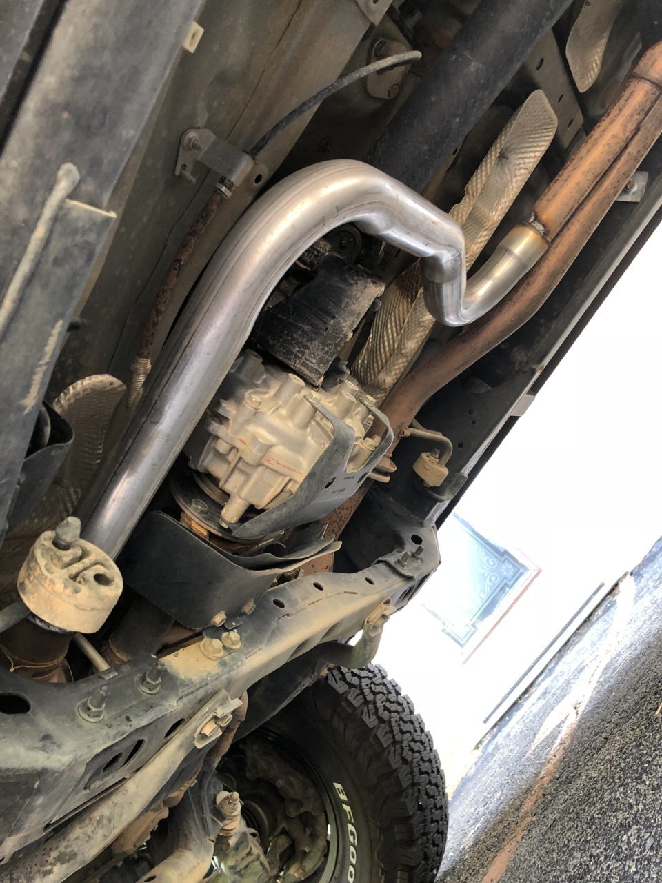

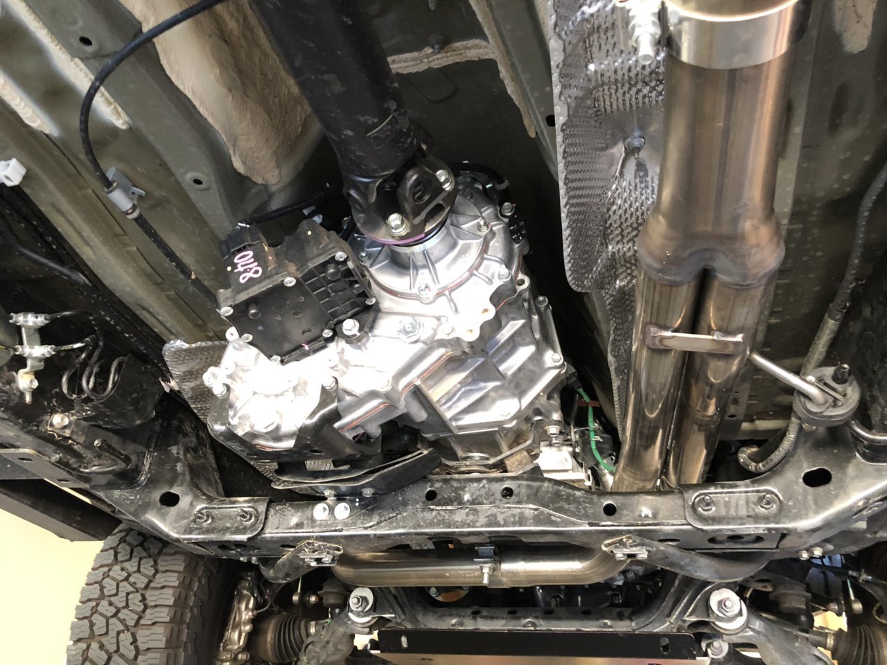

    Got my reroute done this morning. My local 4x4 shop recommended the place and couldn’t be happier. An hour and $50 later here are the results. I also got my exhaust tip chopped off cause why not.
    Now I can install my Pelfreybilt skid plates.

    Is it truly necessary to wrap the rerouted area in heat wrap? I’d rather have all my ducks in a row prior to installing the skids than have to go back and redo anything.

    My guy installed a heat shield where the reroute gets closest to the actuator as he thought it might be an issue.. Others said they have not had any issues with the heat affecting it. Other than that, I don't see where the heat would affect it, but also don't see how an exhaust wrap would hurt either.

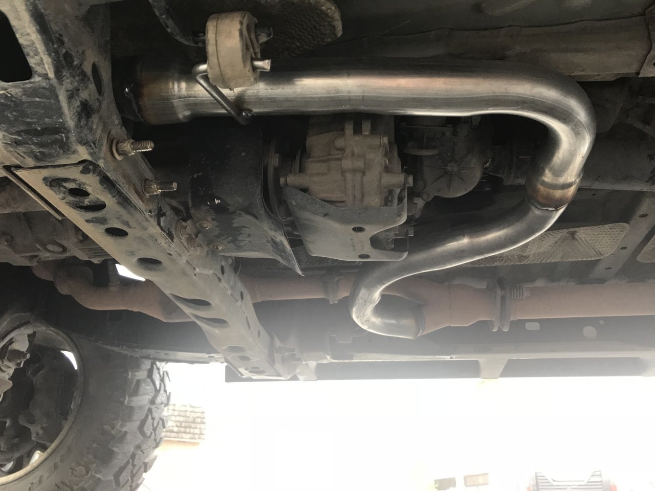

    Do you have a photo of yours by chance? I’m having a hard time picturing it. Below is my reroute if that helps. Maybe you can tell me if there is anything I should keep my eye on. I will probably buy some heat wrap just to be safe.

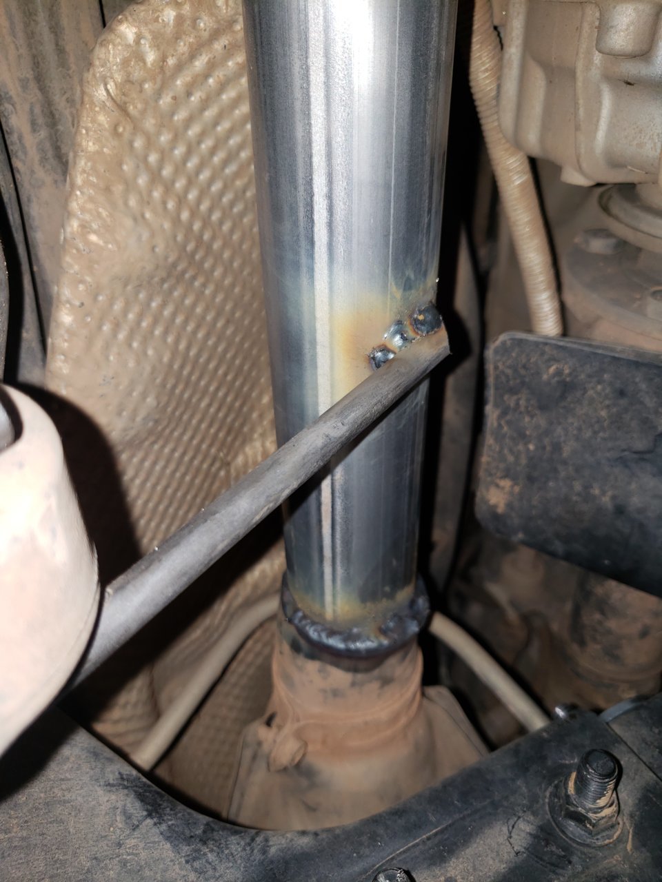

    Post #233 in this thread is a pic of my initial reroute. I ended up getting it redone after realizing the bracket on the T-case skid would be hitting the exhaust. Basically that black thing sticking out the back of the transfer case, is the part he was worried about being affected.

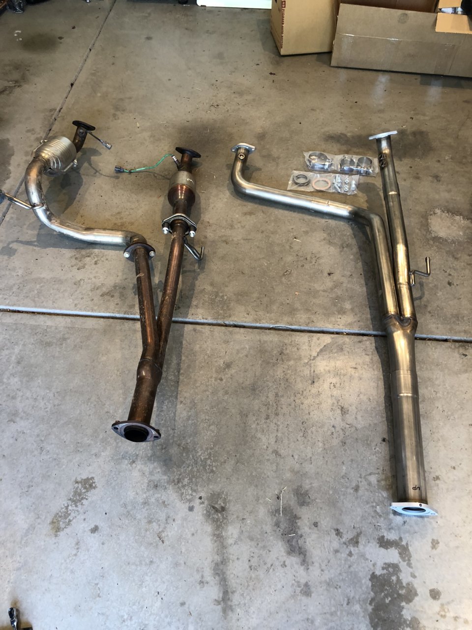

    I went the bolt on method. I can change it back whenever.
    It's not the full Spec-U so I can use whatever cat-back I want. For now It's just stock.
    URD Y-pipe.
    Stock
    Compared side by side
    URD
  20. Jul 23, 2018 at 9:44 AM

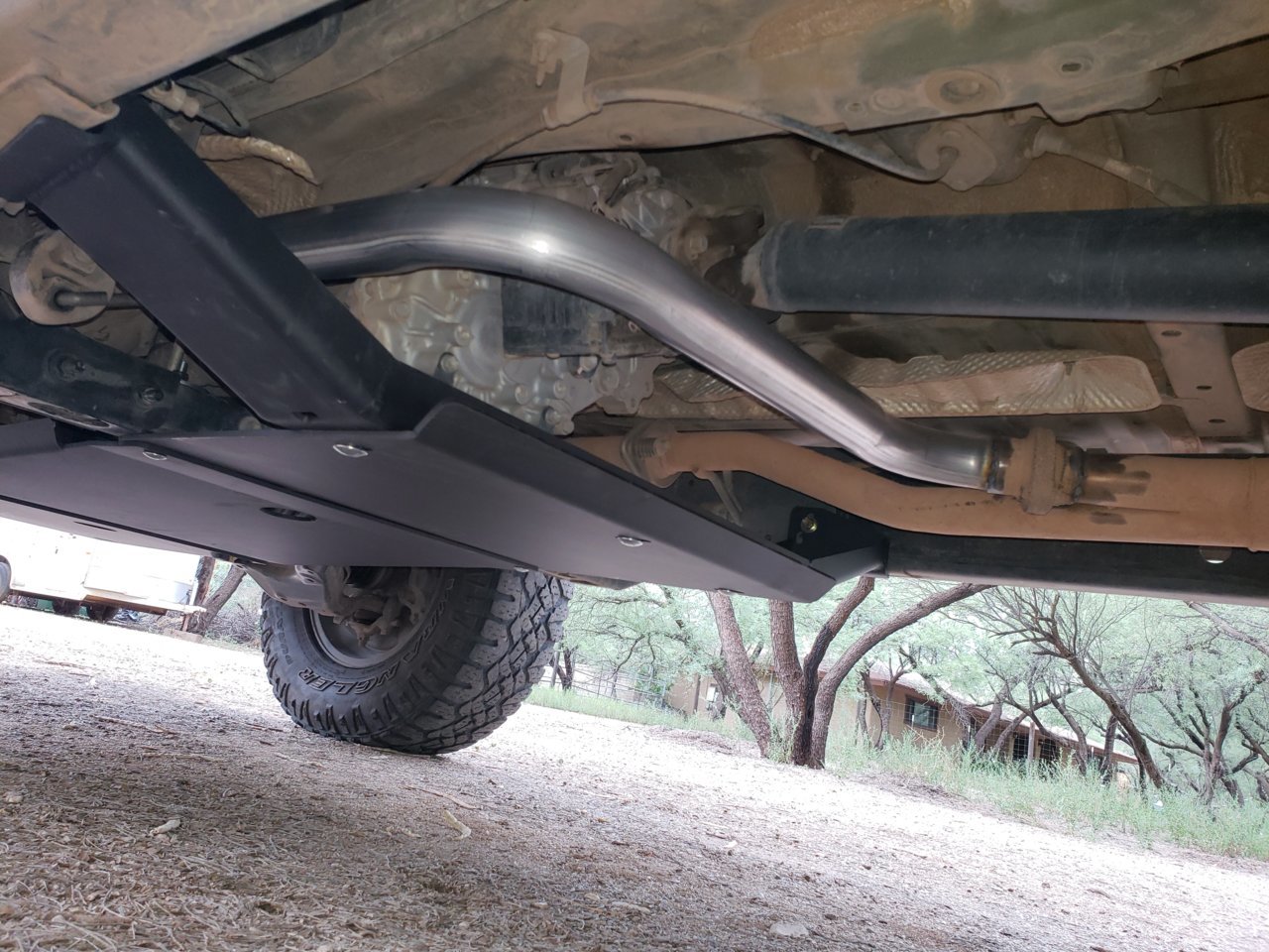

    All finished. Looks like it’ll work out great. Can’t wait to put the new skid on.
