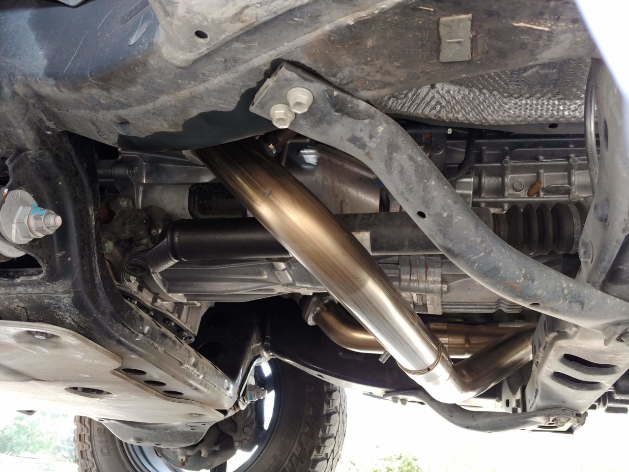

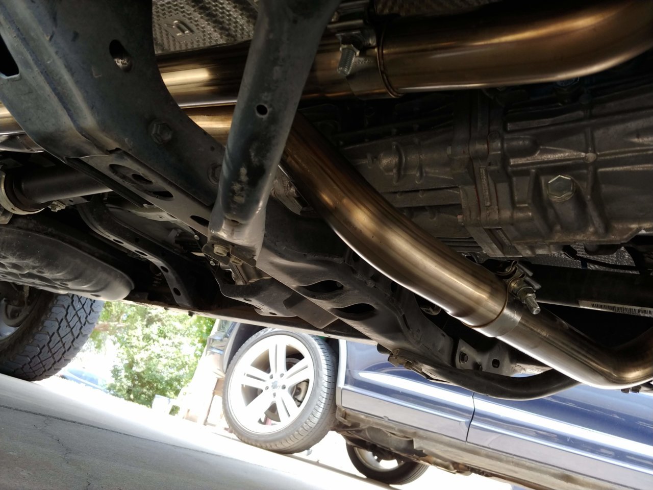

    i did the URD Y-pipe and re-route today. came out great. rear cats gone now which is kinda nice as well.

    That’s a clean setup. Do you get a check engine light without the cats?
    su.b.rat[QUOTED] likes this.

    9,869
    nope not ever. and i keep changing the exhaust trying new things, and still never a CEL.

    Had the reroute done today. The guy did it a bit differently than I expected, but it is now higher than the transfer case.

    I'm not an expert of any kind, so please keep it in mind... now if that was my truck and there was no way for them to re-do it, I would install a heat shield between that re-route and that plastic, just as a precaution

    Agreed. Maybe it’s the angle of the pic but that looks right up on that actuator, or whatever that black plastic box is.
