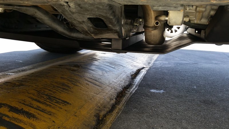

    I got my RCI skid plate system installed and I lost a lot of clearance under the transmission and transfer case cross members. I wish I would have known how to get the exhaust rerouted before i bought the plates. I know I can still get it rerouted and remove the spacer and cat bars and get a lot of it back.
    I was iffy about chopping up a brand new truck. That's a very tall speed bump
