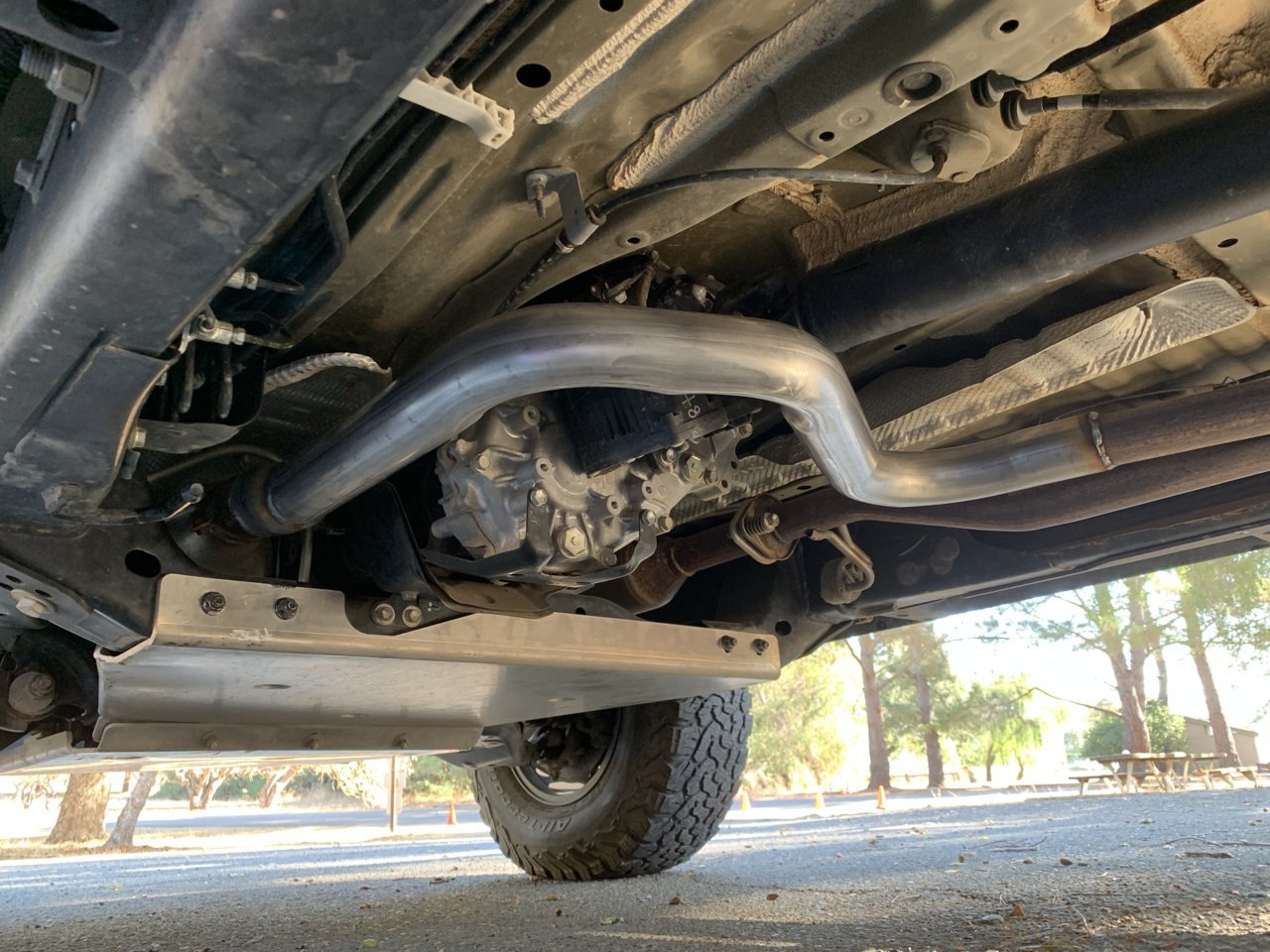

    Thanks for sharing. This definitely looks less problematic performance wise vs squishing the pipe up closer. I'm gonna take this pic into shop when I get mine done. Hopefully soon.

    NICE! I will show this pic to my exhaust guy & tell him "l want this!" HAHAHA.
    I like that the bypass isn't too close to the u-joints or the plastic near the transfer case. :thumbsup:
    BTW, are the secondary cats removed? I can't tell from the pic

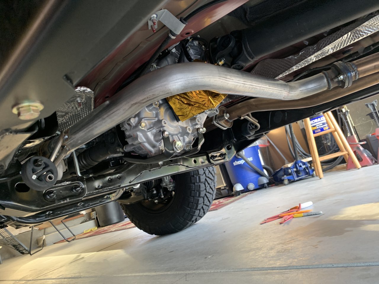

    It’s the same as most of the rest. $100. A4B6A0A9-25AC-47C7-87E5-649AF845095B.jpg

    I did end up taking off the wrap. For heat shield, they put some sort of shielding tape. I really don't think you need any protection though, but that is just me.

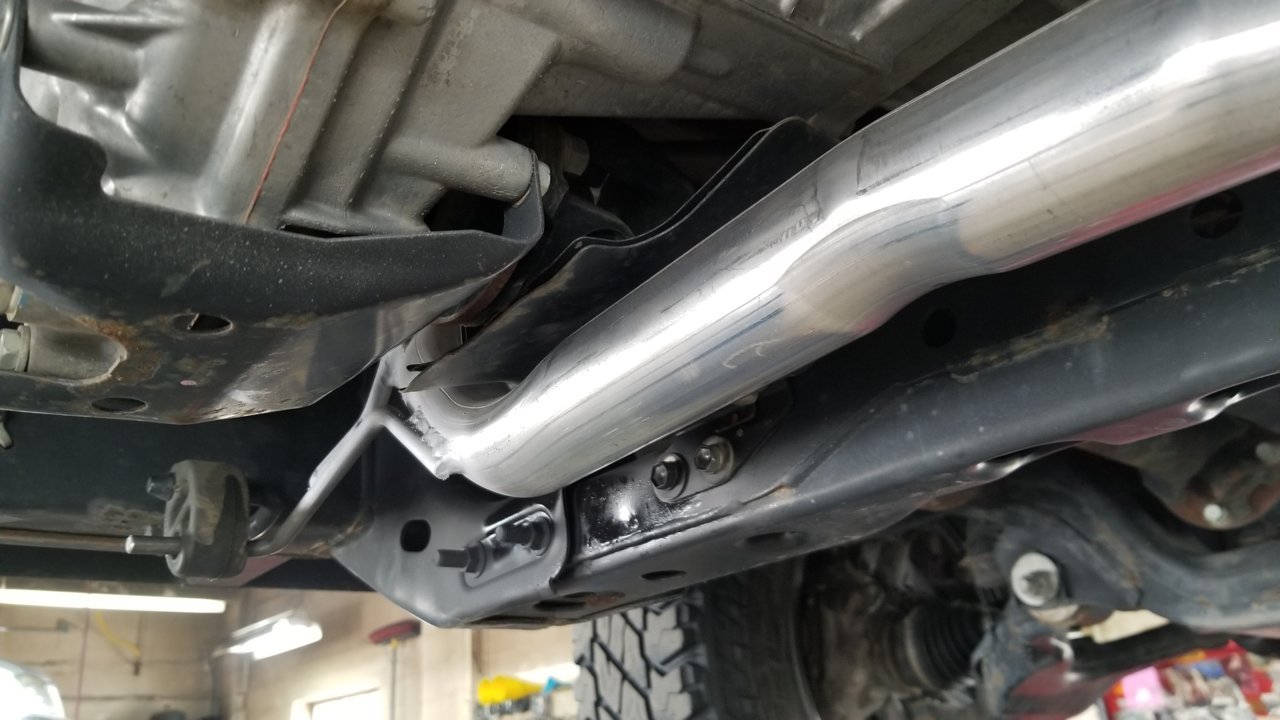

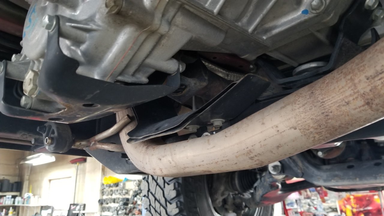

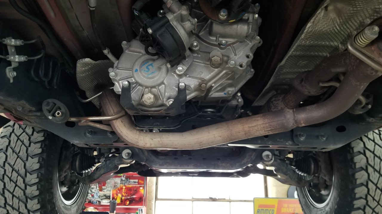

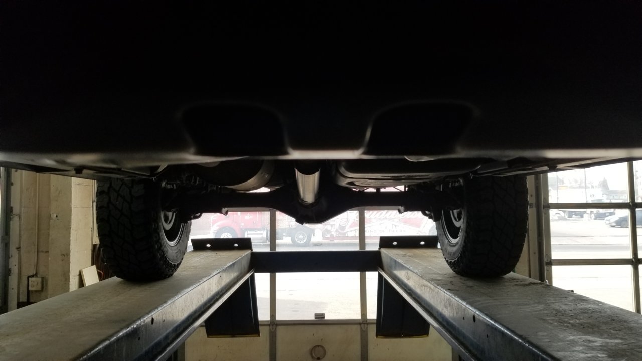

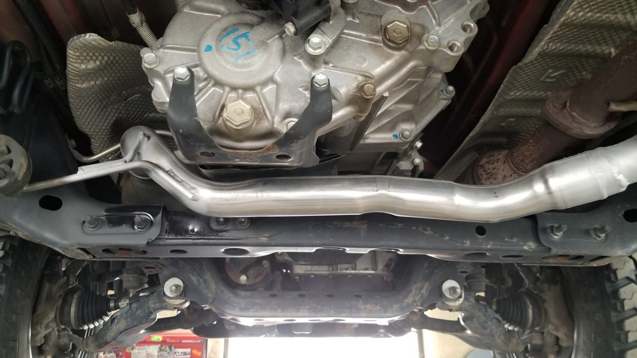

    Had this mod done today by CES Custom Exhaust Specialties in Bend Oregon. I think it turned out pretty good. Not sure why anyone would go behind the case instead of under it. After looking through this whole thread I knew this is how I wanted them to do it. They also just tied into the factory connections so it will be easy to remove or add an after market muffler. Now I can add my new RCI tranny and transfer skids.
    On my previous Pro that I owned I didn't do this mod and the skids looked weird on how low they hanged. After I get done installing the skids tomorrow I will post pictures of the skids mounted on my Pro without the reroute done and with the skids mounted on this Tacoma with the reroute done so you can see the difference.

    Looks good! I might try that route for the exhaust. Did the shop use stainless pipe for that? From the color, it doesn't look like aluminized pipe.
