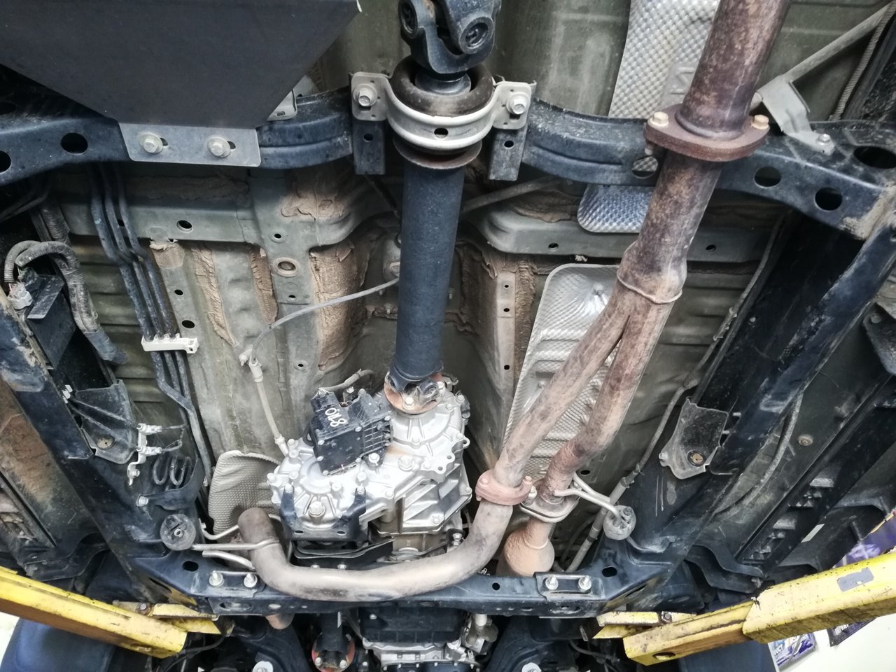

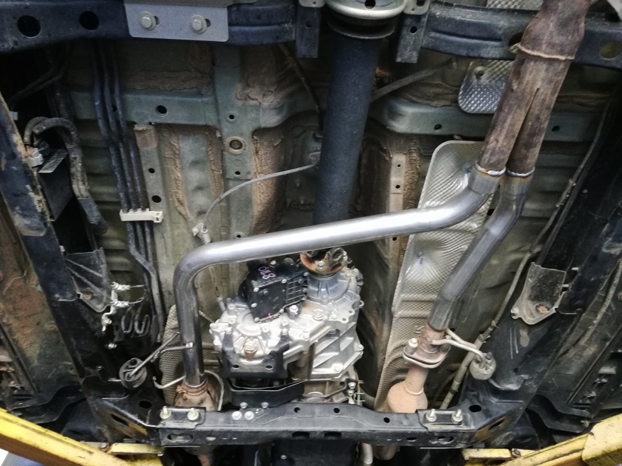

    Did you take your skid plates in with you to ensure they would still mount up with the exhaust running there?

    Yes. 2.25" stainless.

    Yes. I left the RCI cross-member on and had the skid plate sitting in the bed of the truck as I wanted to make sure everything would fit good. I actually forgot to tell them I had it and they ended up asking if I brought it. I think it turned out great. Will post pictures of the skids mounted later today.

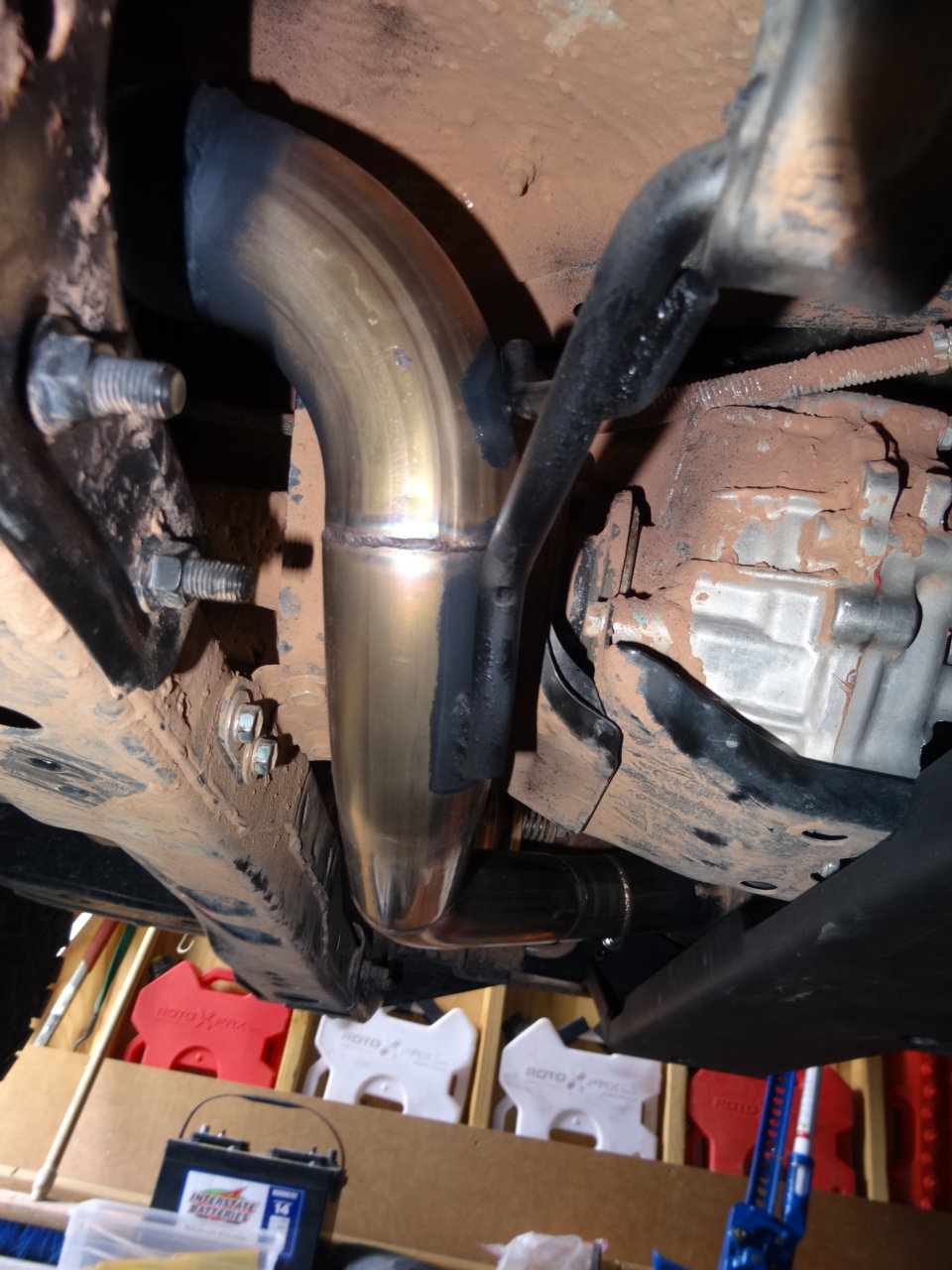

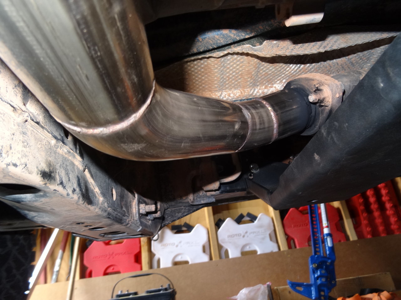

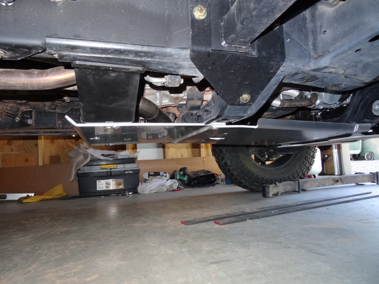

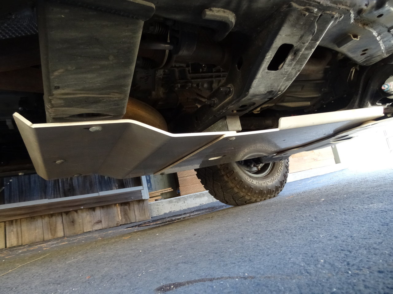

    Pictures to show what it looks like with RCI skids without and with the exhaust mod done.

    Is there an option to have CBI ship a skid flat like that?
  10. Nov 17, 2019 at 1:28 PM
    #430
    roth_nj
    roth_nj Well-Known Member
    Sep 29, 2015
    #165396
    558
    2017 DCLB trd off-road bbp
    Yes you can order them with or without the exhaust reroute

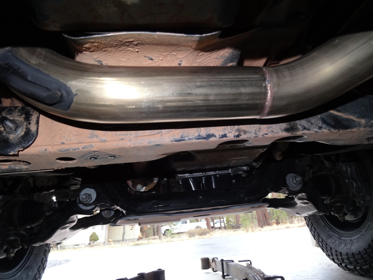

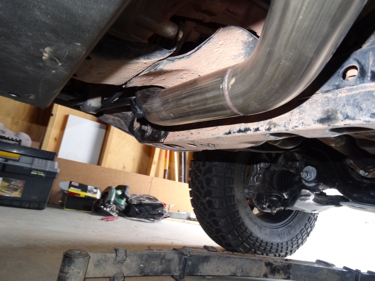

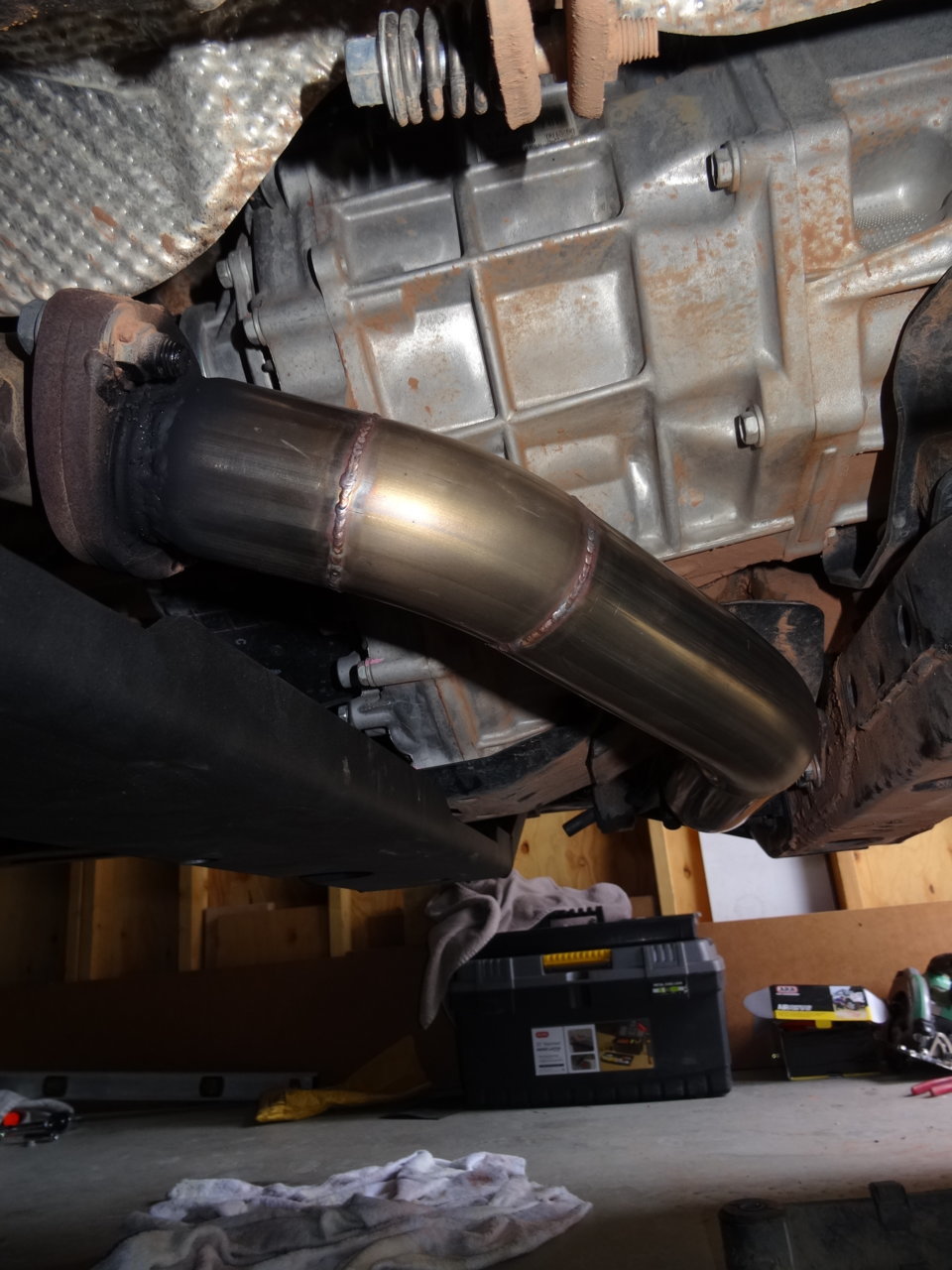

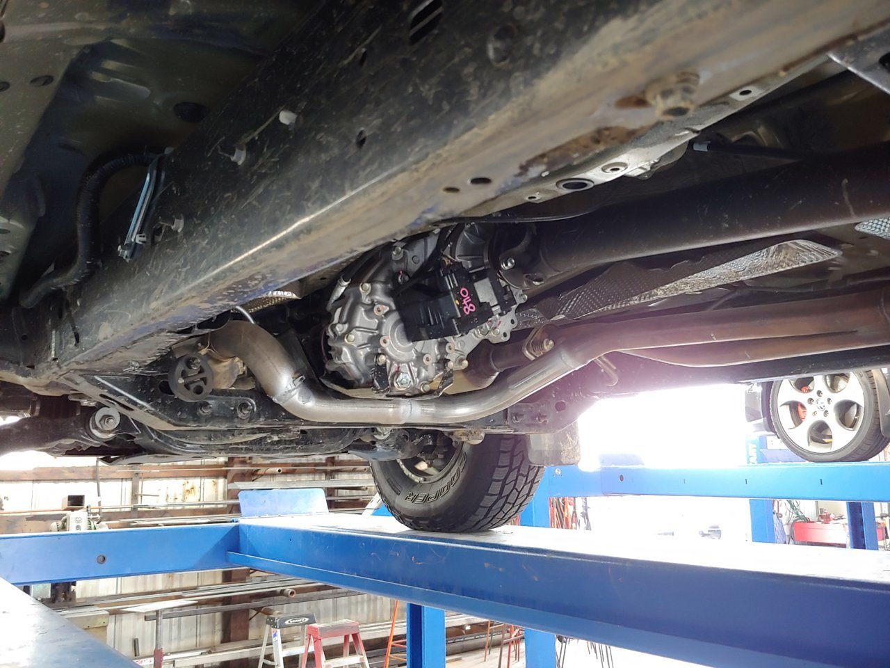

    reroute done, now is time to modify transfer case aluminum skid plate which was designed for stock pipe
