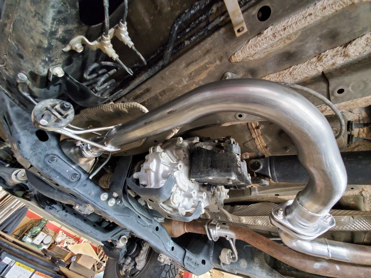

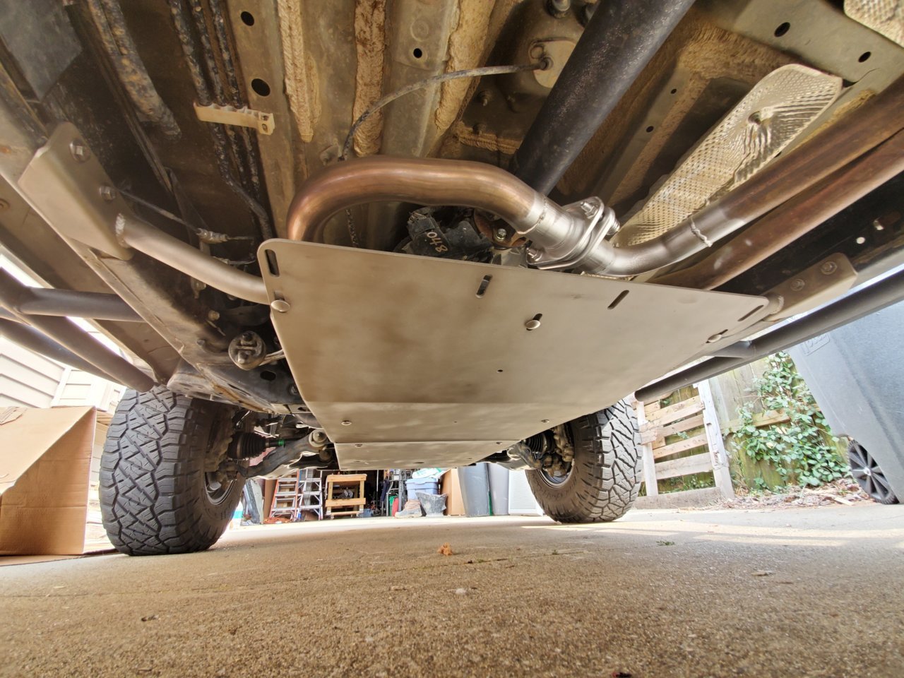

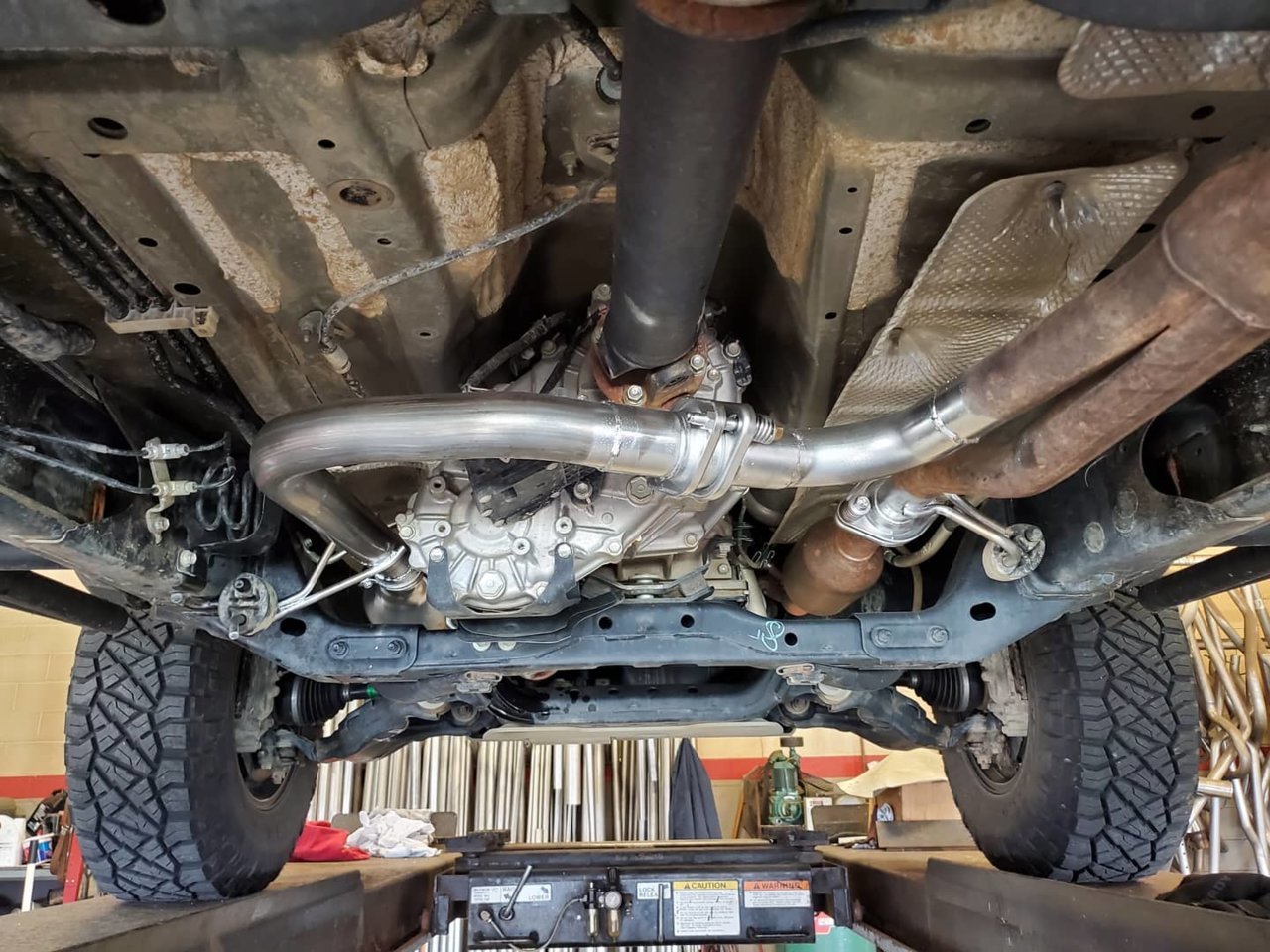

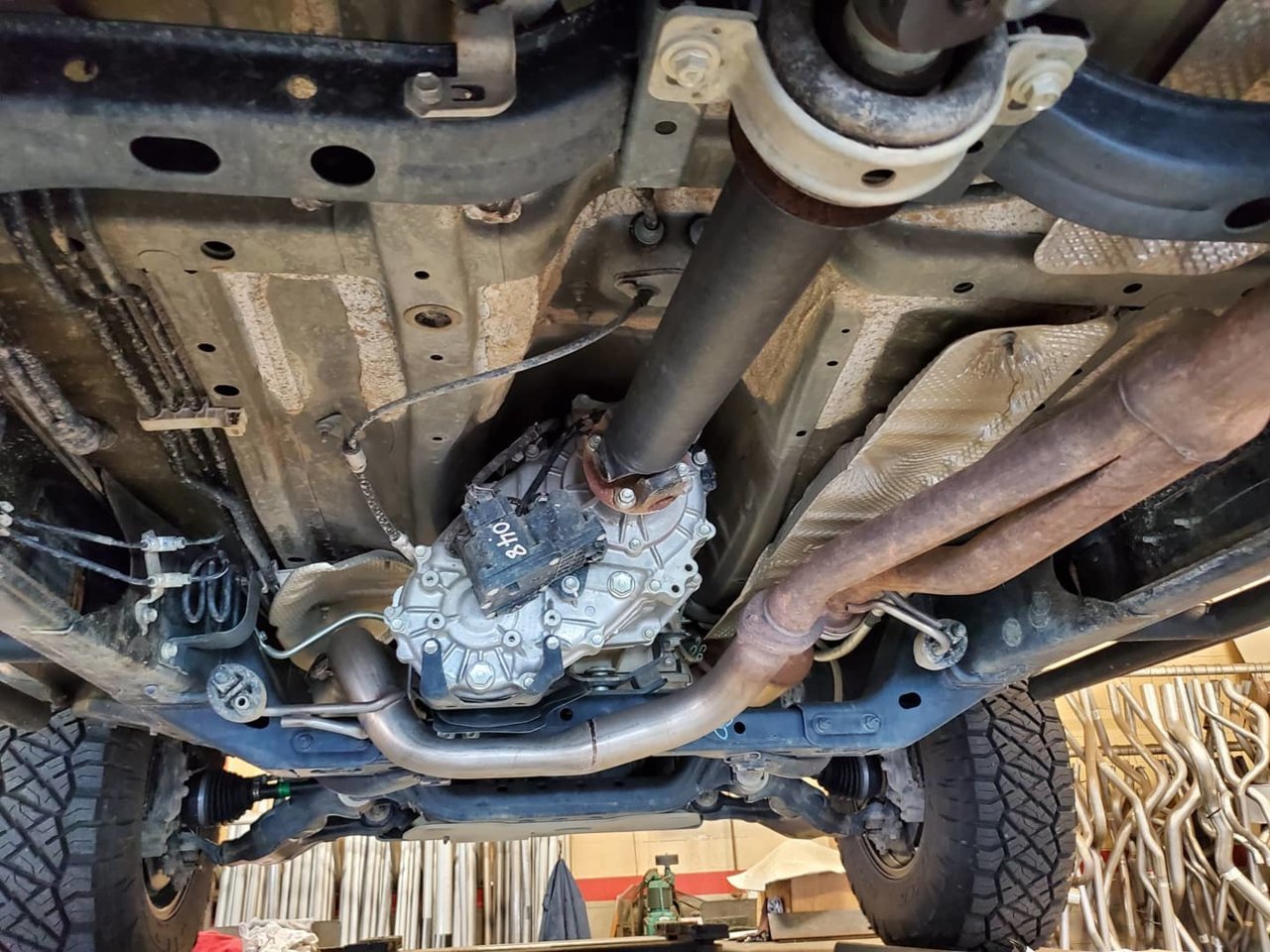

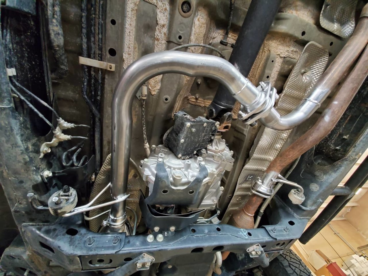

    Corey
    2017 Tacoma TRD Off-Road
    SCS Stealth 6 16x6 3.5" bs -25mm offset.

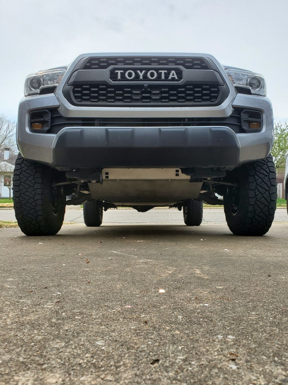

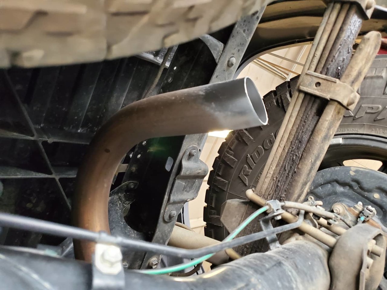

    Just got my reroute and axle dump done today. $314 a bit high but best place in town and friendly. Performance Exhaust Evansville, IN. I'm happy with how it turned out. Now to get my Budbuilt built skids on this weekend. (Poorly painted)
    IMG_20200323_114842_717.jpg IMG_20200323_114842_725.jpgIMG_20200323_114842_718.jpg IMG_20200323_114842_725.jpg IMG_20200323_114842_733.jpg 20200323_115451.jpg

    Old Man BP51 coilovers Dakar HD leaf springs Icon Delta control arms TRD Pro rims with Kenda Klever RT 33x10.5 tires Exhaust mod TRD front skid, RCI tranny and transfer case skids Southern Style Slimline front bumper Baja Designs S8 bumper light Warn Zeon Platinum 10s winch 4.88 Nitro gears ARB front locking differential ARB twin air compressor X2 Power 27 battery RCI rear bumper with Rigid SRQ lights RCI rock sliders RLD canopy Dometic CFX3 55 refrigerator TRD Pro grill Front & Rear anytime camera Seat Jackers Diode Dynamics Pro fogs
    Is it just me or does the exhaust head back towards the front of the truck before it curves back to the original exhaust pipe? If so your restricting your airflow. Doesn’t look like a well thought out job if I’m seeing that correctly.
    HighCountryTacoma likes this.
  10. Mar 23, 2020 at 7:13 PM
    #450
    Chaury08
    Chaury08 Active Member
    Jul 17, 2017
    #224247
    40
    Corey
    I does slightly but not much

    Probably just looks worse than it actual is. Nice mod though. I don’t scrape nearly as much as I use too. Still can’t believe Toyota hasn’t redesigned this yet.

    Maybe a bit but could be photo but best shop in town who has done some amazing work so I trust him. No change in around or performance I have noticed.

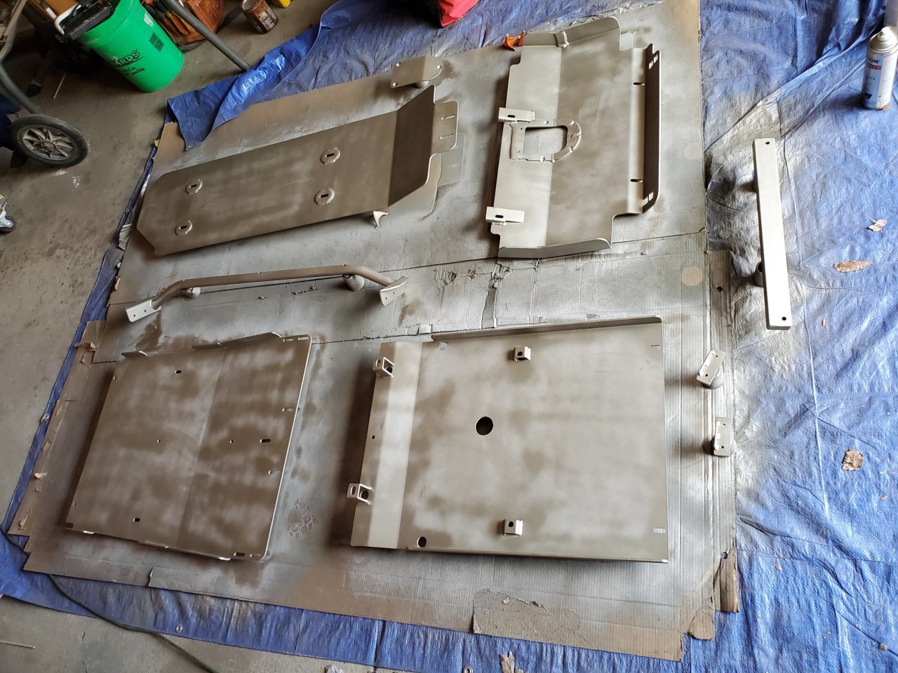

    Got my Budbuilt skids on. 20200327_154822.jpg 20200327_154909.jpg 20200328_155154.jpg
