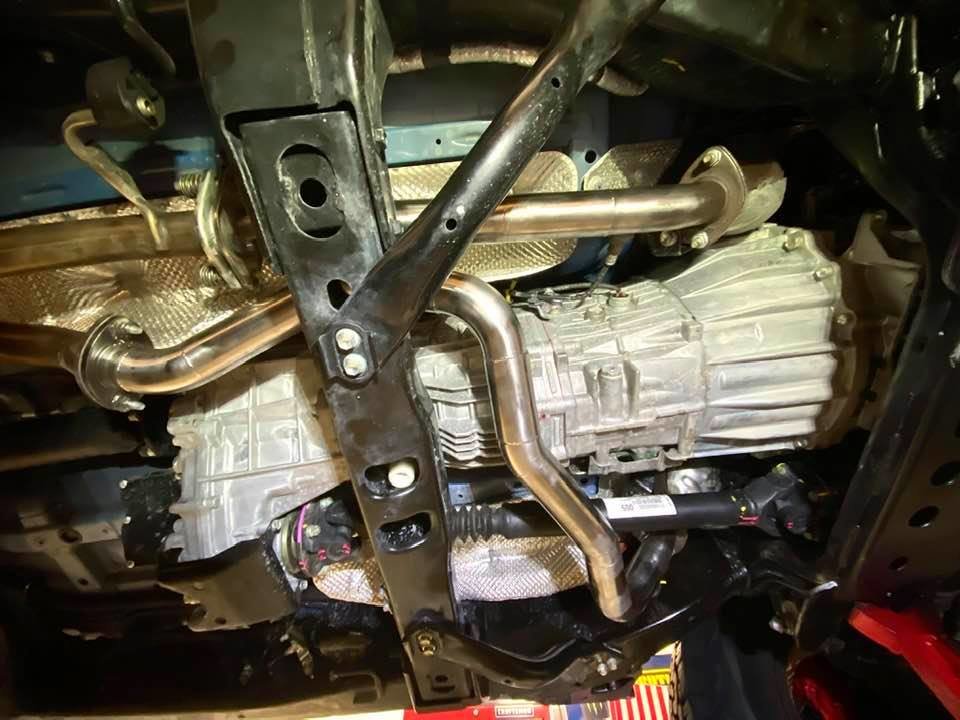

    just finished mine up. did it a little differently than what I've seen on this thread but I'm super happy with all the clearances, all mandrel bent 304SS, I made it so it's a "bolt-in" to the manifold and factory Y pipe.
    I made sure to keep the pipe far away from both the u joints and the "extendy" portion of the front driveshaft boot, while also making sure it wont get in the way of draining the trans.

    Looks good, how much clearance is there for the front drive shaft above the pipe? Enough space for maximum downward extension of the front suspension?

    I didn't measure, but somewhere around 1.5-2" to the driveshaft.
    since it's still IFS, the front driveshaft movement is minimal (basically none only based on bushing compliance of the engine/diff)
