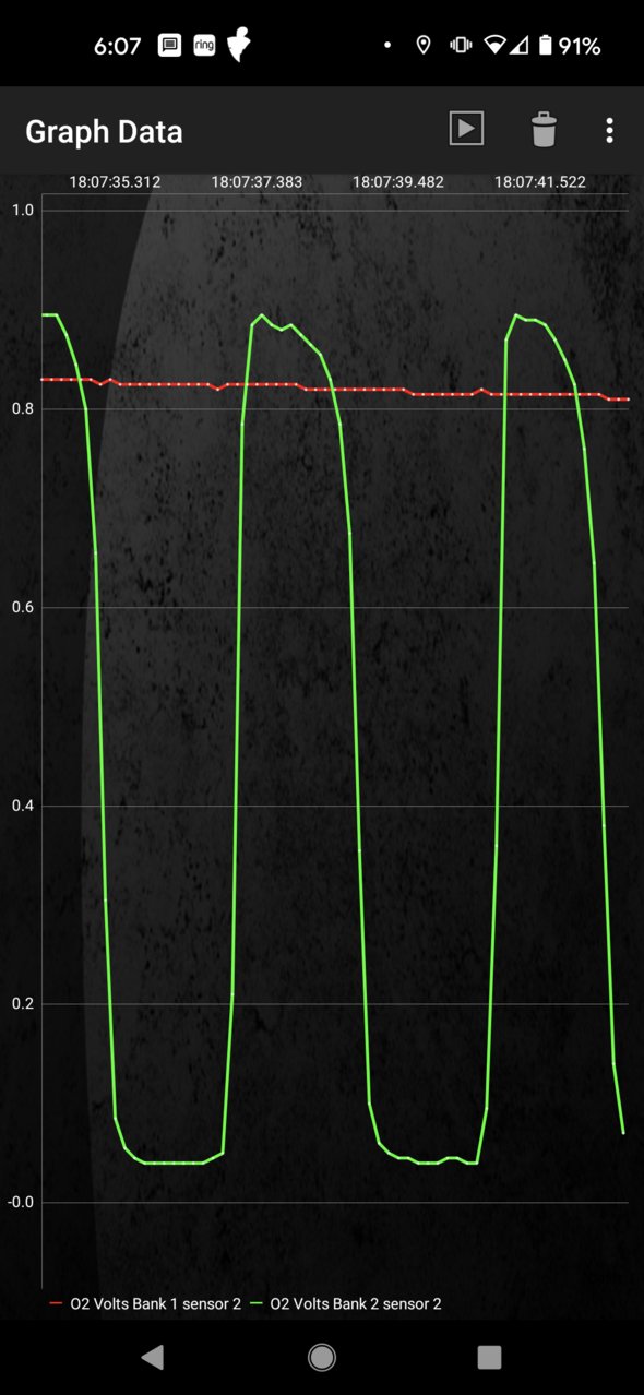

    Starting to think it might be the catalytic converter. Temps seem to be the same side to side but when I revved the throttle a couple and watched the voltage each downstream o2 sensor was differnet. Graph of it is belowScreenshot_20210228-180742.jpg

    This makes me think even more that it's a leak. That graph indicates that your switching frequency is high (1-2 seconds) when it should be at a low switching frequency (~25 seconds). I'd be very surprised if it was the cat. It's too much of a coincidence. It's bank 2 sensor 2 so it's the sensor right after the drivers side cat; which I'd assume is where your guy was fooling around. O2 sensors are incredibly sensitive; a pin whole is enough to do it. That being said, check the heck out of that sensor to make sure he didn't damage the wires/make sure it's screwed on tight.
    Edit: Just had a thought. Do you know if he dropped the exhaust completely or was lazy and welded it while it was still mounted? Shot in the dark but if he just shoved the stinger up in there then the part of the weld you can't see (the top) could be incomplete. If it's absolutely positively not a leak then the next step would be to replace the sensor. Then, go get your money back :rofl:
