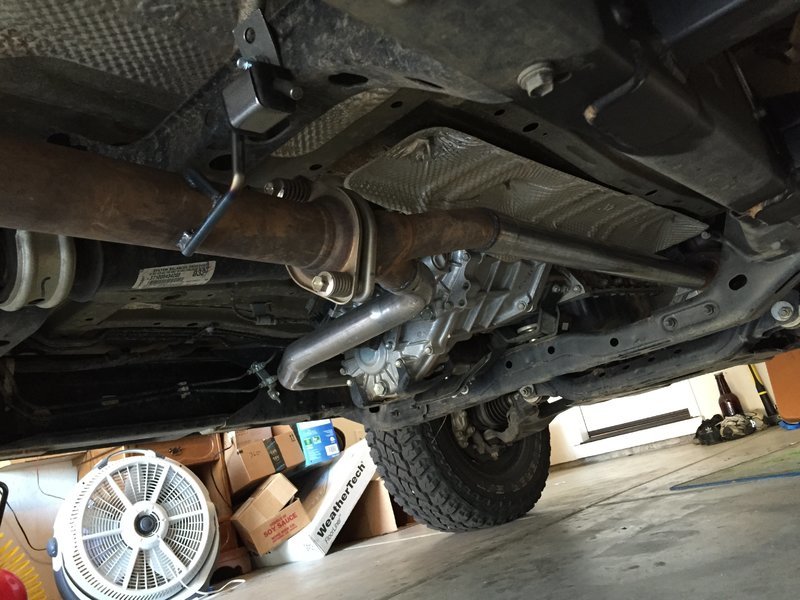

    Here is a pic of mine. Cost me 160 bucks for the reroute, to have a muffler welded in and to chop my tailpipe.

    #186817

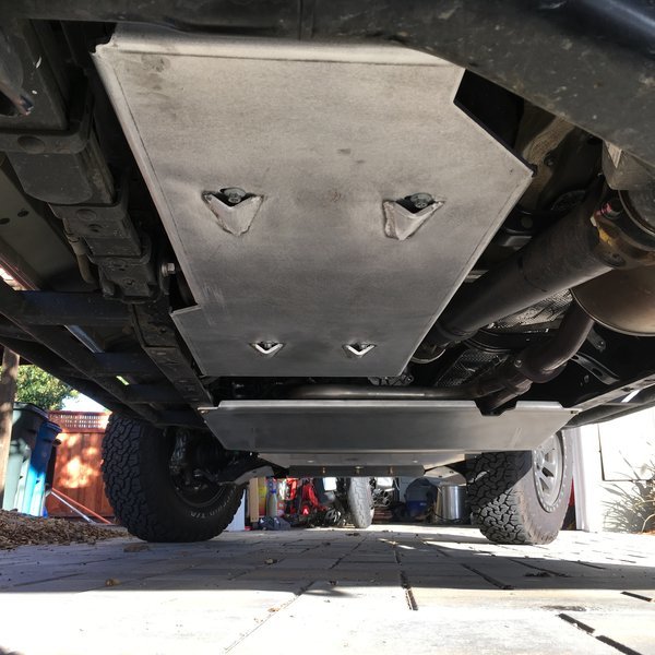

    They make both options in either steel or aluminum. I went aluminum.

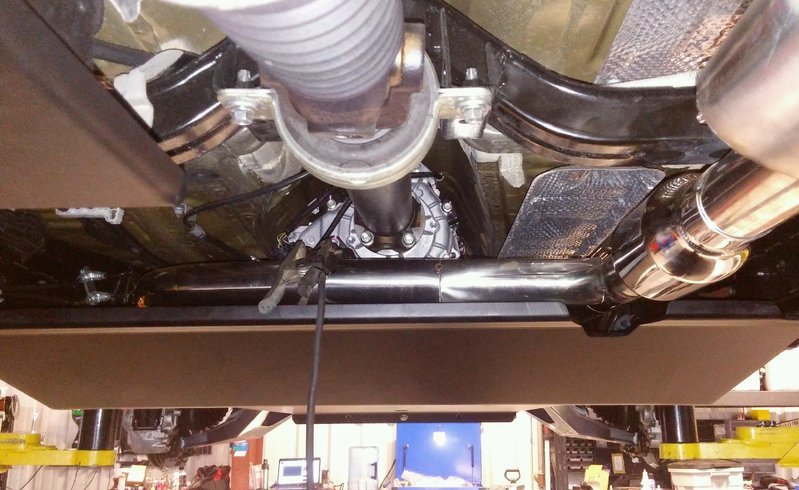

    Ran the re-route for the Pelfreybilt skid
