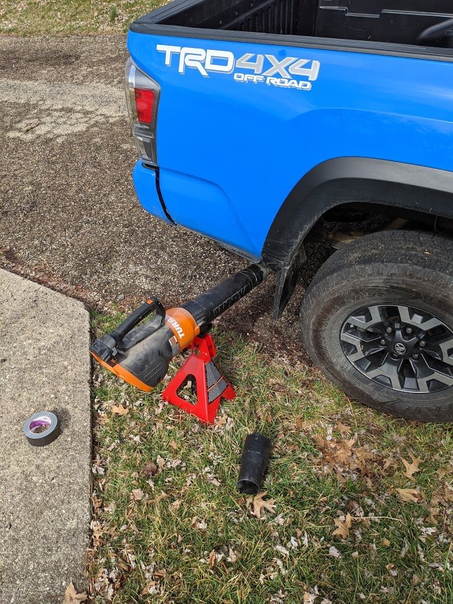

    So I ended up figuring it out and it was an exhaust leak, just not where I thought it would be. I ended up taking it back to their shop telling them I thought it had an exhaust leak. They looked at it and told me they thought I had a bad catalytic converter. I've never heard of a cat going bad after 18k miles so I wanted to take one more dive into it.
    Instead of running the truck, I used a leaf blower taped to the exhaust outlet. Then I sprayed soapy water all over, from the header down. Doing it with a cold exhaust let me really get a good look without it evaporating off.

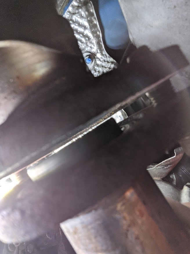

    I had been thinking maybe they cracked part of the exhaust up in the engine bay. After spraying everything I saw some bubbles on the flange between the first cat, and the second one on the drivers side.PXL_20210317_160713420.jpg
    So I got to looking at it and figured maybe they broke or damaged the gasket. So I went to take a peak at it. Turns out, they didn't even re-install the gasket! It was completely gone. So I popped on over to the local parts counter and got a new one and installed it. Cleared the codes and did a bunch of driving. No check engine light! Finally got it fixed.

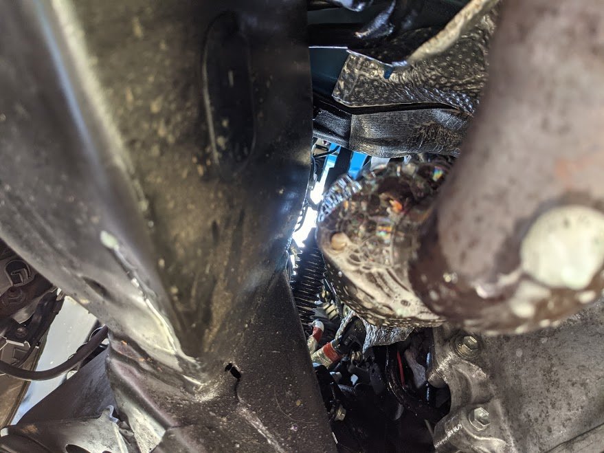

  7. Mar 19, 2021 at 4:11 PM
    #587
    Bertw192
    Bertw192 Well-Known Member
    Aug 3, 2017
    #225852
    14,456
    Bert
    Seattle, WA
    2017 TRD OR DCSB
    All the things!
    Nicely done! Did you report back to the shop to let them know they made a mistake? As a manager, I'd like to know when my employees fuck up.
    Also, put that leaf blower on the intake line for some true power gains :burnrubber:

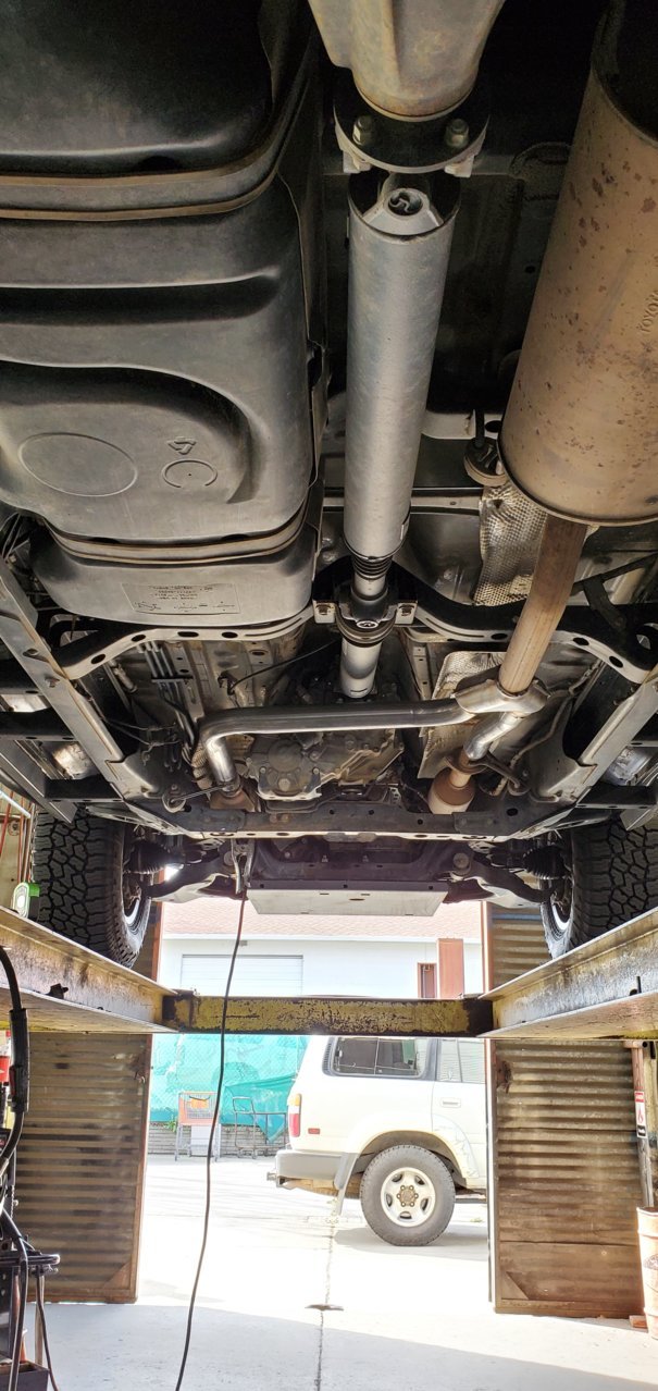

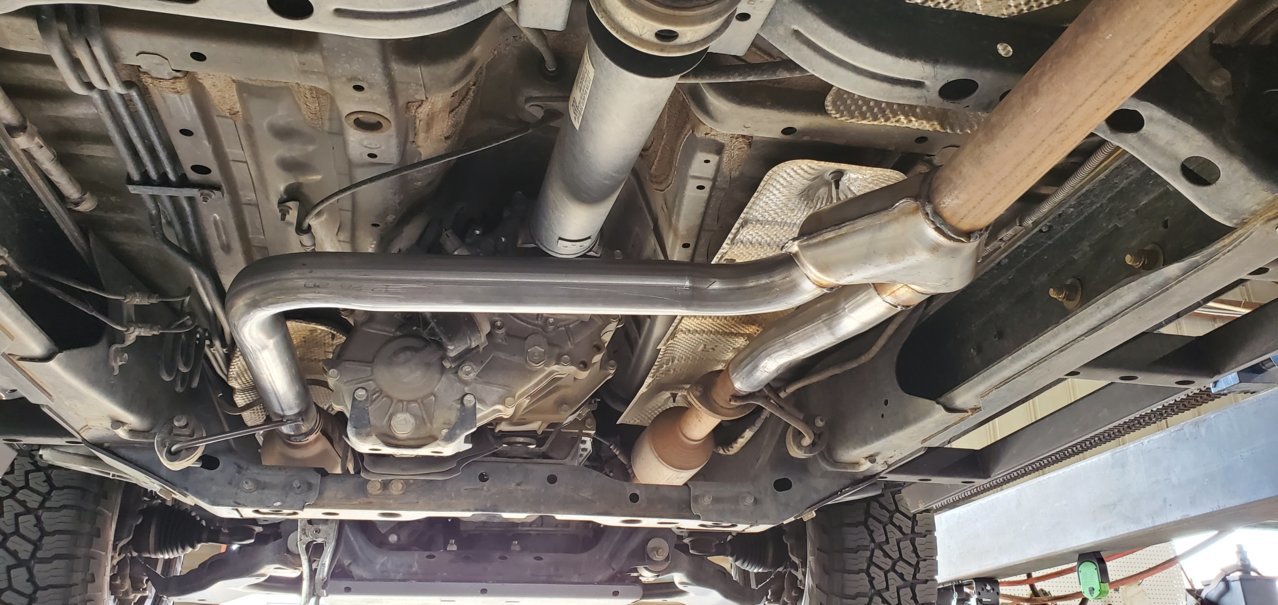

  15. Mar 24, 2021 at 11:33 AM
    #595
    TnuggetTaco
    TnuggetTaco Active Member
    Jan 18, 2019
    #279780
    31
    Sacramento
    2014 Black Tacoma TRD Sport
    - Method 701 (Bronze) 16x8 0mm offset - Falken WildPeak A/T3 265/75/16 - Ultimate Headlight Upgrade - BAMF Bolt On Sliders - BAMF Skid Trilogy - SoftTopper (Tan) - Desert Does It "Seat Jackers" - Desert Does It Molle Panels -Tech Deck (Heavy duty)Center Console RAM Mount Bracket - Misc Phone &Tablet RAM mounts - WeatherTech Floor Mats - Exhaust ReRoute
    Got the exhaust rerouted on my 2014 today. Was $200 at Muffler Express in West Sacramento and took less than an hour. Doing the reroute on 2nd Gens is definitely a little harder than the 3rd Gens due to the layout. I couldn't find a thread this active for 2nd Gens, so I figured posting it here would be helpful for future 2nd gens getting it done. I'm very happy with it. Got Full BAMF trilogy going on tonight.

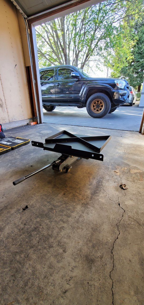

  17. Mar 24, 2021 at 12:23 PM
    #597
    TnuggetTaco
    Jan 18, 2019
    #279780
    31
    Sacramento
    No problem. I'm glad it helped someone so quick!

  19. Mar 24, 2021 at 5:04 PM
    #599
    TnuggetTaco
    Jan 18, 2019
    #279780
    31
    Sacramento
    Yah, they're BAMF. And yup got my drill out ready to go hahaha. About to start the install right now.
  20. Mar 24, 2021 at 6:11 PM
    #600
    Otto-x
    Otto-x Well-Known Member
    Aug 25, 2019
    #303318
    146
    Seattle, WA
    2021 Cement DCLB OR
    I would love to see an install thread with pics on the bamf skid set
