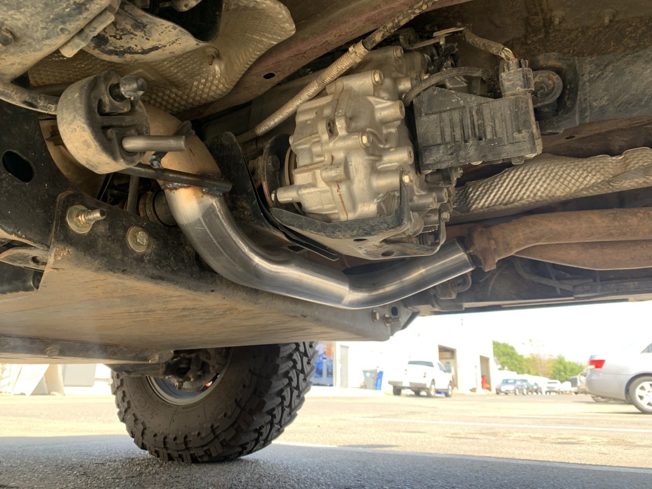

    Just got mine done today at Muffler King in Kirkland. Ended up going with the tuck method. The owner, Jorge, said it would be over $400 to achieve the images that I mentioned I would go for in my previous post since that would require more pipe pieces and a Y-piece. He troubleshooted with me to keep the labor under the originally promised $190. No additional wrap or heatshields used.
    With my RCI aluminum transfer case skid installed. There's about 1/4" of space between the pipe and the skid.
    No codes or issues yet. I'm a happy customer so far. Once we settled on an approach, it only took him about 40 minutes to do the work. Bill was about $190 before discount. Avants members get 15% off but he ended up giving me 20%. I would recommend them to any in the Seattle area looking for an exhaust reroute.
    dmca, MinesBroken, Kolter45 and 3 others like this.

    That looks great. $190 doesn't seem bad after hearing quotes from other shops in the area.

    Is that a better location for the tuck? Will the exhaust burn off the powder coat on the skid plate by being that close? I notice on this location the transfer case actuator is safe from excess heat so the trade off is probably worth it

    This is the stock location just up higher. IMO it is superior to wrapping the pipe around the back of the tcase by the actuator.
    Also...powdercoat cures in an oven so no harm by being close to the pipe.

    Yeah, I showed him your pictures and that was $400. I'm not familiar with which skids you have but if it's the two bolts that go straight towards the rear from the cross member, I believe there is at least a few inches of space. The bend in the pipe starts more to the center of the truck and angles away from those bolts.

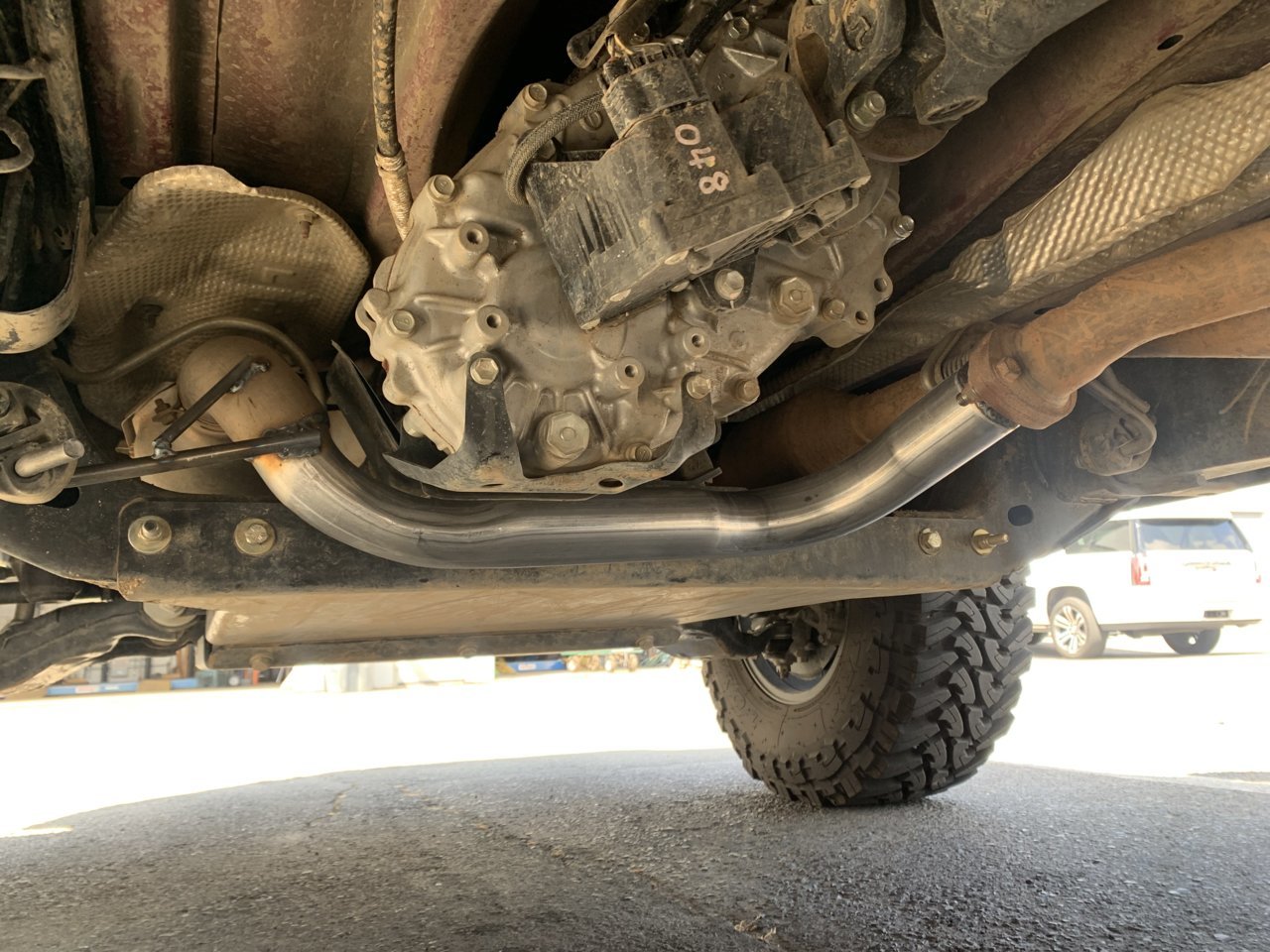

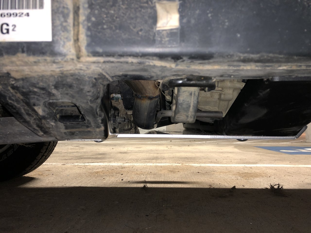

    Dropped off my truck and BAMF transfer skid at the exhaust shop for the reroute. Showed the guy both reroutes, tucked up higher and around the actuator. Said tucking up higher shouldn’t be to bad.
    quoted me $150. I’ll post some pics when I get my truck

    Napa Valley Muffler for those of you in NorCal/ East Bay. $150

    Looks great and awesome price too!

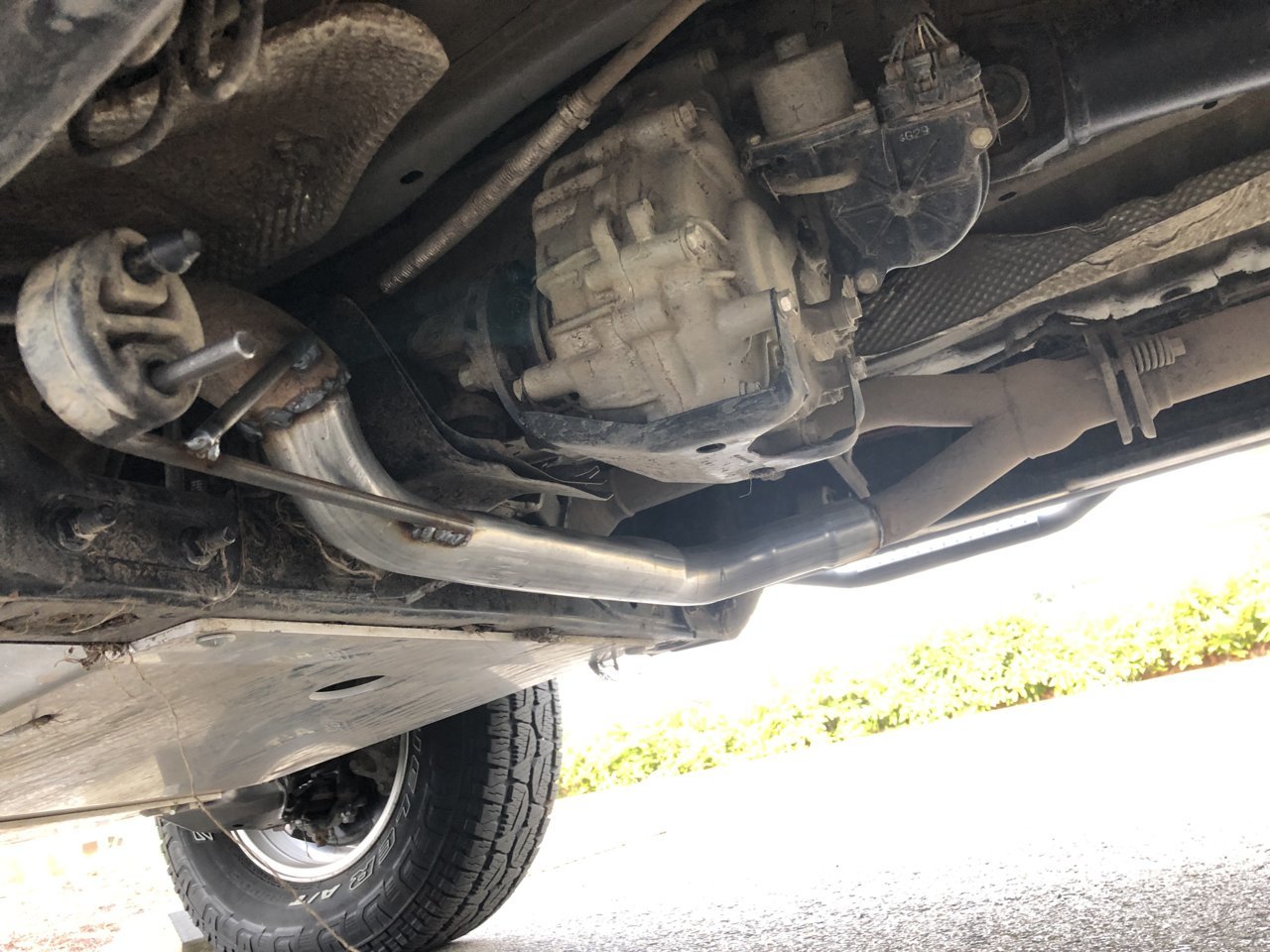

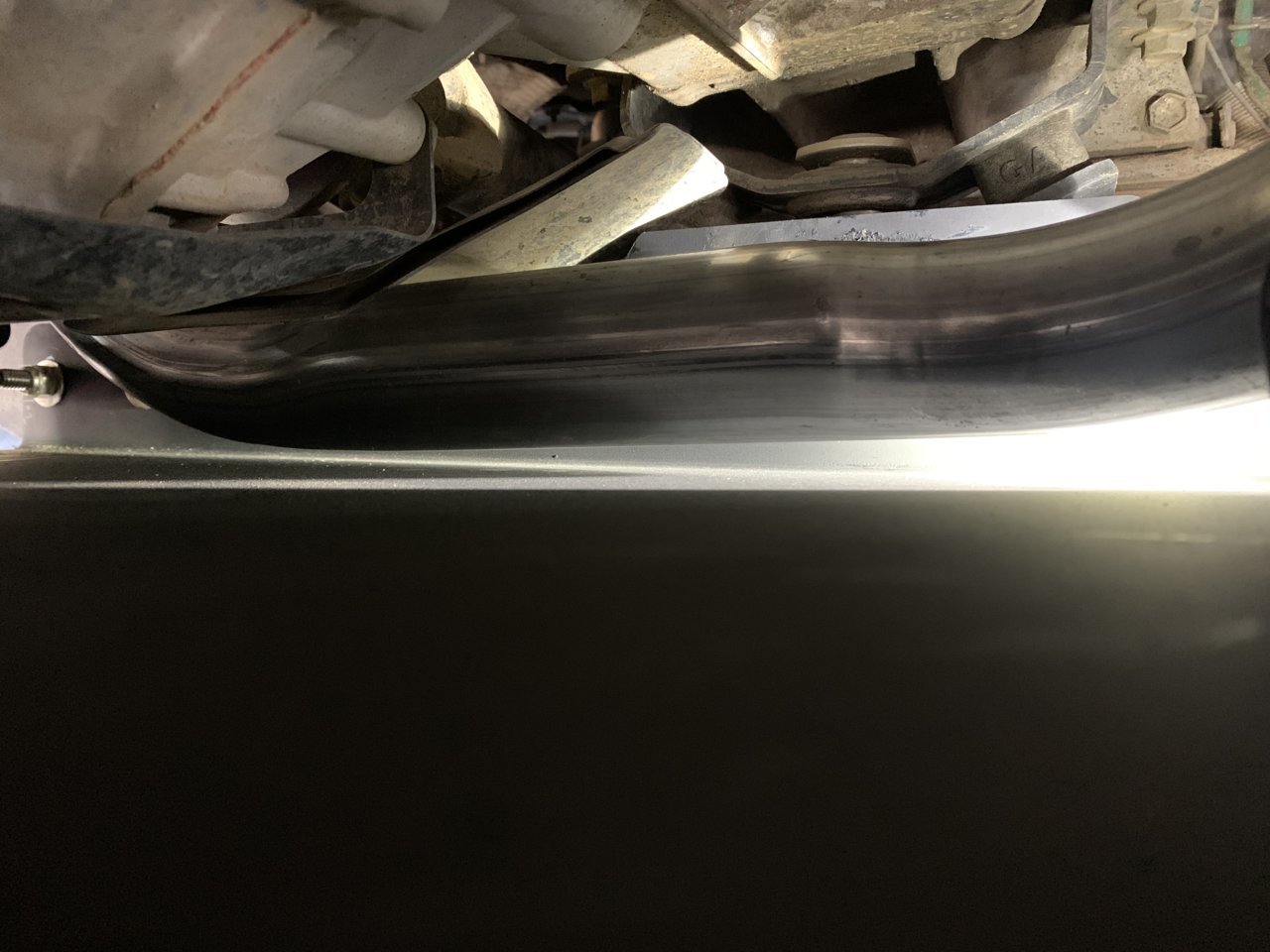

    Plenty of clearance with the skid on
