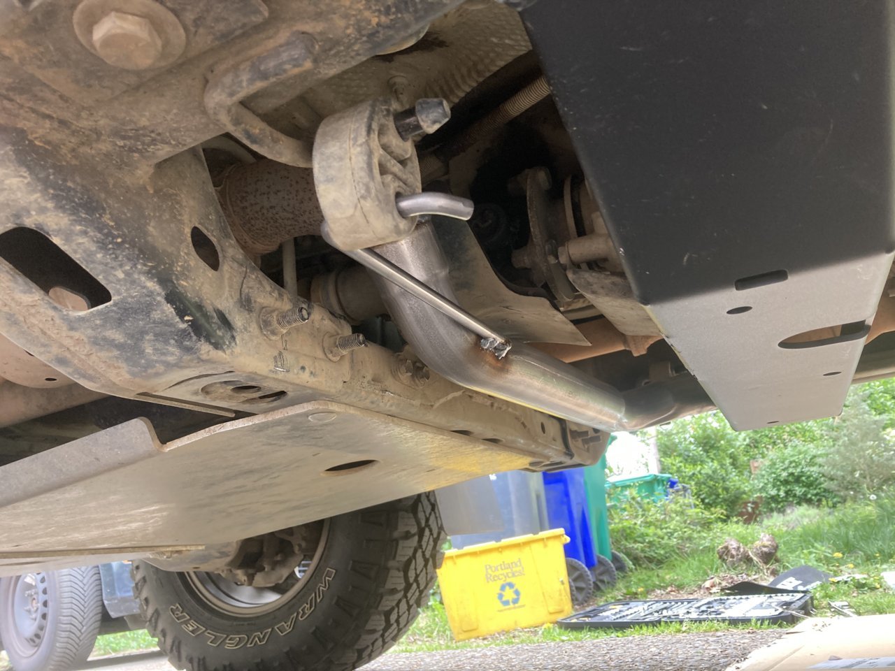

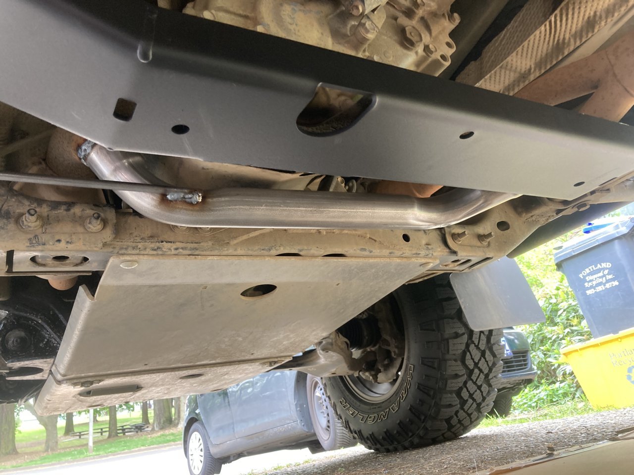

    Darrel’s economy mufflers on 82nd in Portland did a great job on mine. $75 for the tuck method in about half an hour. Clears my RCI skid just fine.
    he knew exactly what I was looking for. When I told him what I wanted he said “oh another one of those” and immediately went to work on it.

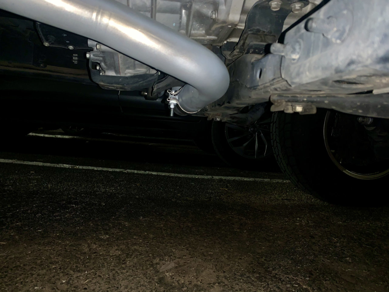

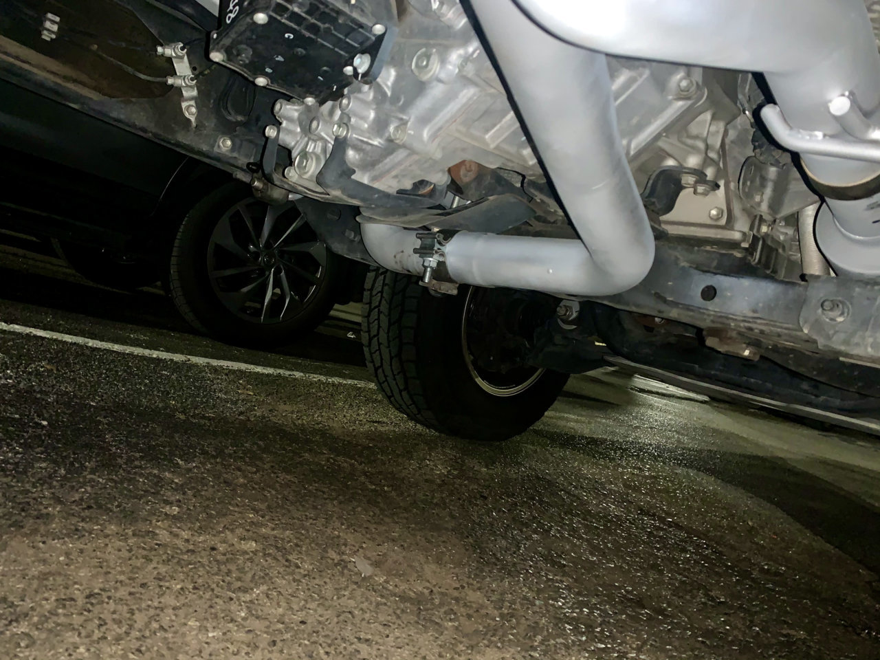

    I had been meaning to do the reroute for quite a while now but ultimately settled on the AFE Y-pipe with high-flow catalytic converters. I was pleasantly surprised not only at the quite noticeable improvement in response (I had catless OVTune dump tubes that I removed and replaced with the stock catted down pipes) but also AFE was smart enough to create a Y-pipe that sits up where a reroute would so that it is only slightly below the bottom of the cross member, very close to the transfer case guard - so close in fact that the clamp was vibrating against it - I had to adjust it.
    Just a bit of info if anyone was looking for a bit more sound (and performance?) and better placement of the exhaust than just a simple reroute would get you... for quite a bit more chunk of change if you want to thin the wallet...
    (even though the AFE is stainless, I still sanded and ceramic coated - if you're wondering about the color)

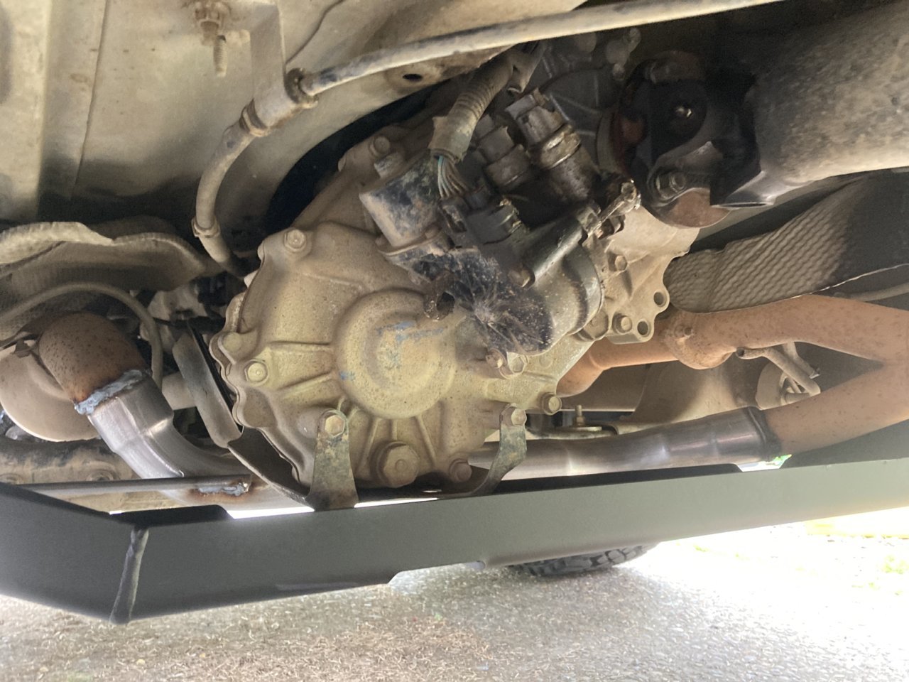

    Got her done. A&A Performance Muffler & Brake in Englewood, CO. Quick and painless. $181 out the door.
    Before:
    After:
