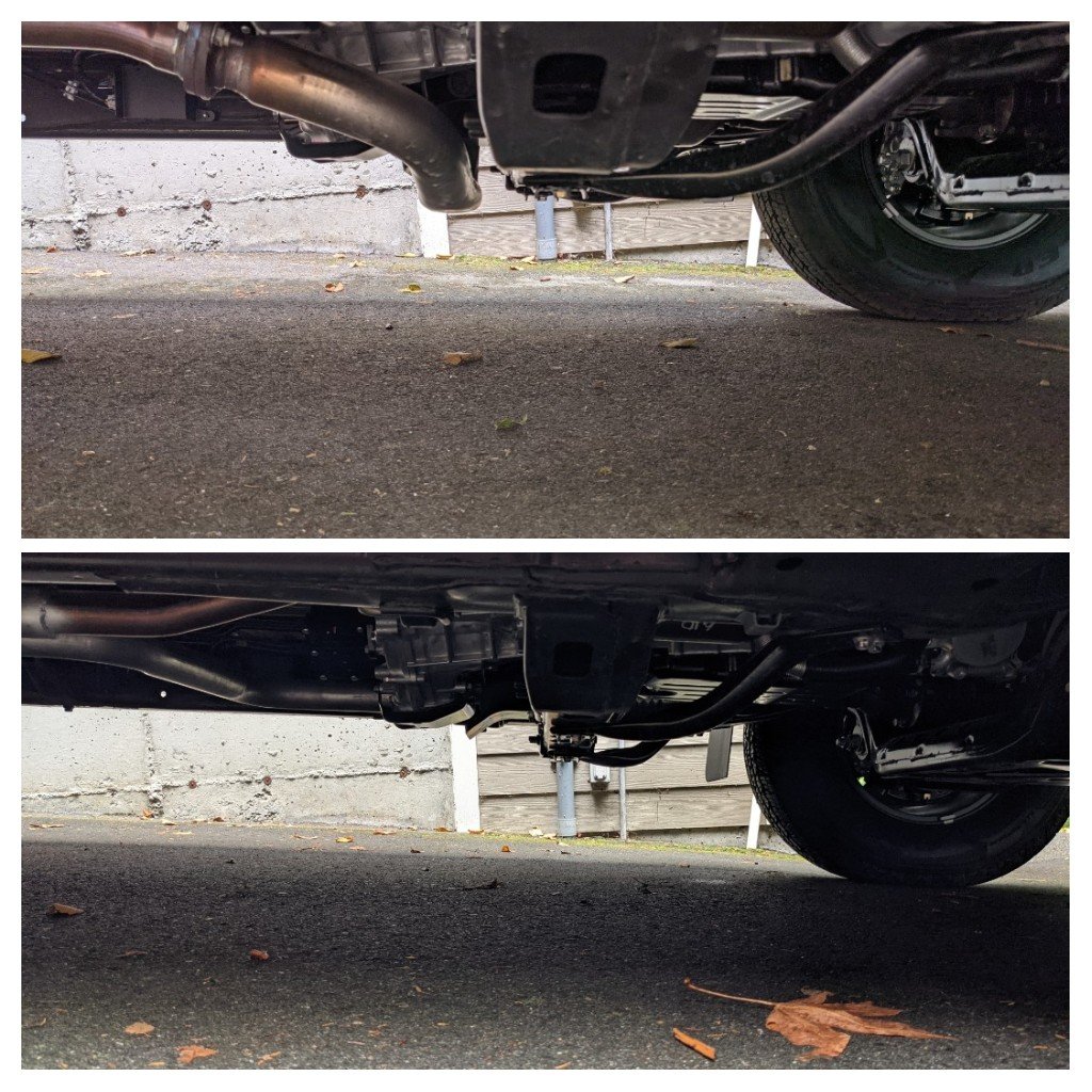

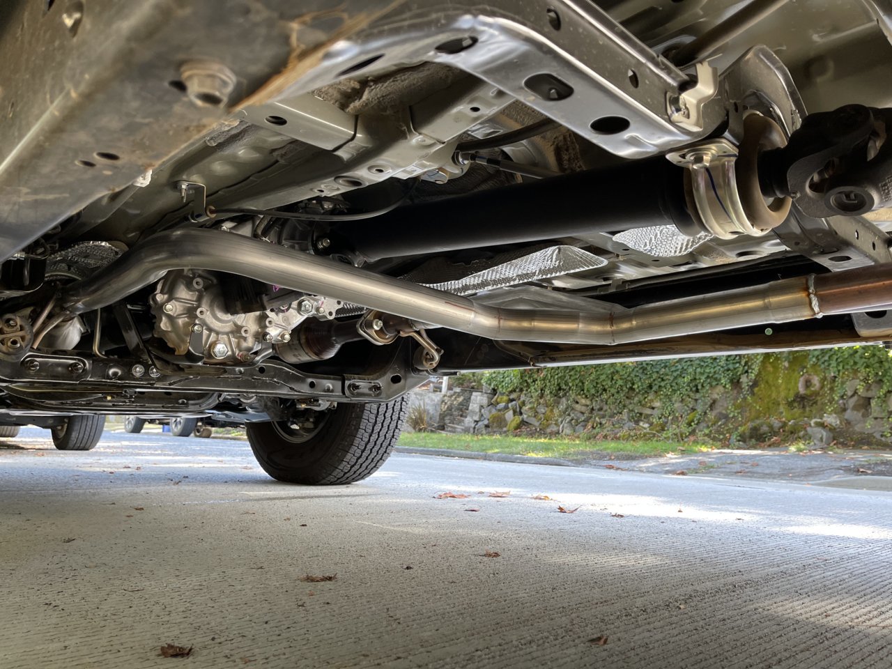

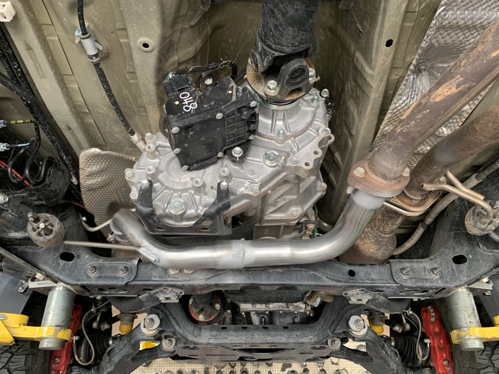

    $220 at Airport Muffler in Snohomish.PXL_20210922_010025562~2.jpg PXL_20210926_171611384.jpg 20210917_163224-COLLAGE.jpg

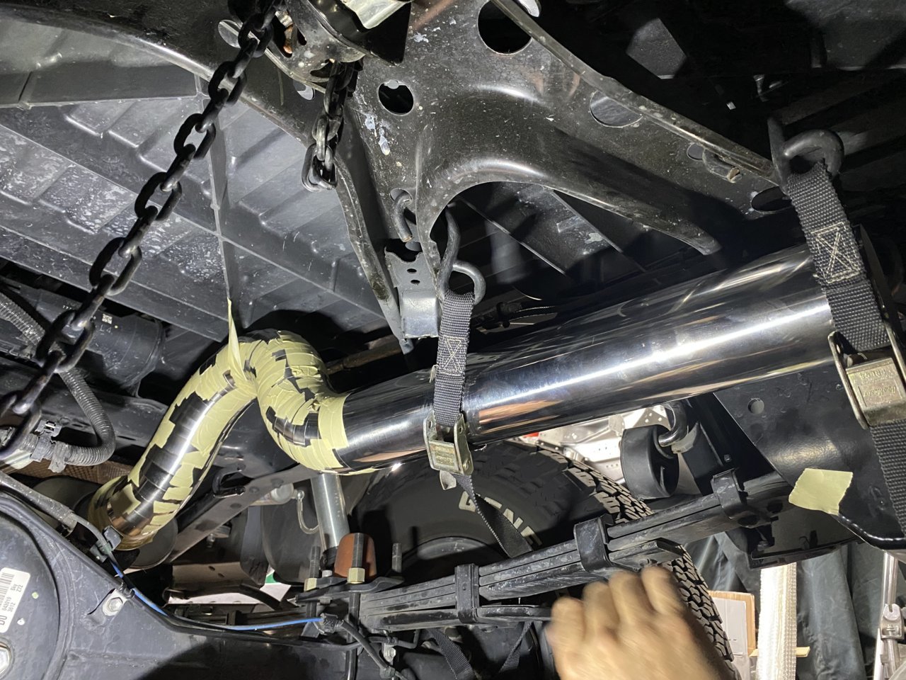

    Got some stuff in the works for my exhaust…

    That's a lot of pie cuts. You are a masochist. :rofl:

    Anyone in the L.A Area, I can only say great things about the guys at Pibe's Auto in Van Nuys. Did the tuck method for the reroute, and chopped my tailpipe adding a short extension to ensure my spare was not @ risk of melting. $150. Had the truck on the lift within 10 minutes of quoting me. Took a few hours but only because he bent 3 different pipes to get the reroute just right.

    As nutty as I thought it would be. I thought I had a decent amount of pie cuts on mine, but you sir, take the prize.
