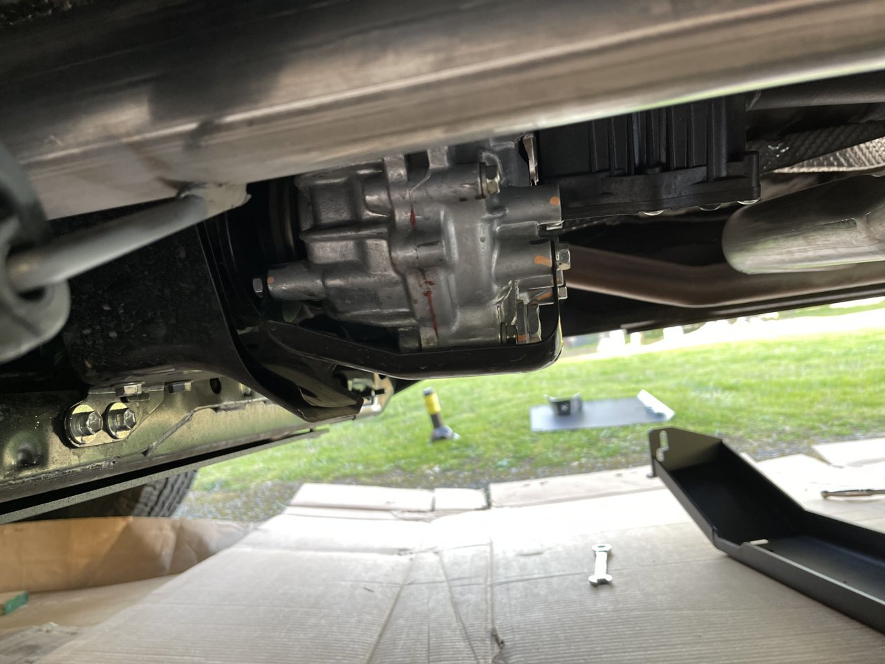

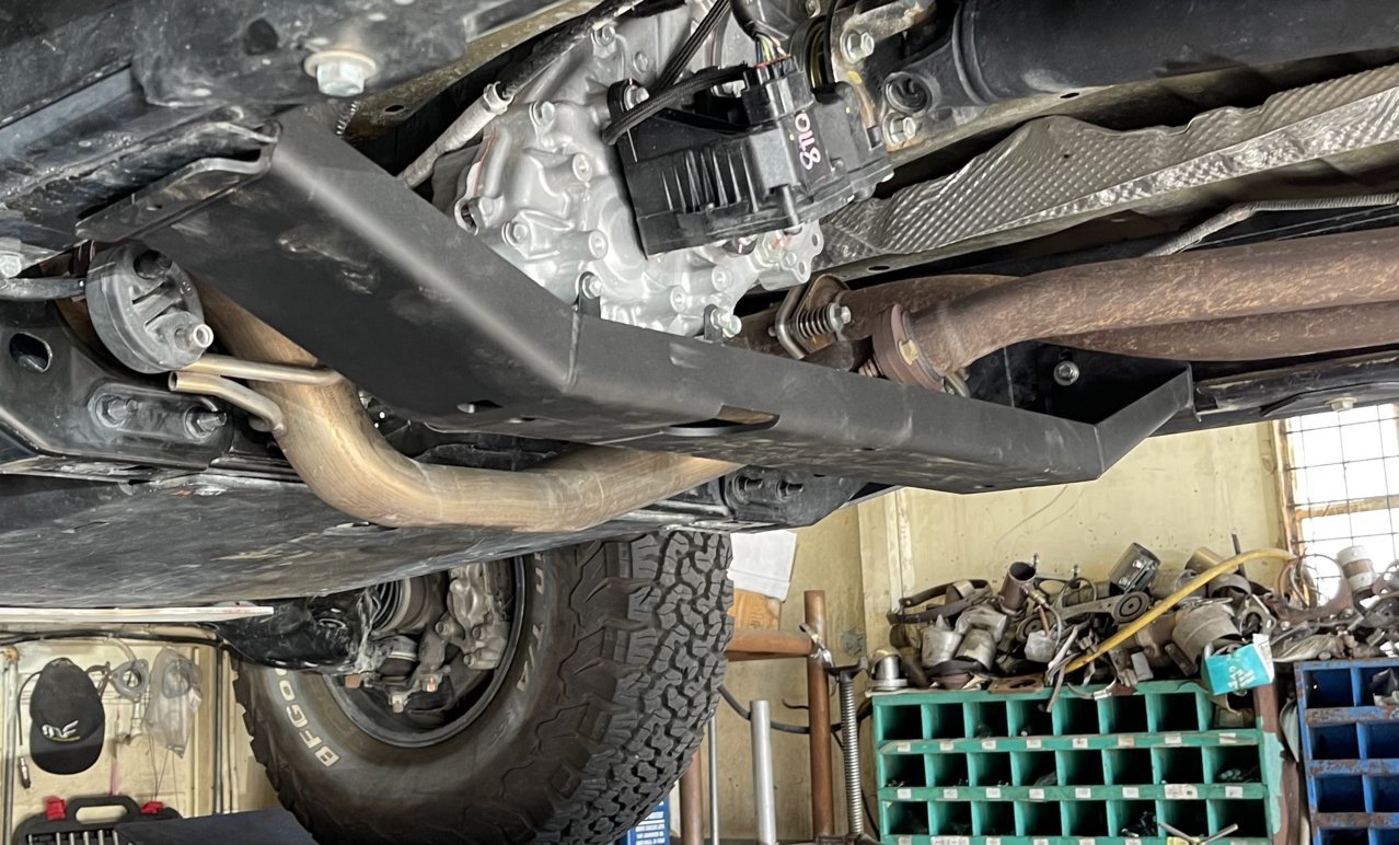

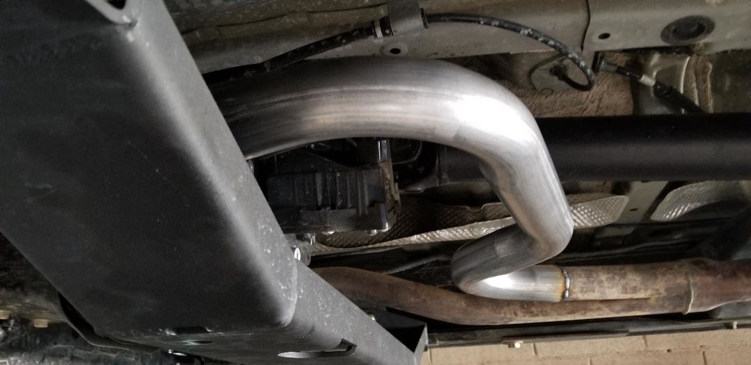

    Just got this done. Looks like it'll clear the skid plate but it will be close. I'll find out later tonight or tomorrow.
    Edit: RCI T-Case skid installed:

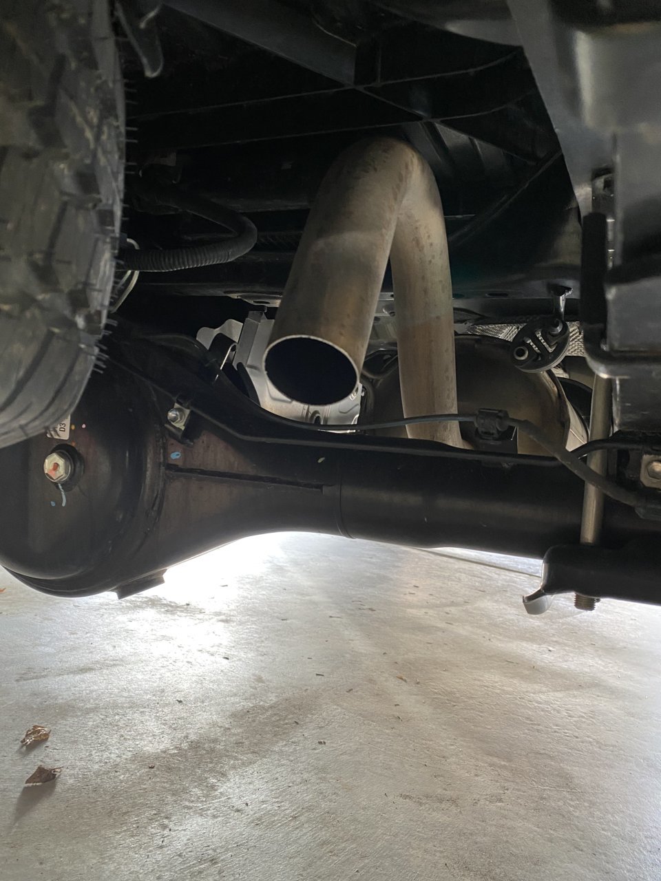

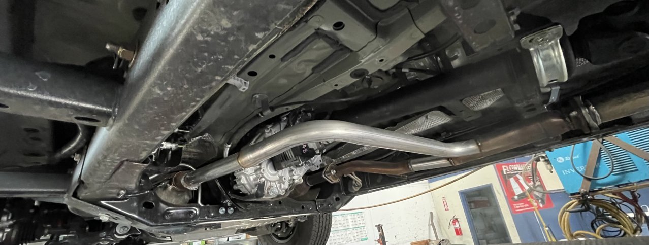

    Just got my reroute done to prep for RCI skid plate install. AA Muffler in Englewood, CO has done this a million times, and highly recommends routing underneath the existing heat shield vs any other option. They did a really nice job and also did the tail pipe chop free of charge. Cost was $200 after tax.

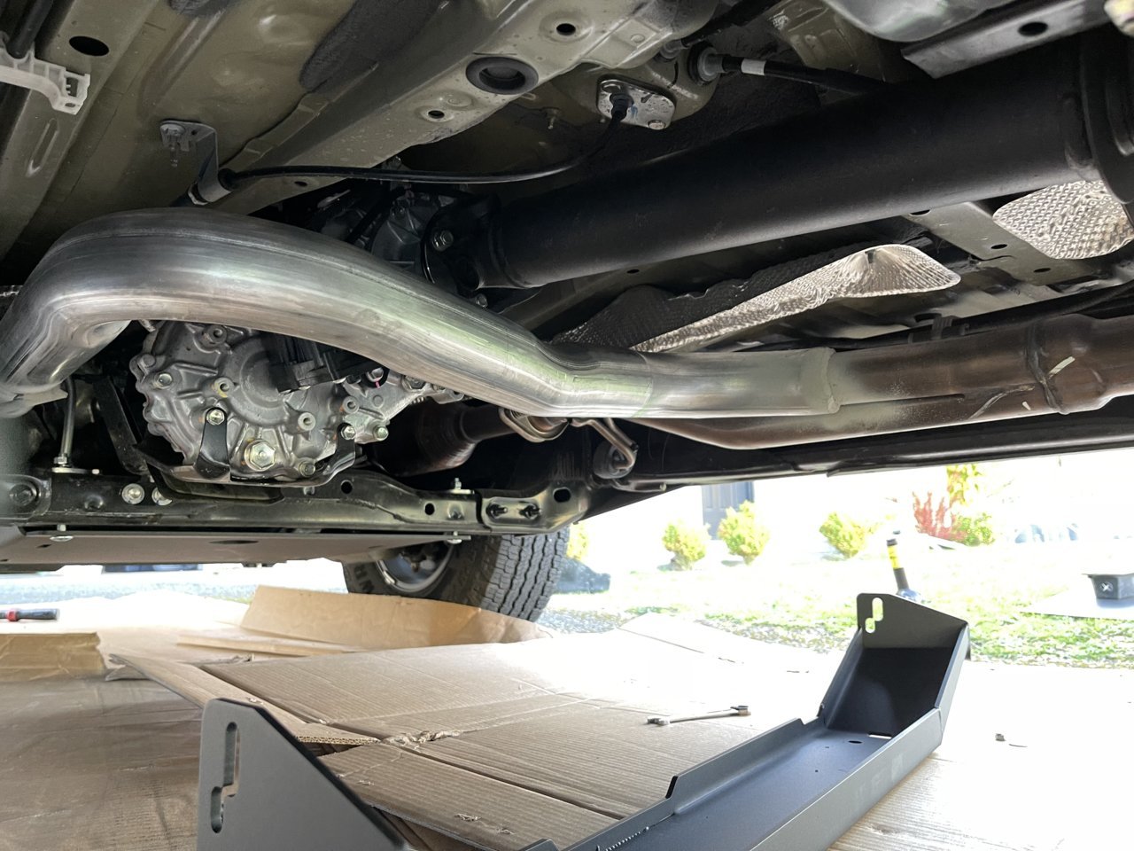

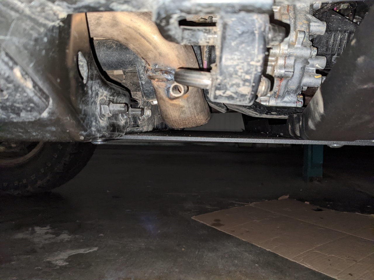

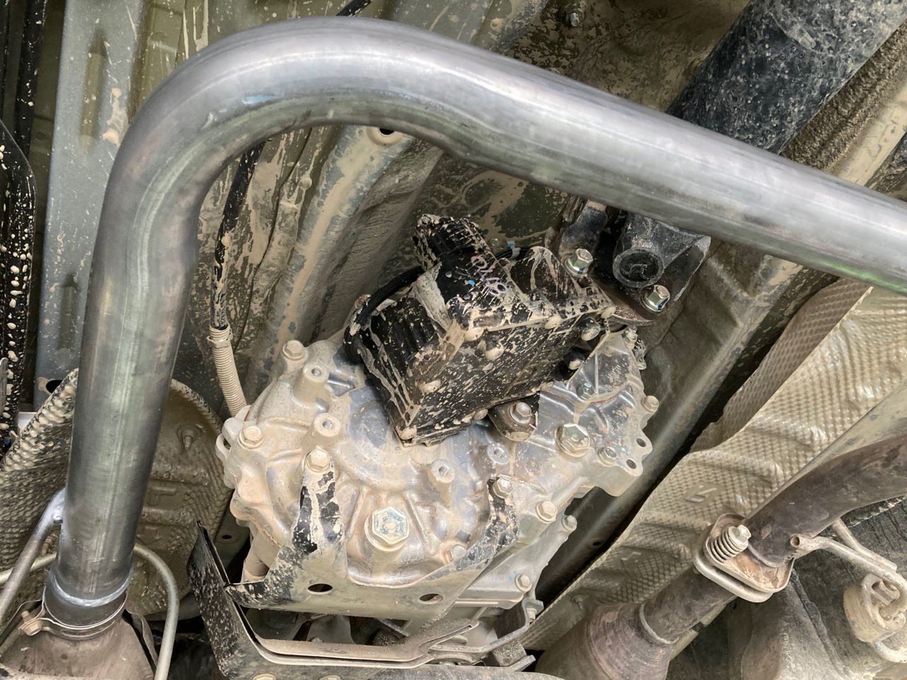

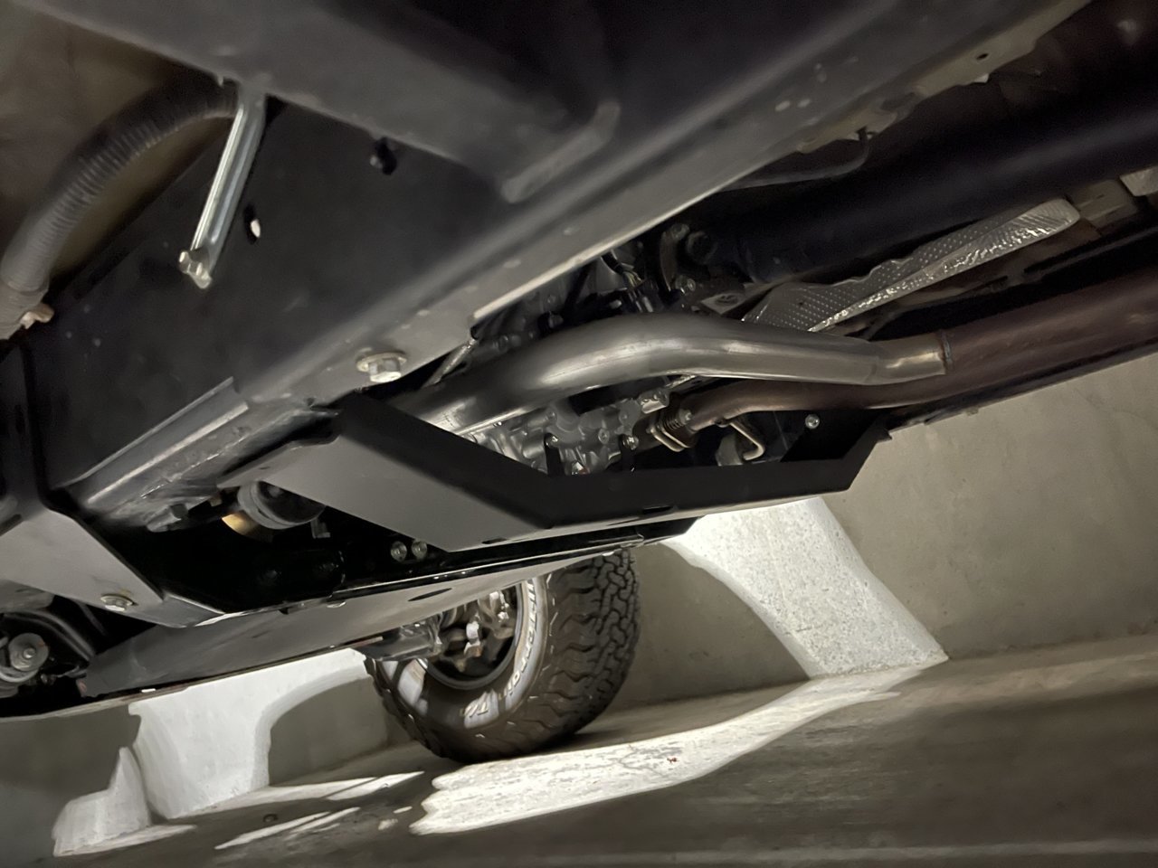

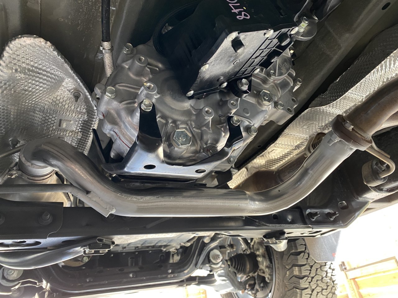

    I finally arranged to get my exhaust reroute sorted so that I can put on my RCI skids. Nothing too fancy, but it gets the job done. I had forgotten what a complete PITA it is to try to put skids on to a non-lifted vehicle with stock size tires. I feel kind of beat up today. Hahahaha…IMG_1355.jpgIMG_1355.jpg IMG_1354.jpgIMG_1366.jpg

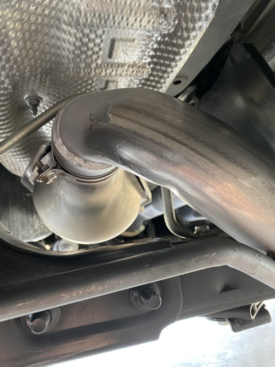

    wait. what did you do about the inner tubing?

    #419488
    6,172
    The exhaust reroute for me did not dive below but ran around the transfer case. This only makes a difference for the transfer case skid from RCI, not the transmission skid.

    #264205
    22
    That crossover tube is lined with a hear shield. So the actual exhaust tube is a much smaller ID than the OD measured in the non-crushed portion.

    157
    '21 DCLB TRD Off Road - Army Green
    No idea.. I asked for the shop to take care of it for me and they said they've done these a bunch of times before.
