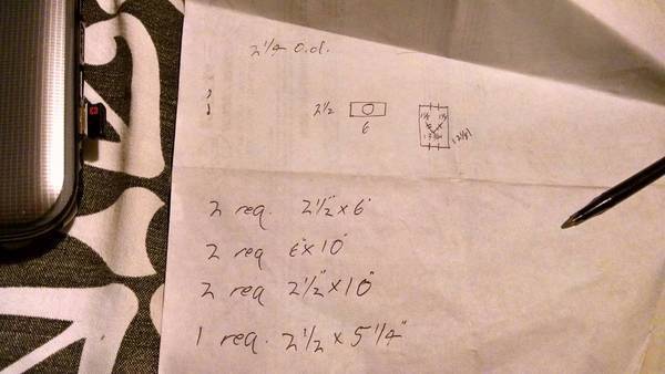

    all good things start with a plan!

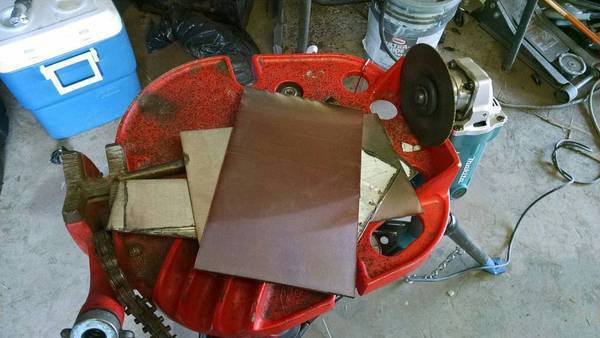

    correction: factory tubing turned out to be 2 3/8" o.d. my 2 1/4" hole ended up being long time with die-grinder
    then, cut pieces from the awesome cut-sheet attached to plans. I like using 10ga stainless in a brushed finish because it was easiest to grab from scrap bin

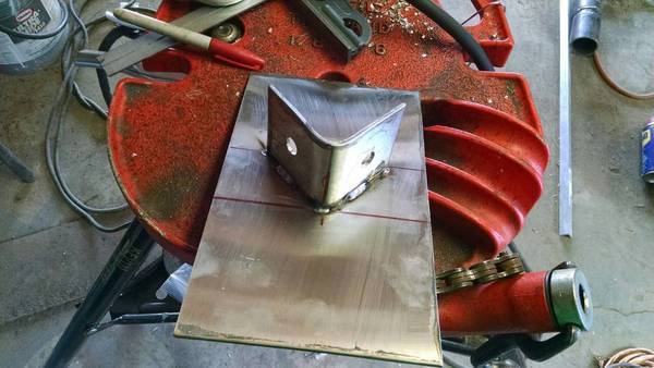

    weld in the super awesome baffle and make sure your aggregate area surrounding it will be bigger than factory tubing size. drill holes just in case.
    fit your top to your bottom via the "baffle". make sure they are layed out exactly the same so the rest of your muffler comes together. fitup should look like this

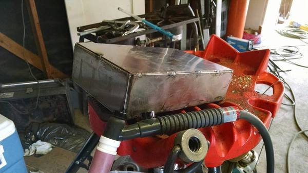

    weld your shit out. I didn't much care about tacks and my weld shows it. this is the worst of it. this is walking the cup

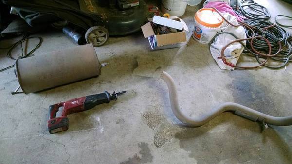

    great! now drill 2 3/8" holes in the ends in preparation to fit to factory pipe! after that, cut the big-stupid-muffler from your truck. cut the supports so that you can slide them out of the rubbers without harm. don't destroy the tailpipe, its nice to have for the new "muffler". and for the record, that's a hilti cordless recip saw. I don't mess around

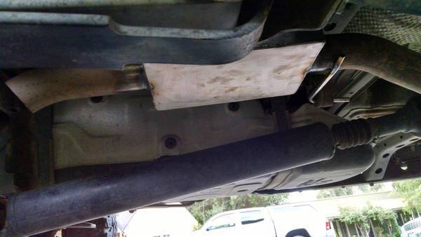

    yay, now frantically turn your garage upside down looking for a good support material. . . . I found some 3/8" stainless tubing. jack your factory pipe up a bit (it will flex at the collector flange for v6) and weld your support in. disassemble flange and weld your new "muffler" to factory pipe on the stand where its comfortable. add some tailpipe. rebolt flange together and let er rip!
