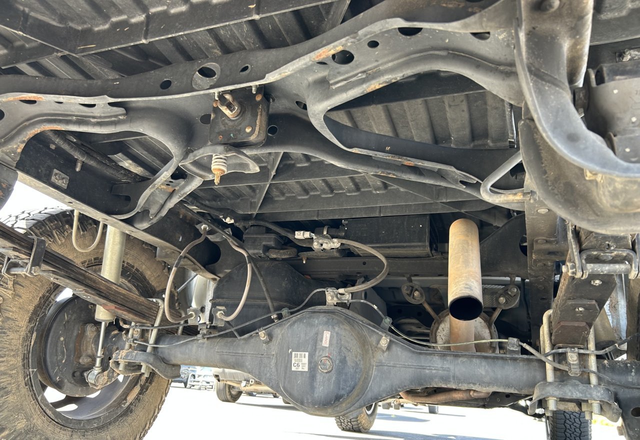

  6. Apr 16, 2023 at 7:52 PM
    Kwikvette
    Feb 27, 2019
    #284735
    81,825
    Fresno County
    4 run, 2 don't
    Granted this is a pic of my rear with the spare removed, my chop was closer and I never had an issue
