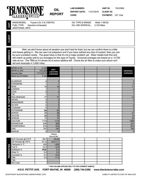

    When it is cold fill the radiator and the coolant jug to the proper line and mark it with a marker (if its not exactly at the line). Then after a day of driving and the engine is nice and warm the coolant level should have changed some. Mark that with a marker. If your concerned about coolant loss, every so often check your line when hot and cold. Does the exhaust ALWAYS have the smoke/mist your talking about? Does a puddle of water form under the tailpipe if you leave it idle for like 15 minutes? Does it do that in both hot and cold weather?
    Get under it, I always suggest when it is dark outside, with a flashlight and check every inch for any leaking. I suggest at night because it makes you concentrate specifically where your flashlight beam is focused. Thats just a personal preference.
    If the carbon filter has been removed from the intake, you WILL have a 'sulphur' type smell (from the outside) if you run it hard and have the windows down or floor it from 0-60.
    If you are loosing coolant and you find no visible leaks, possible issue is head gasket, but on a 2008, its highly unlikely. If you possibly suspect the head gasket, do an analysis, $28
    http://www.blackstone-labs.com/free-test-kits.php
    It's a cheap way to check for coolant in your oil. (If you change your own oil) Next time you change your oil after you remove the drain plug and the oil starts pouring out wait a few seconds then put a CLEAN glass jar under it and collect a few ounces of oil in the jar, then let the rest go into your drain pan.
    Put the sample in the container and ship it to the lab. I'll post pic of results I just got from the lab. I had my head gaskets changed and I know they are leaking, dealership ran tests... test came back as no problem! Sent sample to the lab.... see results :)
