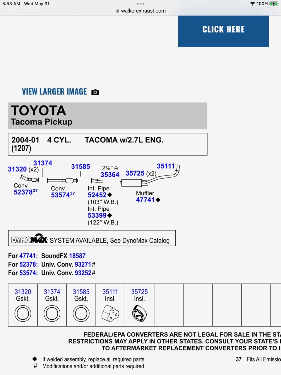

    How did your flanges fit together? I used the Walker 31585 flange gasket and it seemed a little large. I cranked it down with an impact gun and it isn’t leaking but I could see how it might. I used the impact on the muffler clamp and that’s sealed good too.

    There are different gaskets at different places .
    What joint was that I could go look but 31374 comes to mind correct 2 1/4" diameter
    I think 31385 is the one that goes at the crossover pipe on the3.4 It is larger in diameter.2 3/8" diameter.

    I think you’re right. The Walker website says 31585 but it’s definitely too big. I’ll try the 31374
    Edit: I just fished the old one out of the trash, it’s 2-1/4”

    Web sites do make mistakes .
