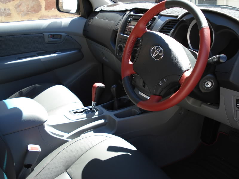

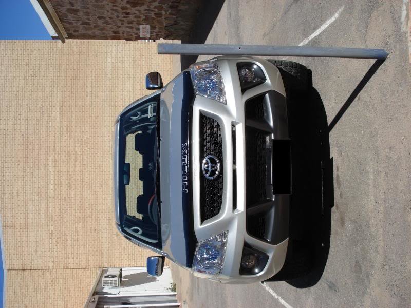

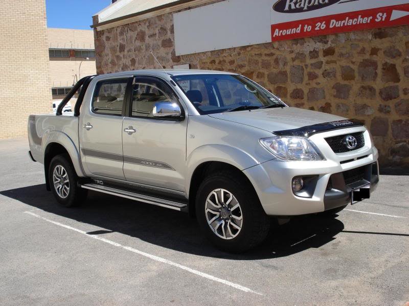

    Thankyou for your help, much appreciated. Here are some pics of my car.

    Wow thats sweet! I wonder why toyota america wont put something like that together (Super charged with a manual stick for 4WD) looks like you got leather in there too!! I hope Toyota makes the right move one day and figures out they should have a model like that for us here in the states. sorry to rant thats a killer truck.

    Nice truck! Really hot looking. Too bad they put the steering wheel on the wrong side. :D

    That's a sweet truck, so I hate to tell you - your steering wheel's on the wrong side. I bet you could take it back and get another one if it's still under warranty.

    That is one nice looking truck good luck with :D
