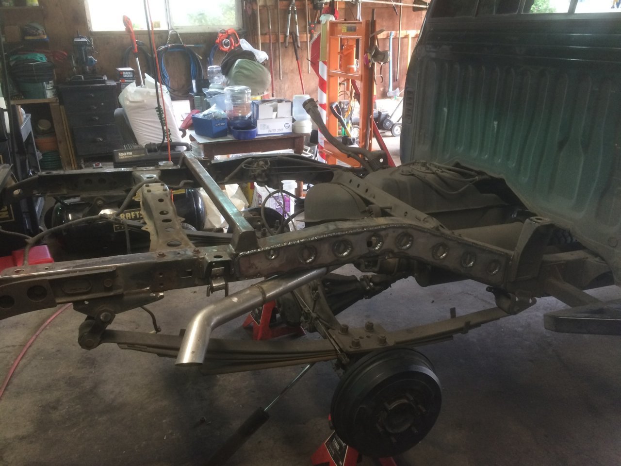

    What, this little thing?

    Ah the old water heater, yeah that POS takes up way too much space and hangs as low as the gas tank, needed to go

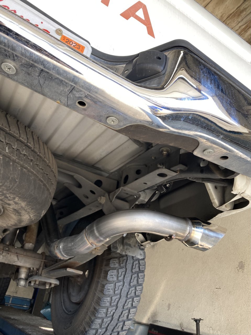

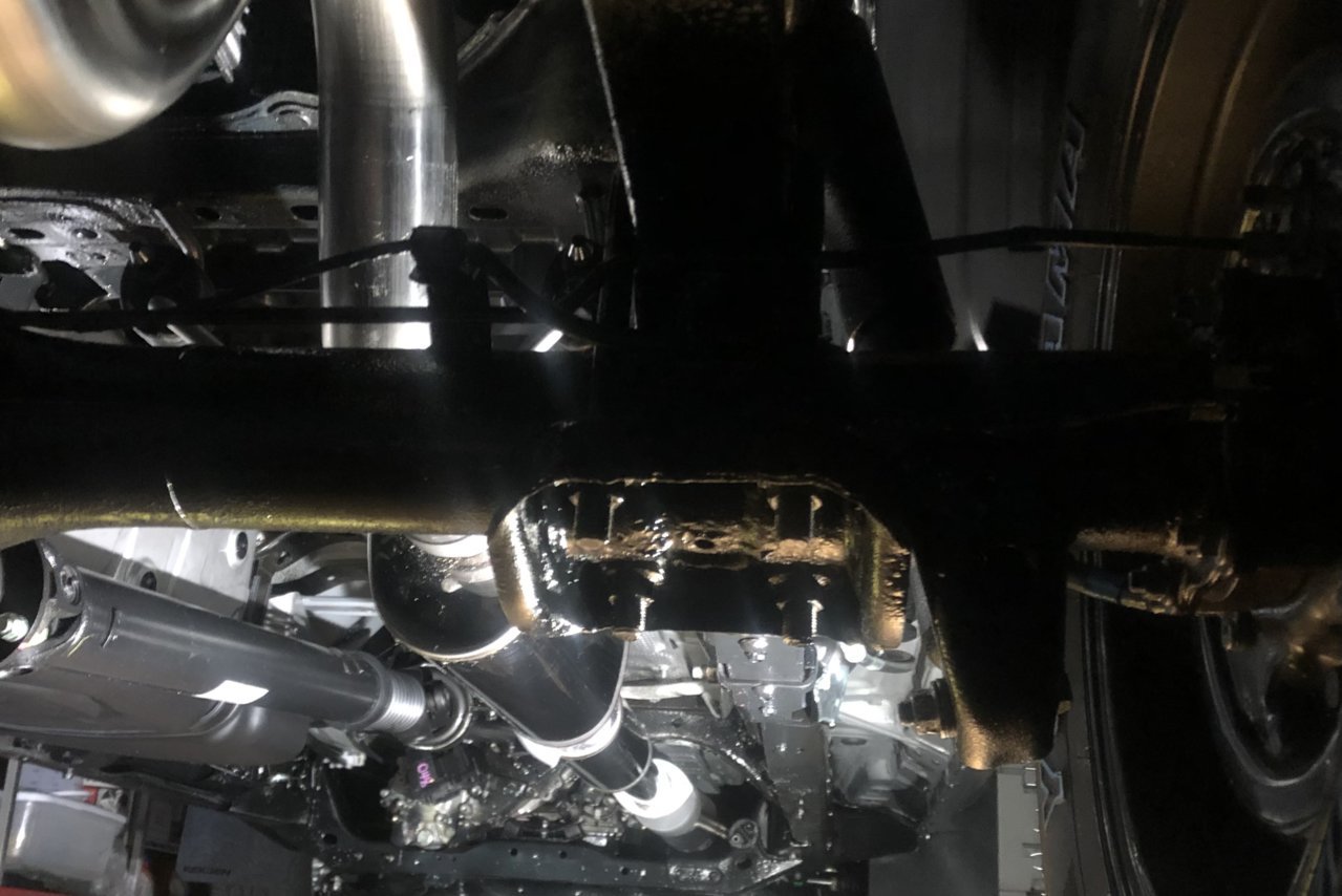

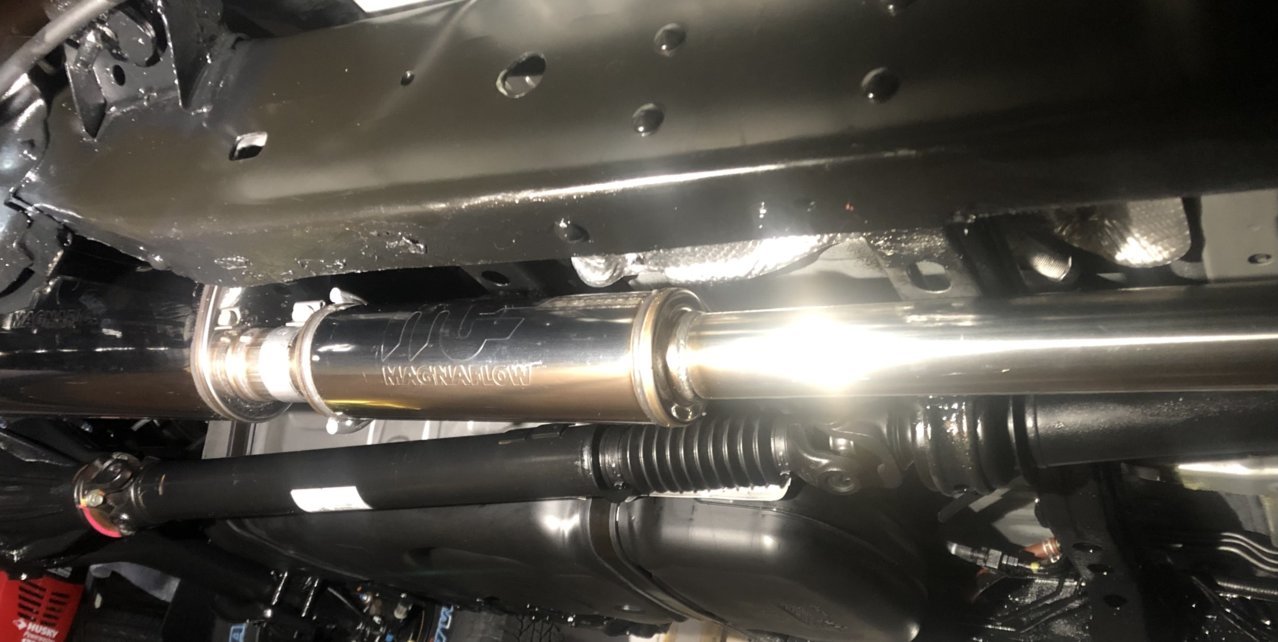

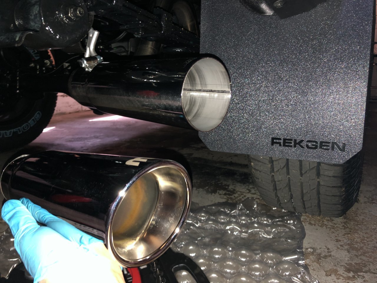

    Magnaflow cat back with header. The resonator helps. Cut off the MF tip and replaced with a straight cut Gibson. Not sure if that changed the sound, but it sounds just right.

    Nice! Do you have any sound clips?

    No sorry, I think the cone shape on the MF projects the sound a bit more. It’s quiet cruising and at idle. Getting up to speed is deep and rumbley but not rice burner

    Holy hell you could eat off that undercarriage.
    Got a link to the one you used?

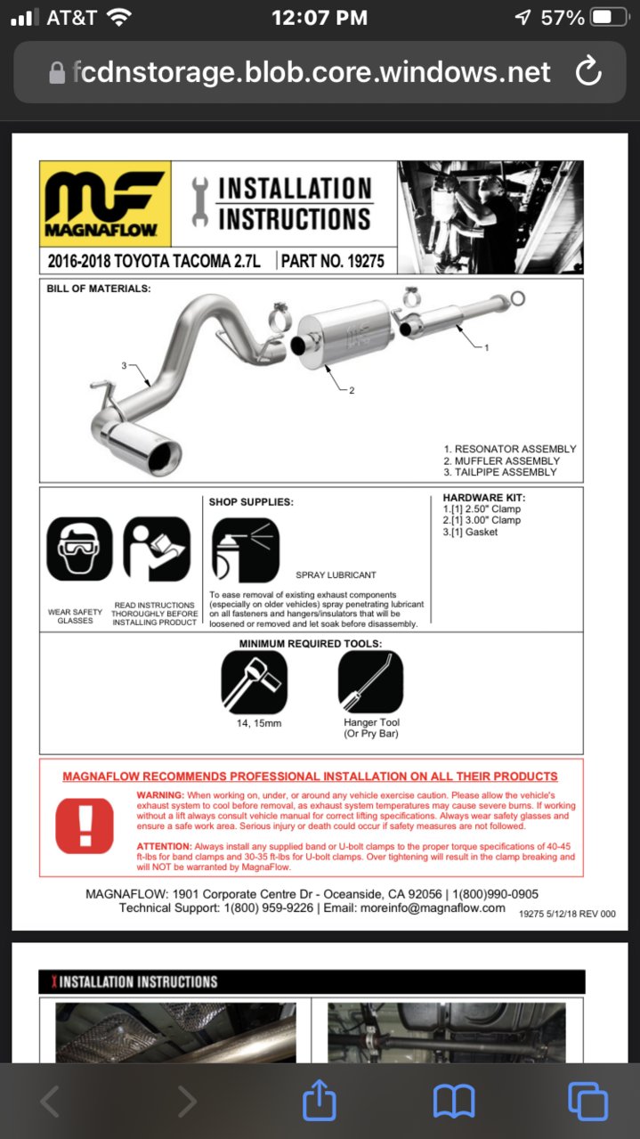

    It was this one. I don’t have the link. If you catch it on sale, it’s less than $500.

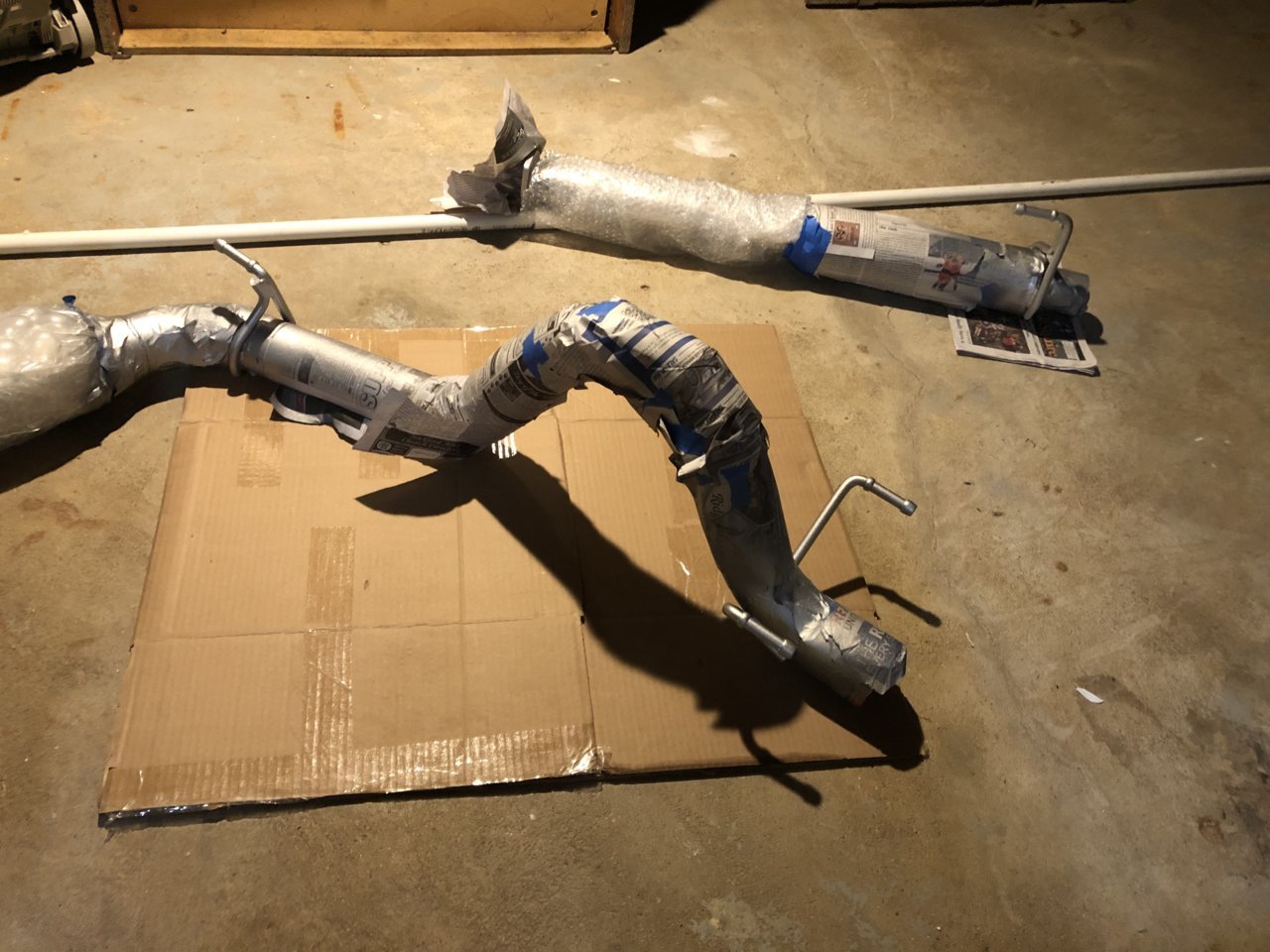

    I will get under the truck with soap and water and clean everything.. and wax every nut and bolt. There’s Probably 10 coats of sealant or Carnauba on the frame.
    Used a zinc based high temp primer on the hangers.

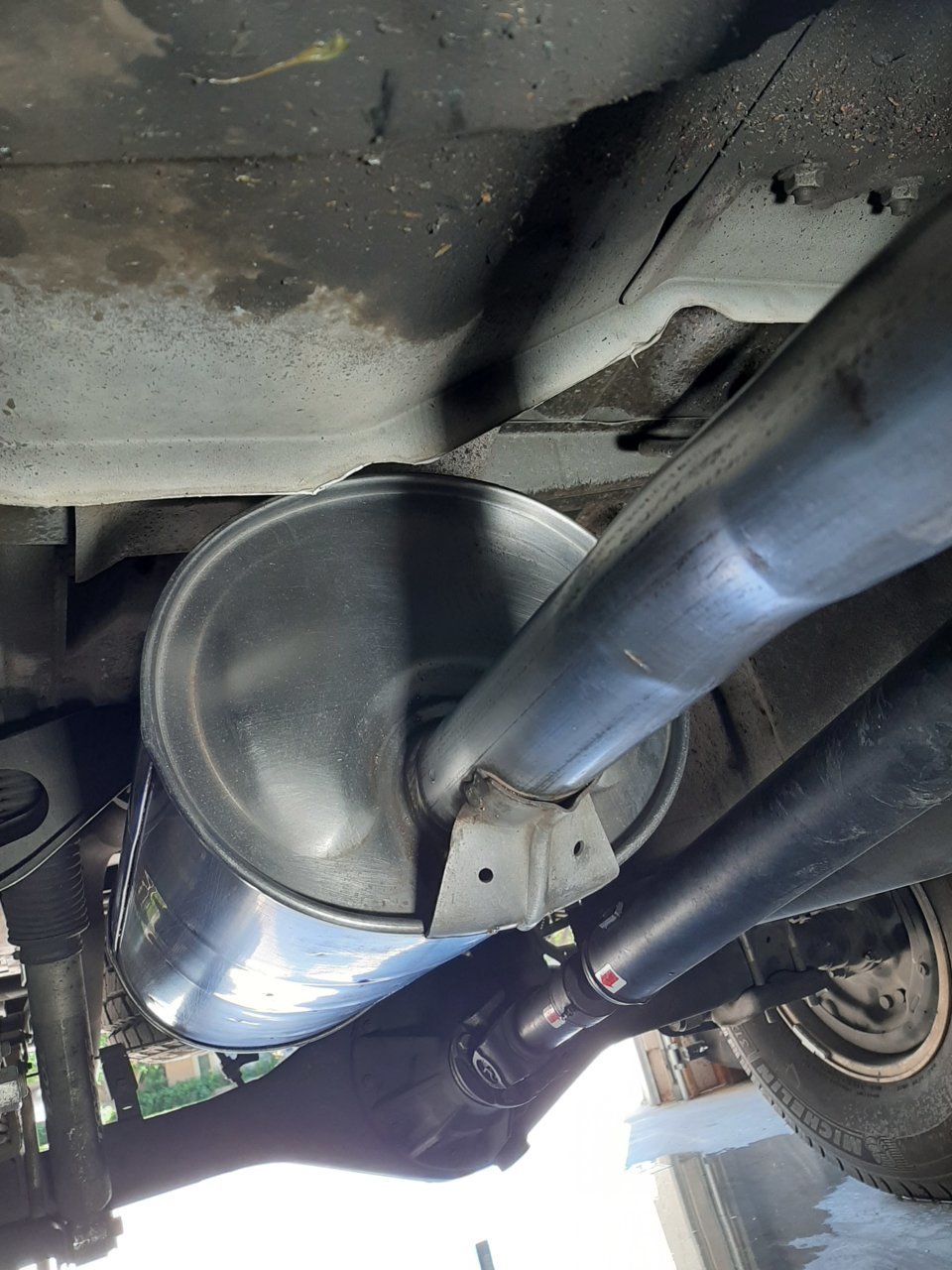

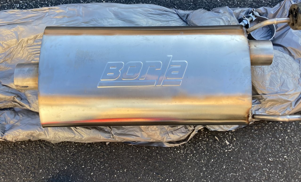

    I’m running this one. Easy install but if have an extended cab, you will need to modify it slightly. IMG_7524.jpgIMG_7529.jpg
