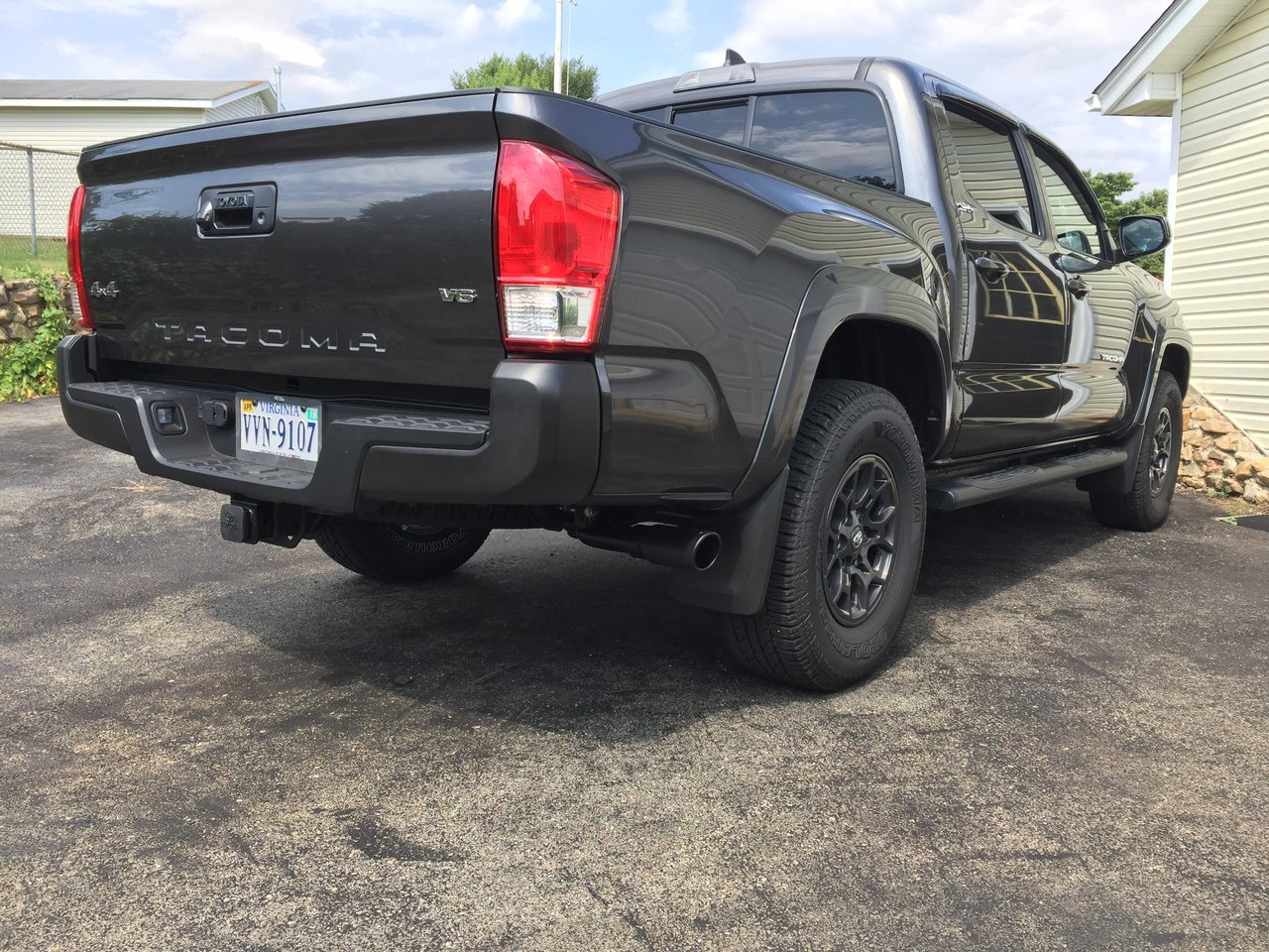

    IMG_2034.jpg IMG_2035.jpg I'm very happy with the results...

    I'm not on a quest for a total blackout or anything, but that was a big chunk of chrome...

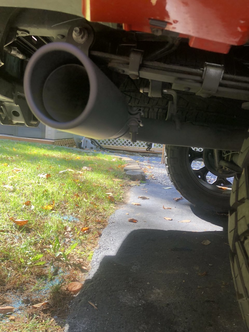

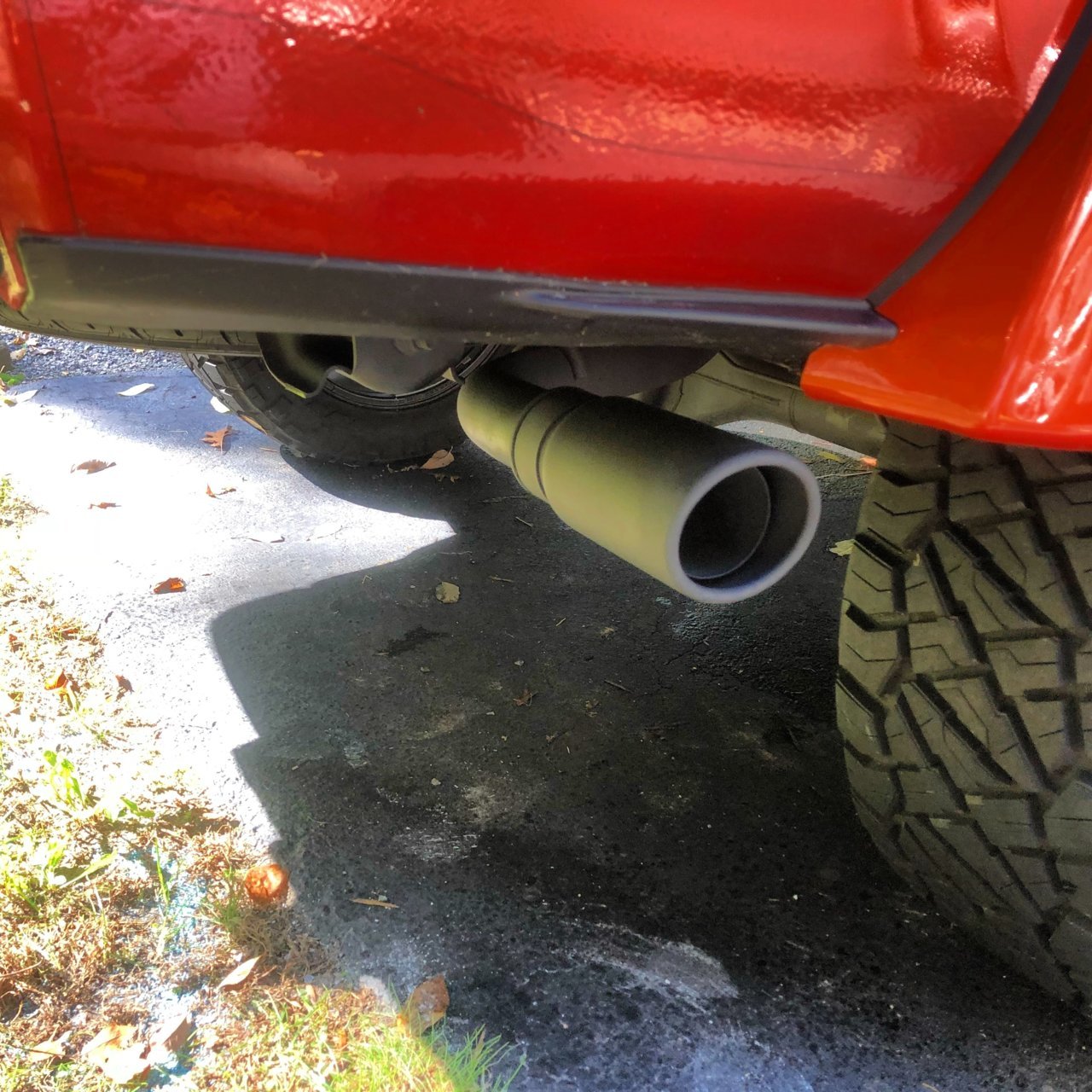

    Started this project tonight...alas the rain, darkness and shear fusion of the tip to the pipe got the better of me...will give it a better go tomorrow.

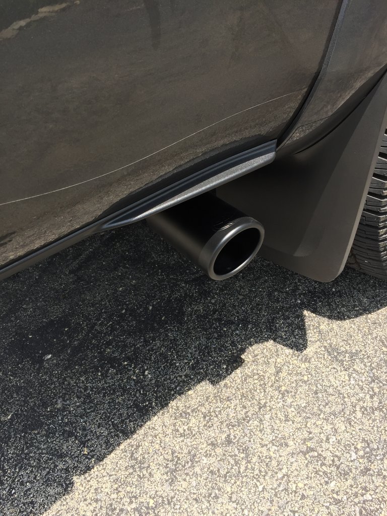

    Done and done064E67F8-578B-4F90-8212-7643360BC5B7.jpg E870E15D-095D-4BA6-9E37-0901BB70AA9C.jpg

    The paint looks fantastic...will see how it holds to tire kickback as time passes...as far as your bumper chrome I think your better off using plasti dip

    Wd40 large flat head screwdriver and a hammer...lots of patience. After painting mine went on hella quick. You just need to see how it’s held on with the split bracket on the back end of the exhaust tip...then it’s easy peasy.

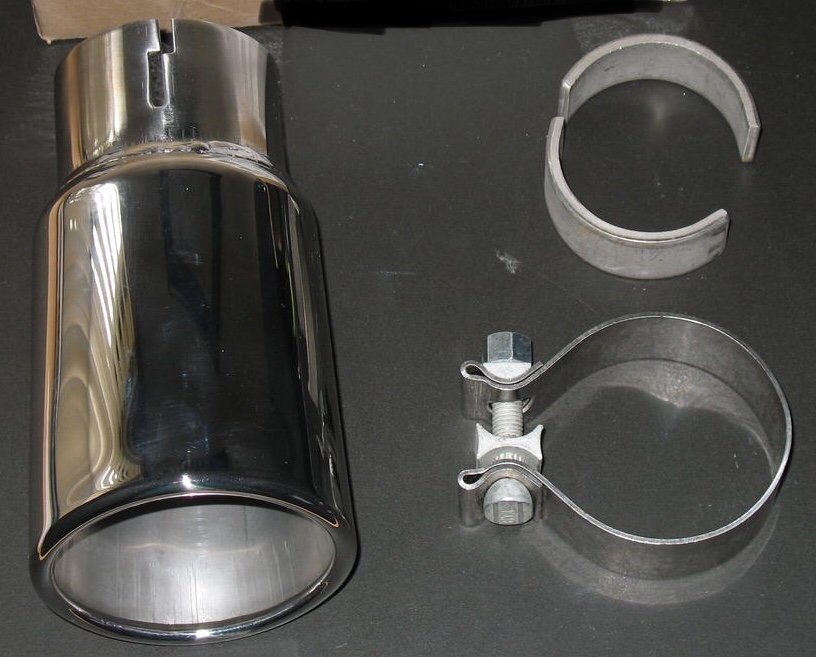

    I think the biggest issue is to separate the “fingers” under the clamp somewhat. They are originally spread to fit over the enlarged tailpipe and then compressed a bit by the clamp on the two crescent spacers. If you don’t re-spread them a bit, they will drag until they come off the crescents and then continue to drag along the entire expanded portion of the tailpipe.
    A picture is worth a thousand words...
