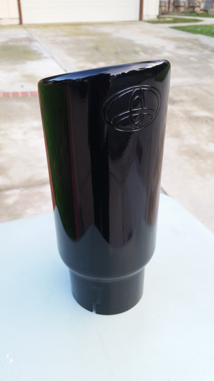

    Just sand it with 180 grit sandpaper.
    And paint with engine enamel.

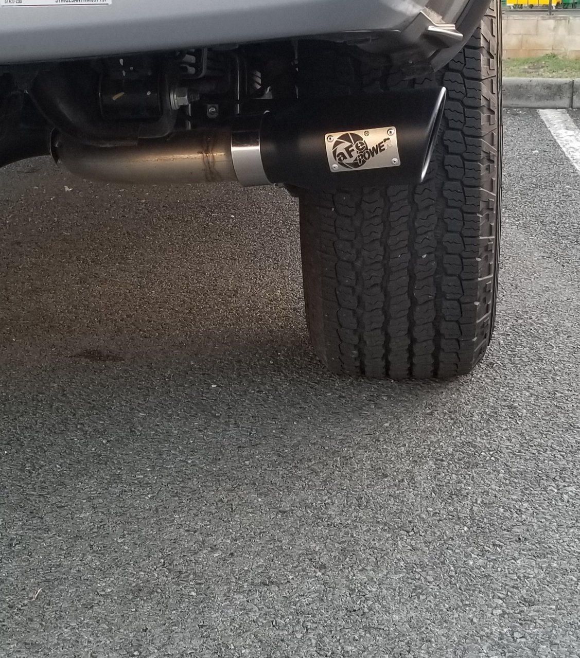

    I got the AFE one. Kind of pricey though. This one is 9" in length with 3" opening, so you have to get an adapter . I also had to cut around 5 inches from the pipe and re-weld it so it wouldn't stick out too much. Cant say about durability yet, only had it for two months. Thinking about angling it down a little bit but not ready to cut and weld again yet.AFE exhaust tip.jpg
