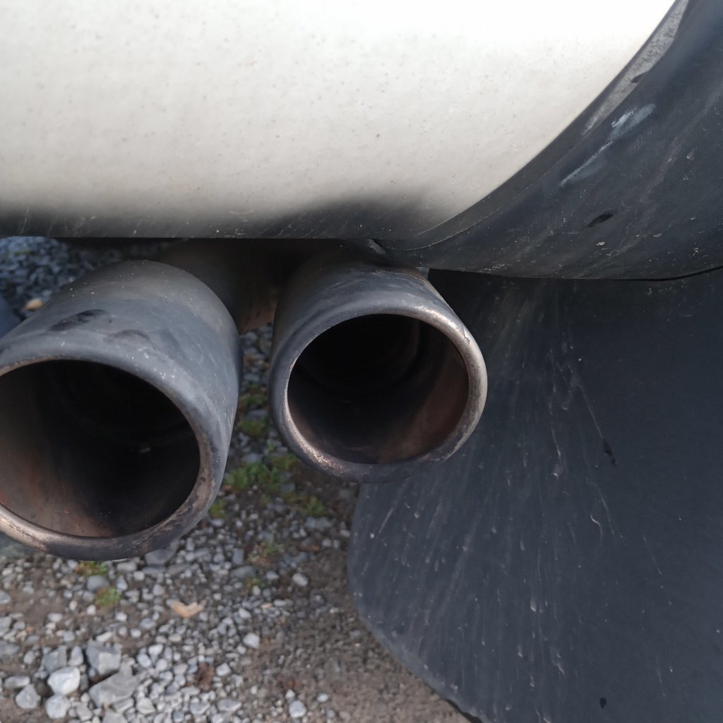

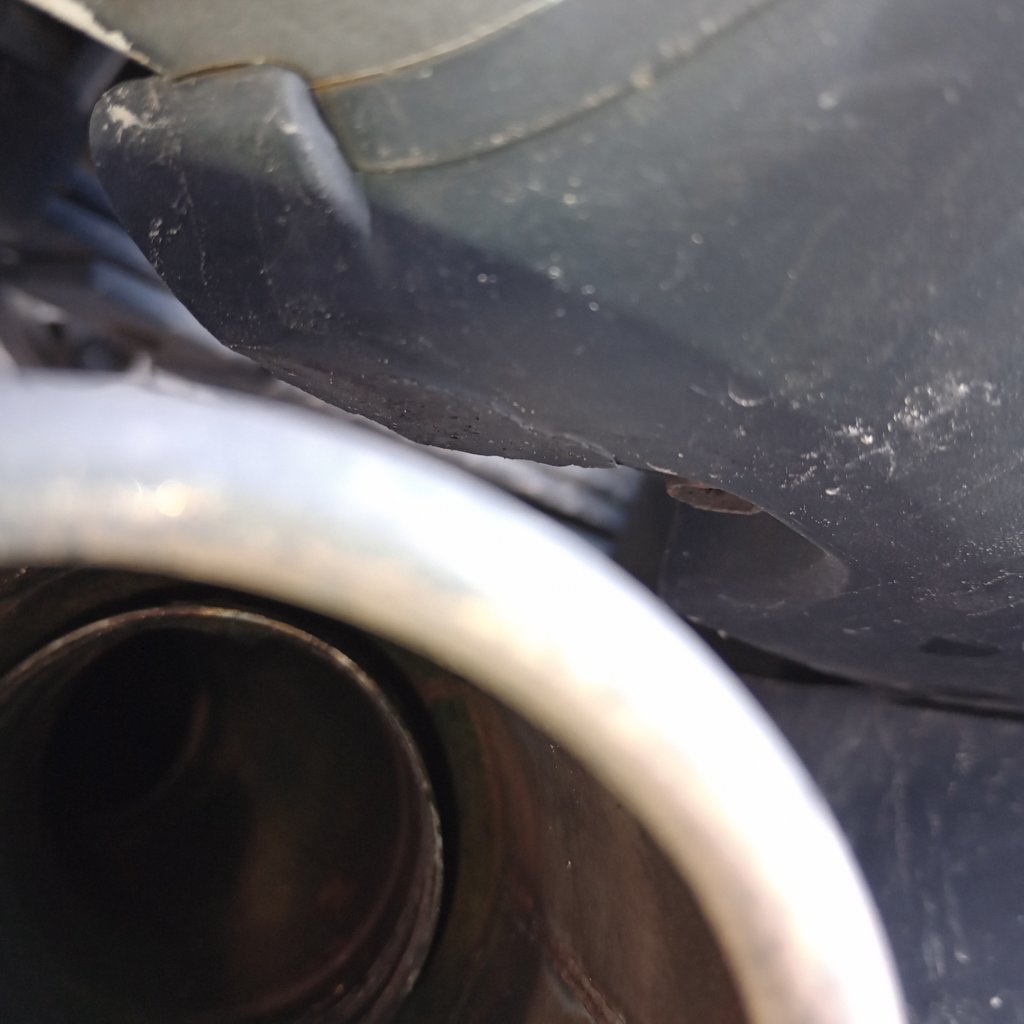

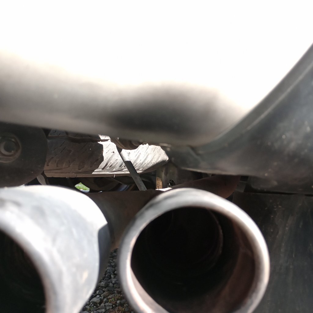

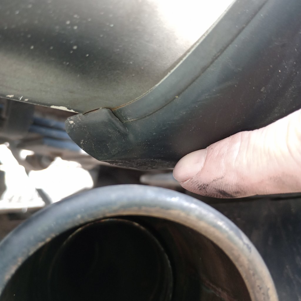

    Went on another quick trip today and came back and noticed the exhaust tips was ON the plastic fender part (Picture #1) and I pulled it down to take the rest of the pics. I got up under the truck and looked at the hangers. All of the rubber bushings attached to the hangers looked okay. Maybe one or two looked like micro cracking on it.

    That's an aftermarket tip on there. Check how they attached it, you might be able to loosen it up and re-adjust it. Maybe stick a crowbar in the pipe and bend it a little.

  12. Apr 11, 2025 at 6:57 PM
    Chapman1991
    Chapman1991 [OP] Well-Known Member
    Mar 22, 2025
    #468201
    57
    Mathew
    Cullman Alabama
    2010 Toyota Tacoma PreRunner V6
    None
    Alright I will look at it again in the morning. I have a few options I can try if that doesn't work. But I'm thinking either bend the tips as you mentioned or bend the actual hanger down closest to the exhaust tips. If that doesn't work I'll work on plan "C" lol
