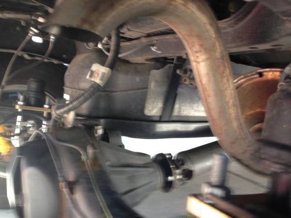

    I’ve been looking for a solution to hide my exhaust from showing/scraping when I’m on the trails. I have a high lift rear bumper which clears everything BUT my exhaust out of the way. Any suggestions?

    the tail pipe? you could just cut it before the axle and leave it

    Lots of people cut it off right after the axle

    Axle dump..
    Excuse my potato photo

    One more question, what are the cons if I were to cut off?

    Nothing. Send it! :sawzall:

    Cut mine off right after I bought it. No cons yet!

    saying no cons is arguable depending on what you like. here's two: exhaust smell easily comes in the cab esp with rear glass open at low speed, and if you have an aftermarket resonant muffler, then an under-bed tailpipe can resonate under the bed and be really loud in the cab, but not a problem with stock muffler/exhaust.

    I still have my stock muffler/exhaust so it sounds like I’m still in the clear. Other than the smell that’ll possibly make its way inside the cab. Thank you for the heads up!
