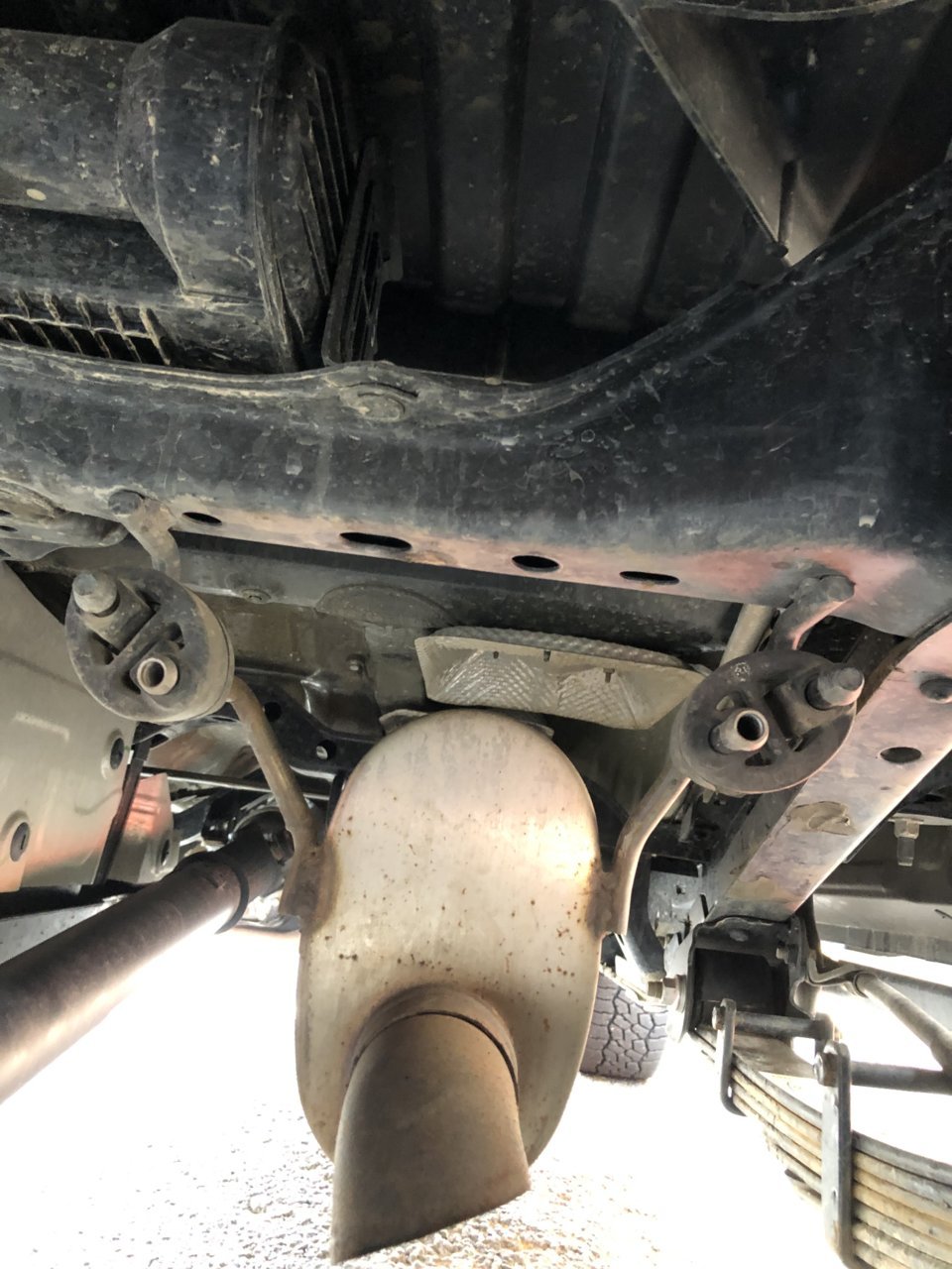

    I went with a 24 inch body I think 3 inch entry and exit. I’ll take a pic when I actually get up for work which is 8am. It’s 5:21am right now and I have no idea why I’m up haha. I cut the hangers off the stock muffler and bent them slightly and welded them to the new muffler that is why I chose the 24 inch body muffler so it’s nice and sturdy.

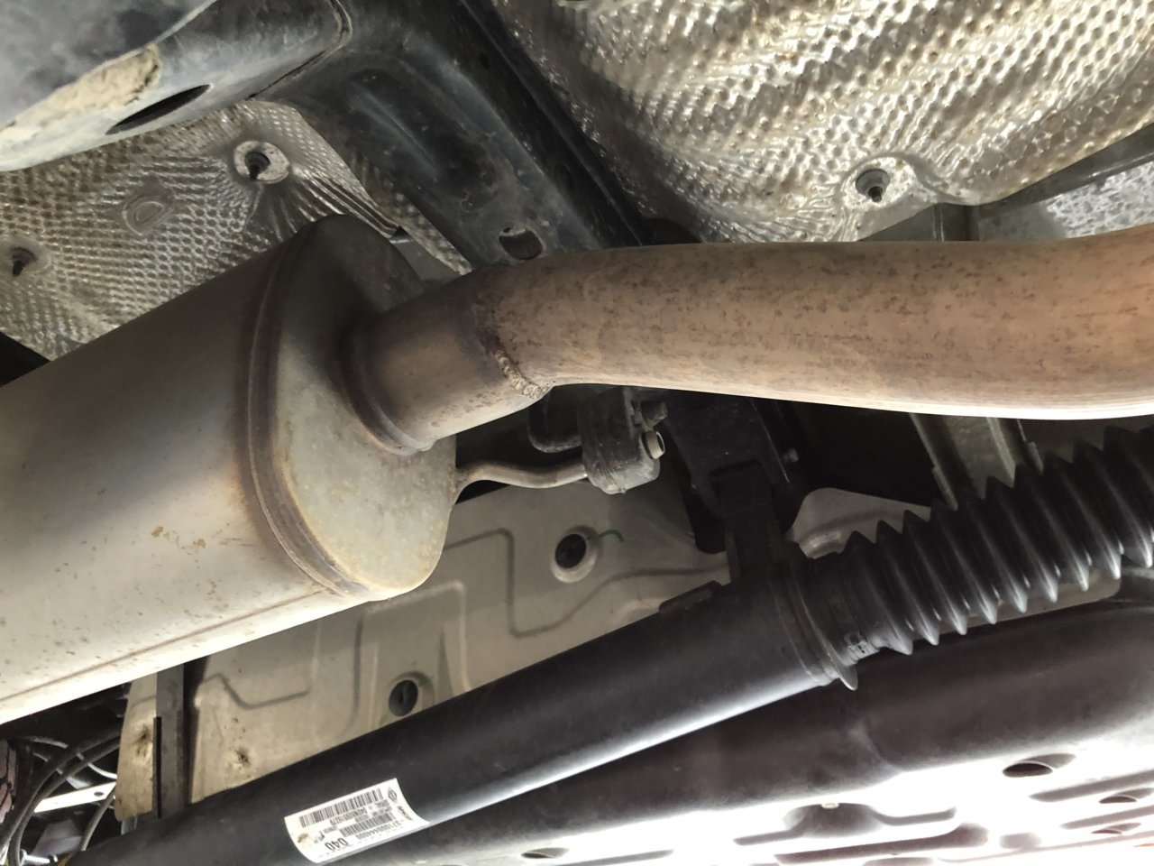

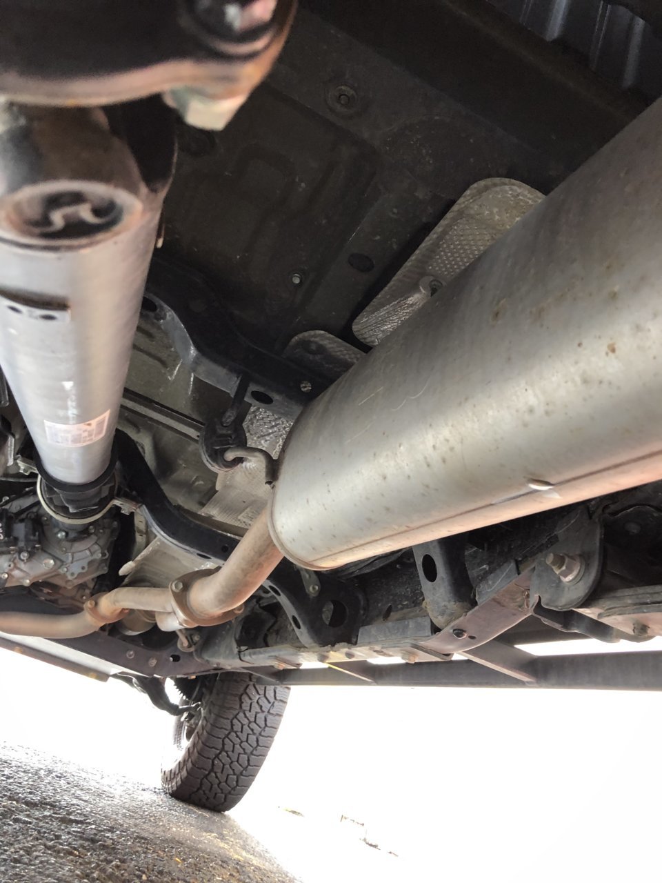

    This is how I did mine. I used the this muffler magnaflow part number 12286. 2.5 inch Inlet and outlet. I didn’t purchase anything else I reused all the factory hangers from the factory muffler.
