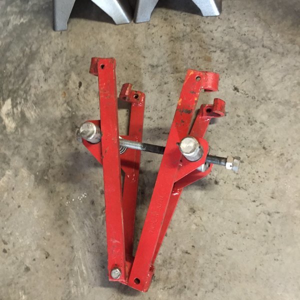

    This is the spring compressor I'm using. At least a little safer than the ones that you have to use a bolt on each side.

    Well just be safe! I'll never mess with one of those.
