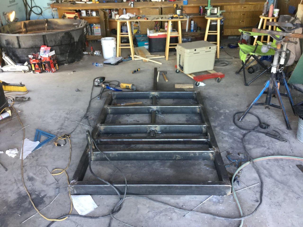

    Ready for half axles-- built box 6ft by 4 ft out of 2x4 by 1/8 tubing axle is 2 1/2 X 1/4 spine is 2 x 1/4. Welded it all out with 5p and ran lo-hy due to vibration-- will trim tongue to length when get lock and roll hitch and axles set so rear tire and trailer tire are 10ft 6in. Now wait for ups and some time to clean up a bit

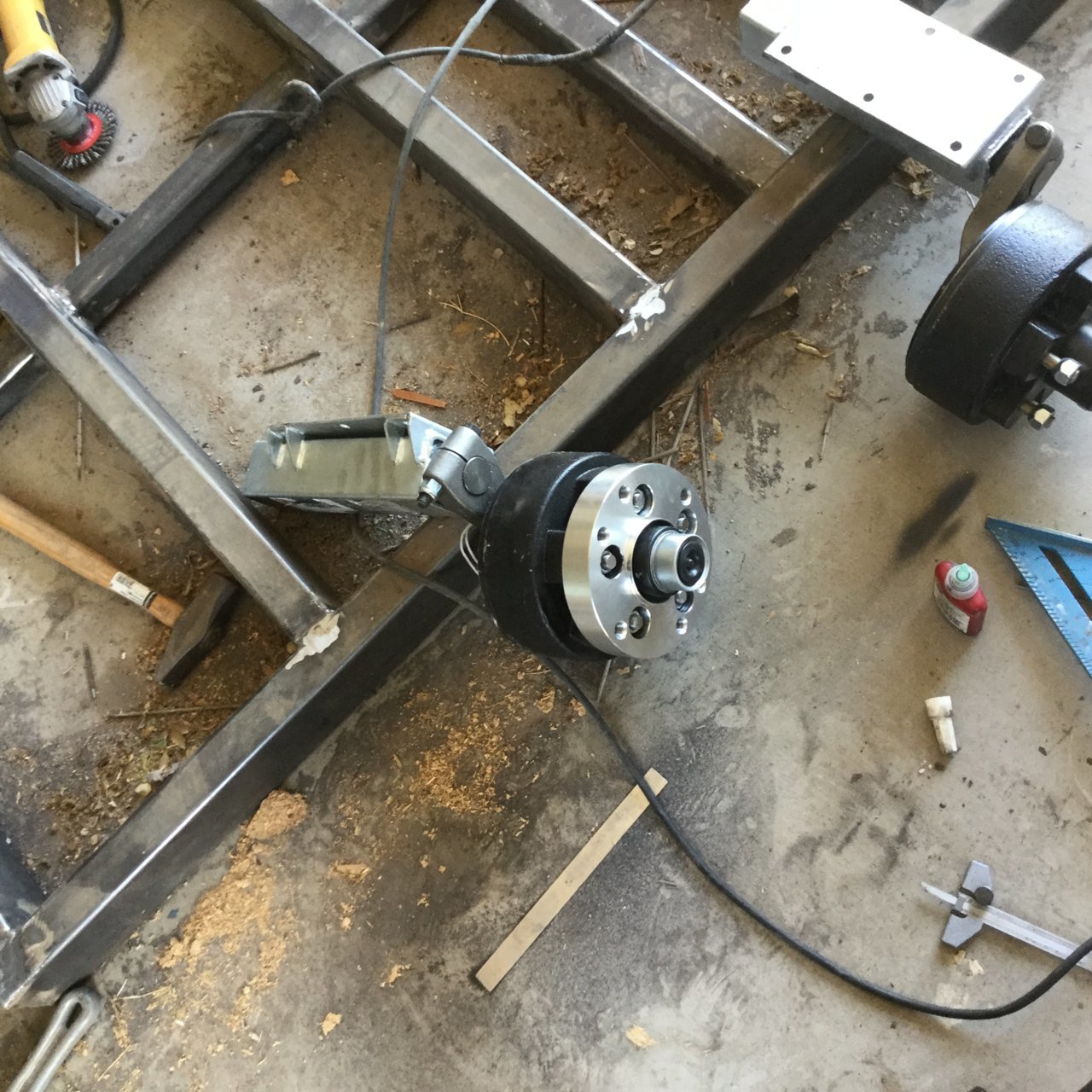

    IMG_0068.jpg Sorry haven't updated in awhile, have had some personal stuff going but got my axles in and spacers still have to take to machine shop and get a ring made and pressed in to make them hubcentric so can use the OEM rims. I went ahead and put everything together so could measure placement of weld on plates to cross member to get desired clearance. I went with 3 inches am going to bend plate to make wheel wells since I am using off-road tires so don't have to worry about total distance from frame like I would was going with store bought.

    I cross squared weld on plates off of forward center of tongue to front and back holes then welded ends and turned trailer over for last time and welded top. Plates are 3/16 and are matched to 2000 lbs axle halves from factory I welded them to the 1/4 crossmember -- I welded them with 5p and Low hy rods like I did the other frame componentsIMG_0072.jpg

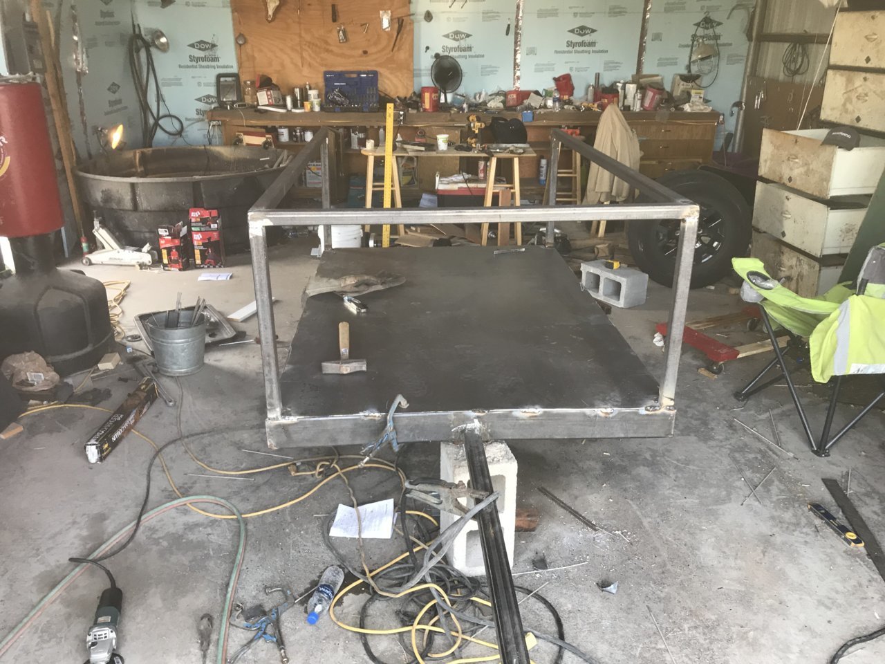

    Got bottom plate welded on today also got sides on— 1/8 inch plate bottom 1/8 x 1 1/2 rails next will be 1/16 side plates 379347EC-8E9A-4C94-9BB0-22953D11512B.jpg

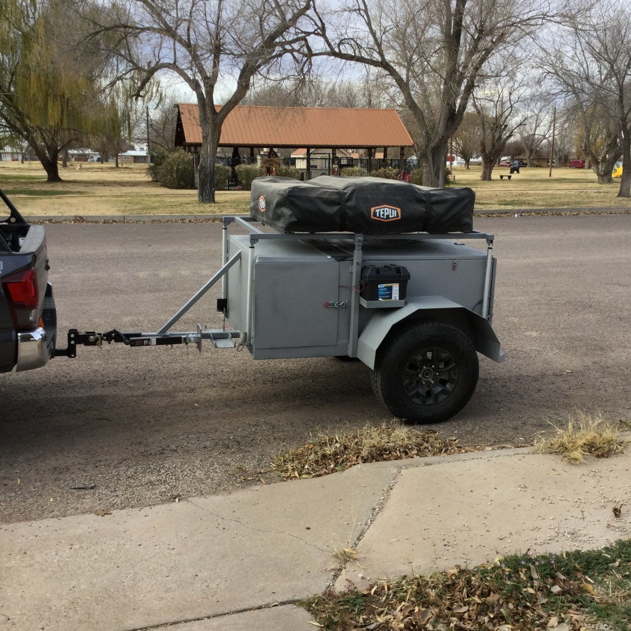

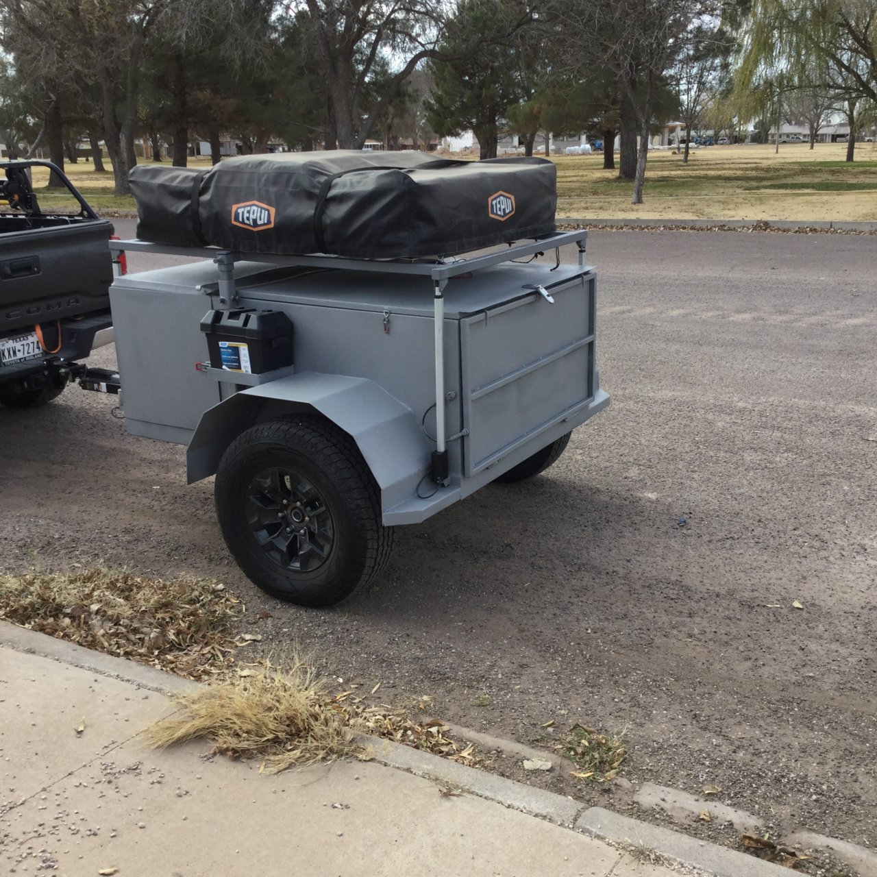

    Didn’t get much posted on last half of build but it is finally able to see the light of day 2BA42060-10C3-4D6B-85C3-8424B499F6E9.jpgD99ADBBC-FF2D-4043-B7F7-544C1C4796A2.jpg

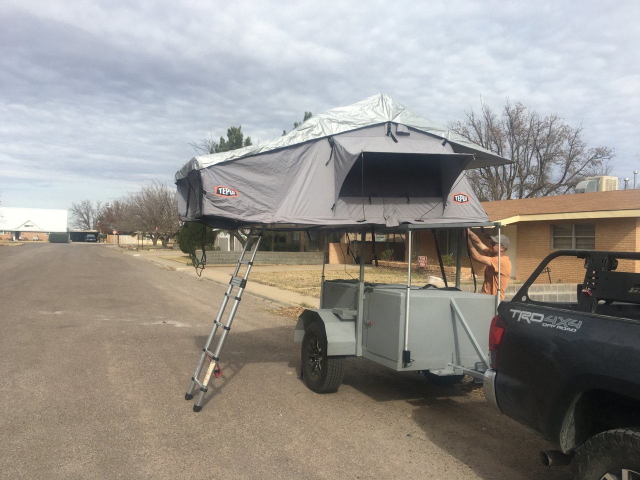

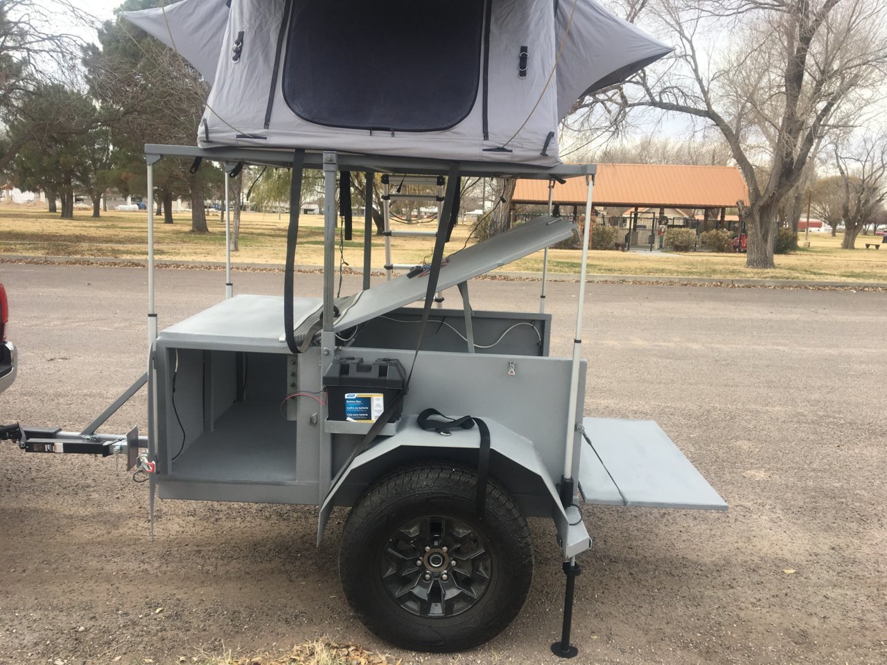

    Was also the first time to try out tent lift with tent open— amazingly enough it worked— took a few adjustments to make work smoothly— used firgelli automatons 24in 250lb actuators9B112645-DCE2-4139-B8B4-DBEB82A3B62B.jpg

    D0867037-B075-4982-83D5-8A4346970B05.jpg Here it is all opened up— used acid etched primer then shot with dove gray raptor liner

    Went with lock and roll hitch and added propane rack for two bottles — wiill post when get more done any questions just shoot me a pm— thanks
