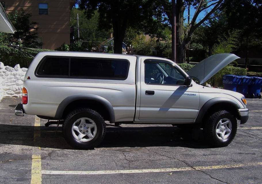

    Has anyone had a Pop Top camper in their rig?
    I have a Camper Shell on right now...
    But have been taking a lot of fishing trips with a few people with all of our gear...3 boats and fly rods. It'd be cool to be able to cook and sleep a couple of people without any trouble.
    I attached the image below..It seems like a good price and is only 3 hours from me.
    Any Pros/Cons? Does the gas milage go to crap? Are they hard to remove?

    That camper looks too big for the truck it is on. It looks like it is hanging off the back about 18+ inches. I would expect to lose 3-6mpg with that setup because of the aerodynamics. Removal depends on if it has outriggers. Some have arms that pull out and a telescoping leg that comes down to support it so you can drive in and out. Others must be lifted on and off each time. Here is a link to a rig I think you would like. Fits most your requirements and you already have the shell. http://www.bajataco.com/bajataco.html

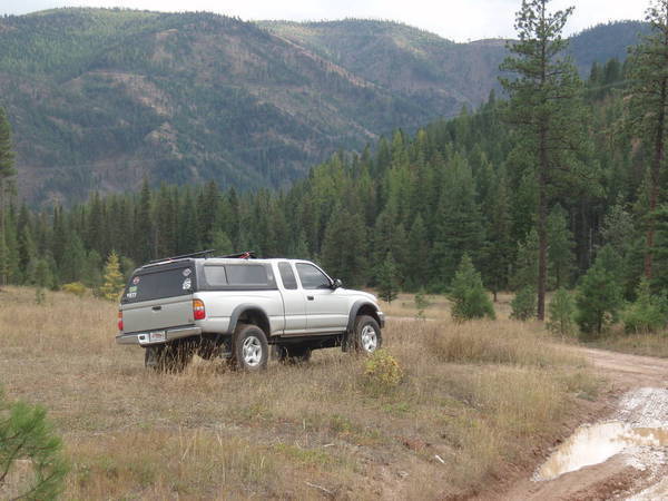

    I do pretty good with 7ft a popup on the back of my doublecab. Gas mileage with camper is about an all around 14 mpg on trips. Around town without the camper isn't much better around 15mpg.
    Iv'e been on some pretty rough trails with it. I run airbags, bilsteins, lifted the front 2 1/2", and have boxed in the frame because the airbag brackets put alot of strees on a small area of the frame.
