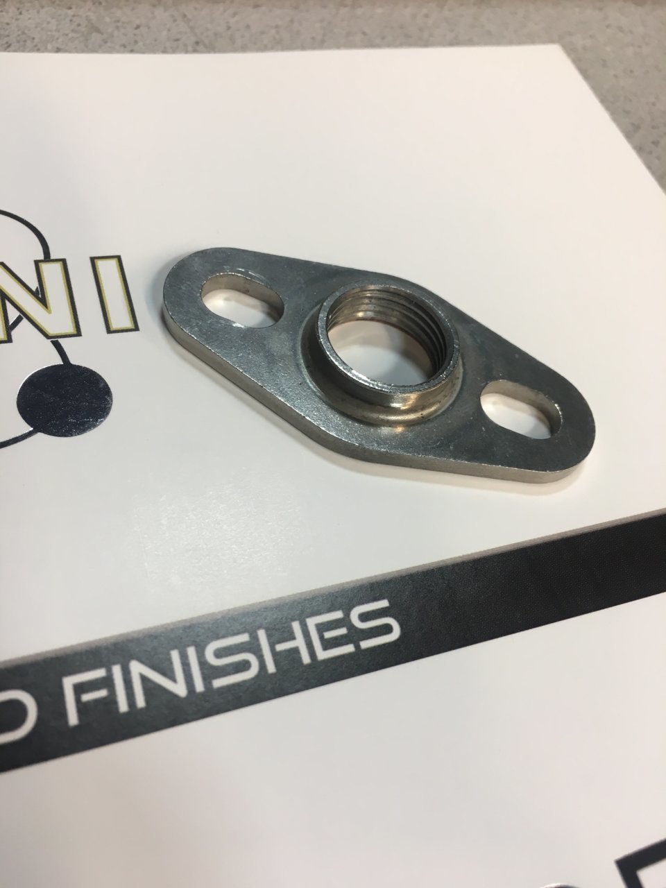

    I ended up just drilling a separate hole for a bung. I learned that my truck has a wideband o2 stock. So it would probably act weird. But IIRC You need to find the pinout for your truck and unpin the o2 wire from the harness and insert the grey wire from the PLX. I don’t know what to do with the heater wires....
    I also have this. If you want it let me know. I’ll give it to you if you pay shipping. It screwes onto the o2 and let’s it install into the factory spot.

    Thanks for that info. I'll definitely take that O2 sensor flange from you. Just PM your PayPal email and I'll send you the money and my address. Mine is a '98 so it uses a narrowband so i'm hoping this will play nice with the ECU. I don't mind putting a new bung in but it will be into an aftermarket header so I don't think I'll be able to drill through 14ga steel with the step bit i have.
