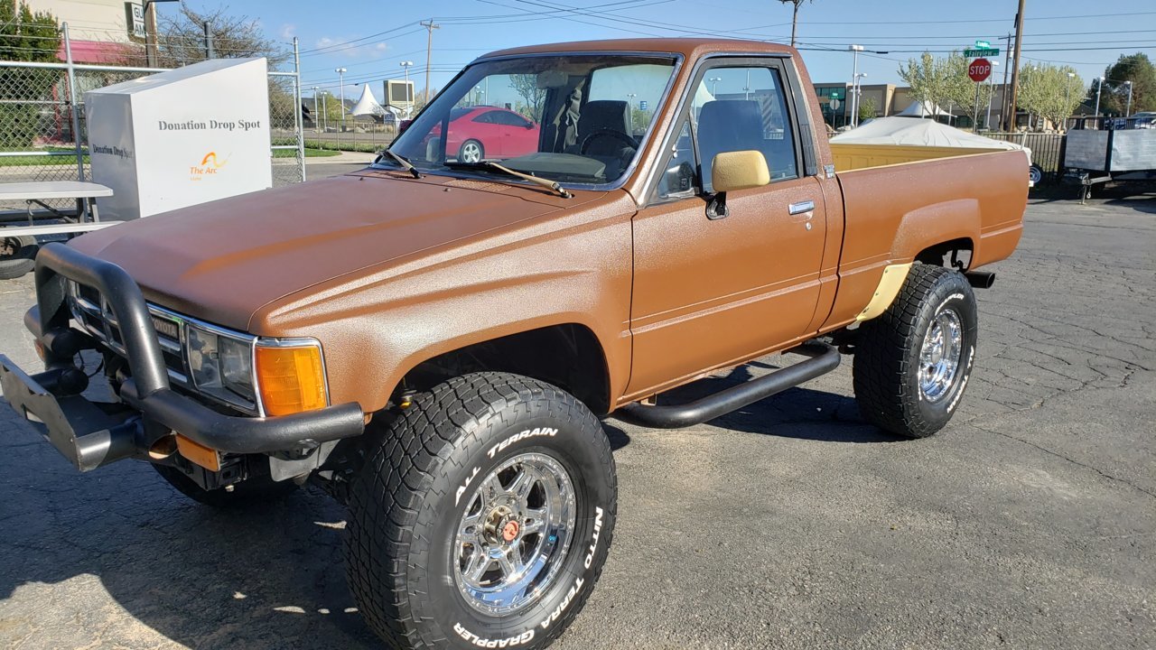

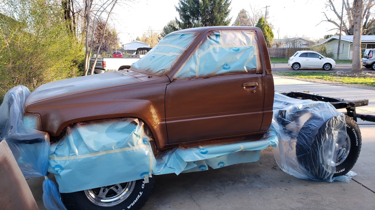

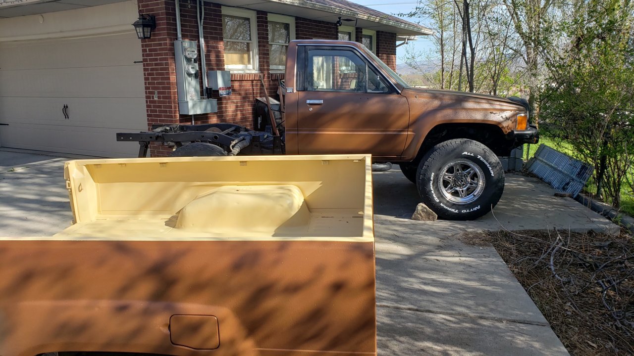

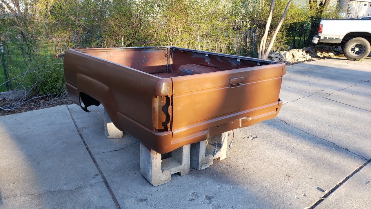

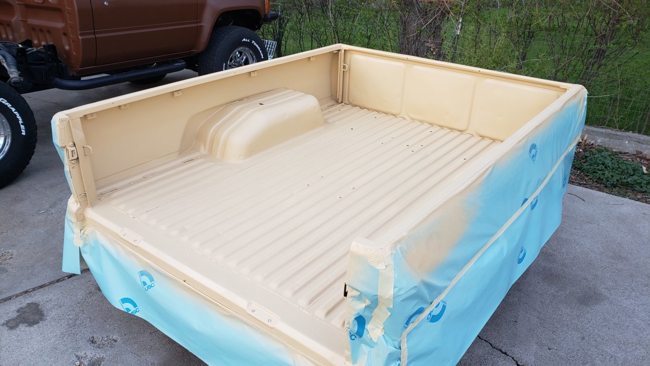

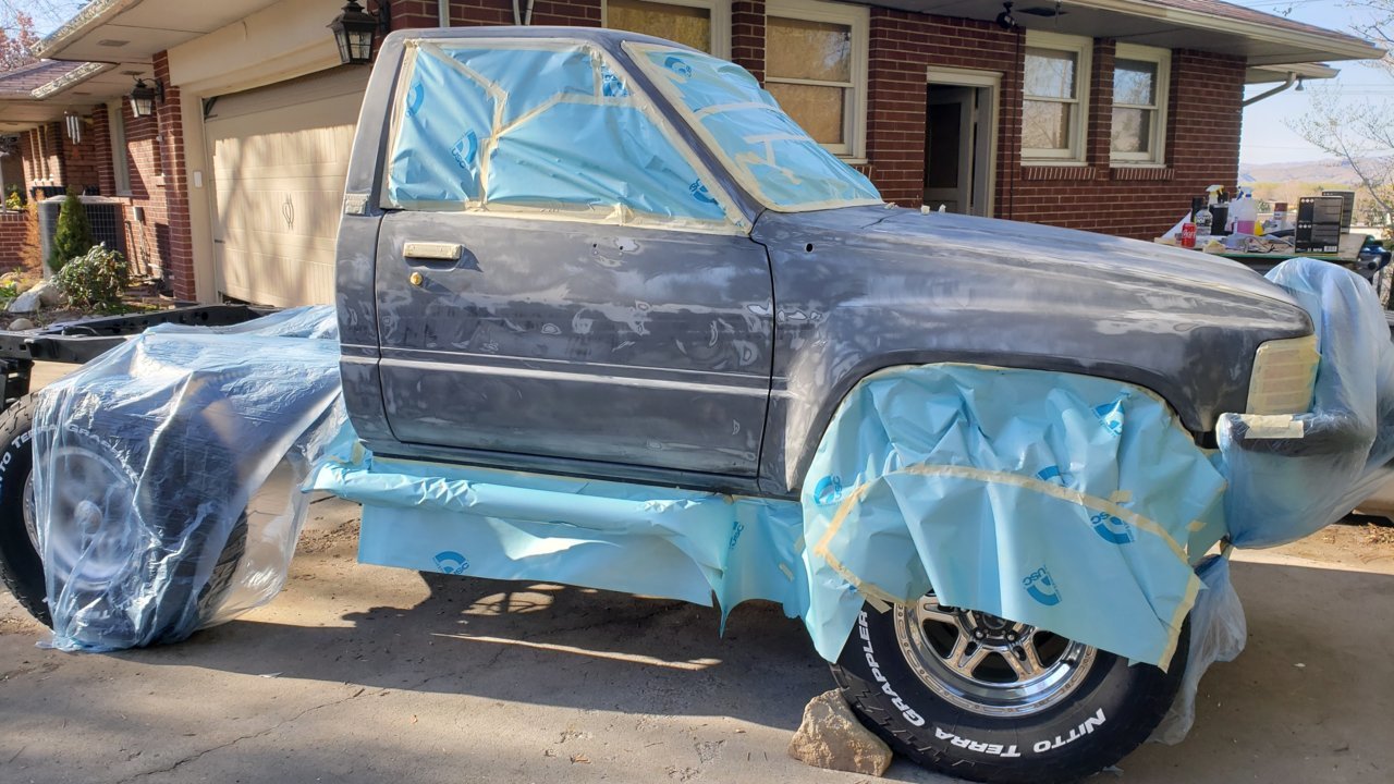

    here’s some you could reach out to and see how they’re holding up
