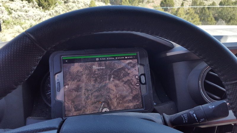

    on a little tangent, I assume you are mounting the tablet so you can map your off road trails seeing as the built in GPS doesn't have that capability? What app are you using on the tablet? I'm using mytrails which allows me to download offline maps, works well but awkward to download all the map tiles. Just curious of your experience... Oh to be able to hack entune and add apps to the head unit.....
    And for those curious as to what all could be mounted on the rail, in addition to cell phone and tablet or gps, if I'm towing a horse trailer, I may want a seperate viewing screen for rear view camera showing traffic behind trailer or showing the horses, so I can see how their doing. I also would like to find a way to mount my hand held ham radio (Baofeng UV-82HP) that I use with mountain rescue so that it isn't flopping around in the cab. I don't want this stuff always visible, it would be too cluttered, but when a tool is in use, I want to be able to securely mount it.

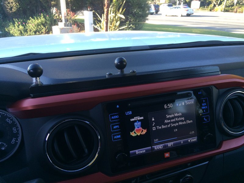

    Finally a shot in daylight. Eventually I plan to round the corners at the ends and paint it black, which should clean up the aesthetics a bit.

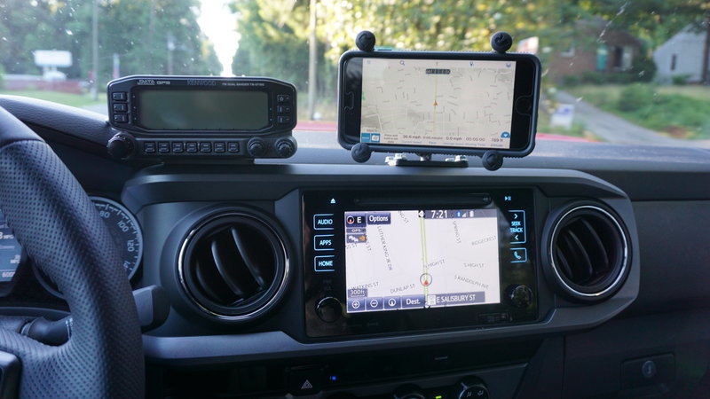

    I needed something to serve the same purposes. I went with a 1.5"X3" rectangular base, and short arm. I popped the radio bezel off and checked for possible interference with the mounting points. Once I decided where it would go, I separated the trim ring then drilled my 4 holes. I torqued down the fasteners then reinstalled the radio bezel. With my IPhone 6s Plus it doesn't move a lot all. I'm very pleased with the outcome.

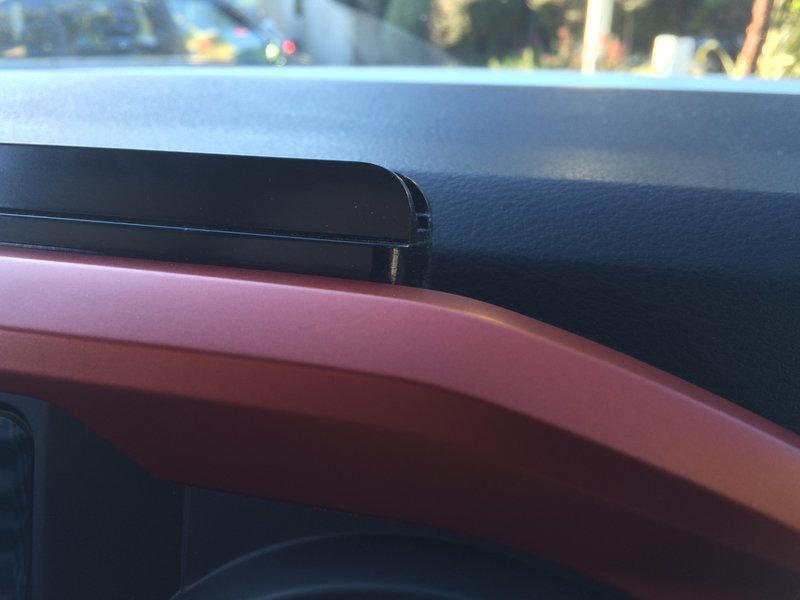

    Here's what it looks like these days. I also took some shots of how I detailed the end. Not glamor shots, the truck is dusty from off-roading last weekend, but you get the idea. Without the ball mounts, it's reasonably subtle and doesn't look like it's out of place.
    I'm very happy with this setup. I have not had the need to move the two ball mounts, but I was able to put them exactly where I wanted, which was the goal of this setup. I also like that I can add and subtract items as the "mission" changes.

    Nice. I'm trying to figure out where I would mount a VHF/UHF mobile unit in my truck and I'm struggling. I don't know how much I'd use it and then I don't know how much I'd have to mess with it (adjusting frequency/squelch etc.) while using it so I don't know if it justifies prime real estate. Currently, I'm thinking about mounting stuff overhead in the area of the sun visor or on the back side of the roof console hump.

    @HalfWayThere the unit I use is a Kenwood TM-d710g, and has GPS built in. For it to work properly, I needed a clear view of the sky
    so, the over head option was a no-go for my setup. I can understand not wanting to take up real-estate if it's not going to get used
    regularly.
