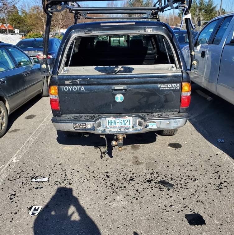

    Hey folks, this afternoon I had the unpleasant surprise of my topper back window exploding while I was in Home Depot. Who’s got the best link for me to find a replacement? I live in Asheville, NC. Do I have to go to a dealership? I don’t see a brand anywhere in the topper. I suspect it’s a Leer, but honestly not sure. Any help is greatly appreciated !

    Probably that rack's poor installation deflecting the topper and bam, broken glass.

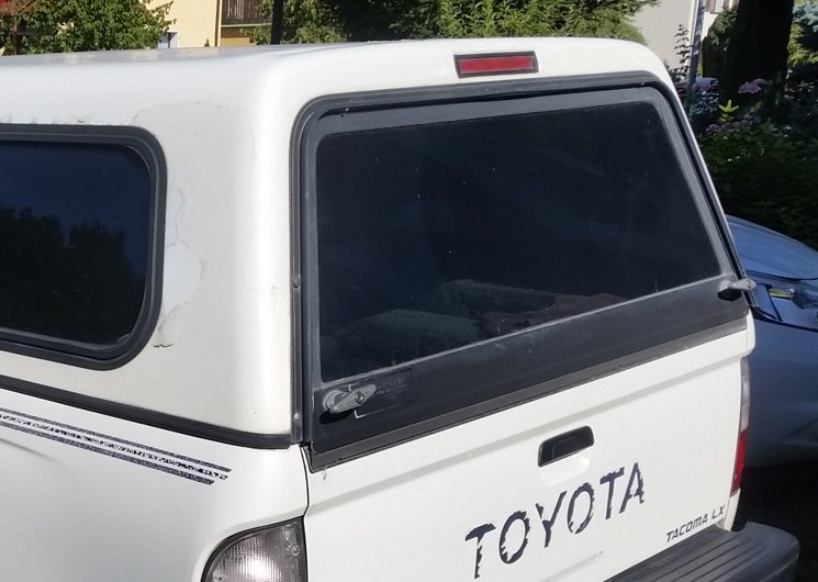

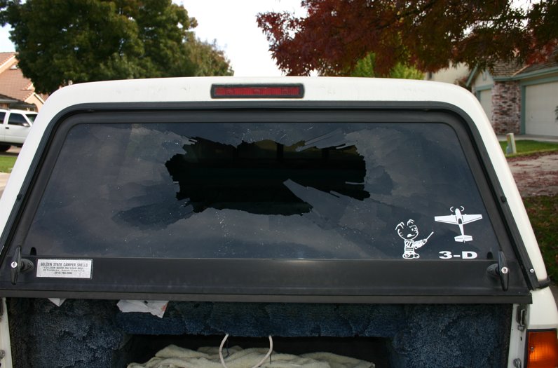

    The back glass on my topper broke in fall 2005 (that is over 16 years ago), as you can see from the picture it was a rock, probably flew from lawn mower at one of my neighbors.
    At first I asked around (including original local supplier of this topper), and I got quoted radicicolous prices - something like over 500 dollars. So I made a cardboard template and went to Tap Plastics. They cut me the shape from tinted lexan for less than 100 dollars, and that fit perfectly.
    Now, 16 years after the rear window looks almost like the day I put it in:
    the rear window has been abused many times, when I loaded long pieces of wood, that was sticking out over the gate and held it down by the window pulled down by bungee cords. Lexan is flexing without cracking. As for scratches the key is not to wash the rear glass with rag or paper. Use microfiber cloth and Plexus plastic cleaner:
