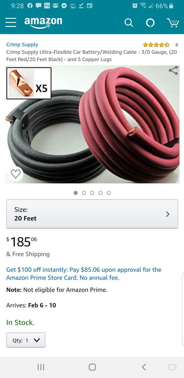

    It's copper and multi-stranded:

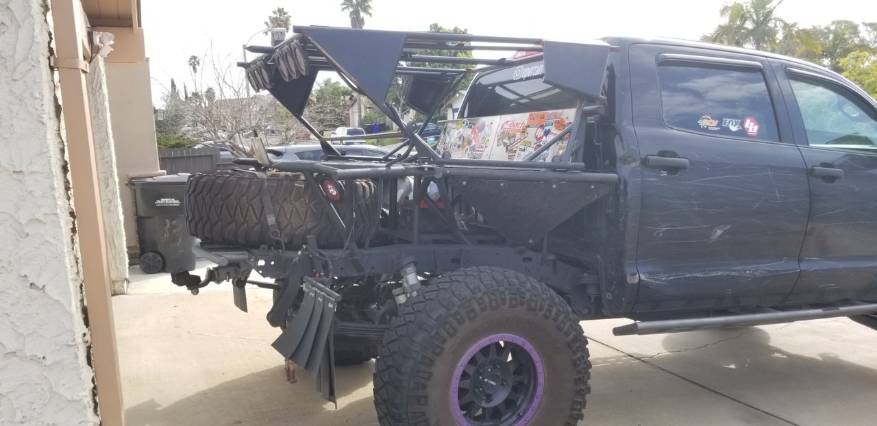

    I'll probably end up with just 25' used overall at most instead of 40. And sure it's a bit more overall weight with the extra wire but it's also spread out more evenly between the two axles whereas the OEM battery is a little forward of the front axle. My new battery location is in front of the rear axle. And it has room for a second battery when I go duals. I'm not worried about bed space because I already shrunk my bed or resale value be cause no one will buy this truck ever; you can see where the battery mounts in the photo below where the Odyssey is.
