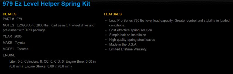

    I know everybody wants to see pictures of the maiden voyage of my set up and they will be posted at some time, but i have a question before my next trip. I have the toytec boss lift kit. boss coilovers up front and the boss leaf pack with boss shocks in the back on my 05 dcsb. I absolutely love how the truck drives, but now that i have a trailer it sags bad to the point where i can fit only about two fingers between the bump stops and my frame and the frame shows signs of wear. I have also felt the back bottom out when hitting bumps. I need to fix this. this is a small expo trailer so not a ton of weight but enough. I know i could get a new leaf pack like the Dakars or allpro expos but i like my leaf springs and how the truck drives on and off road with the boss kit, so i really don't want new leaf springs, and they are still relatively new. I also live at 9k in the rock mountains so reliability and durability are important to me. I am not feeling the airbag set up like a lot will recommend but i have found hellwig helper springs. This looks like the perfect solution, but it seems like no one uses them why? Their are alot of smart people on this forum let me know what you think. Lastly I also have the u bolt flip kit and was wondering if i go this rout will this springs actually work now that i flipped everything. Thanks alot for everyone's input.

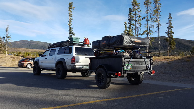

    Pictures as promised.

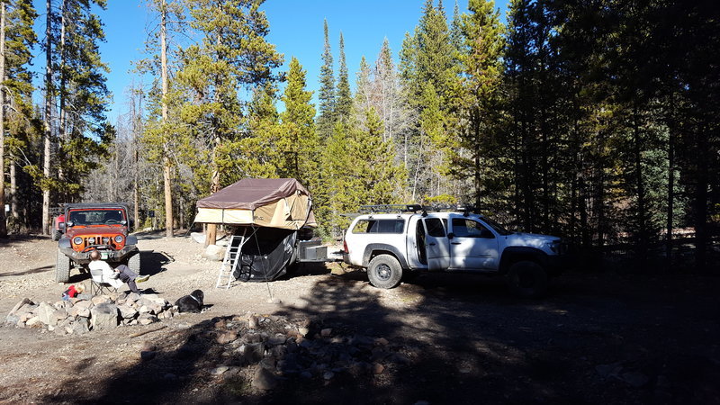

    On the trail

    It sounds like you have a lot of weight on the hitch, but I wouldn't think tongue weight on that trailer would be high. Any chance you have the hitch dropped too low and the trailer tilted forward? I can't tell from the pics.

    I don't think so. when i am on level ground trailer looks to sit level. I have all my water at the very front of the trailer though. would it help to move the water farther back in the trailer? this is my first trailer so i could be loading it wrong but i thought heavy stuff up front.

    dont move the water farther back, you want that water towards the tongue. If its farther back, theres a chance the trailer my start swaying at higher highway speeds.
